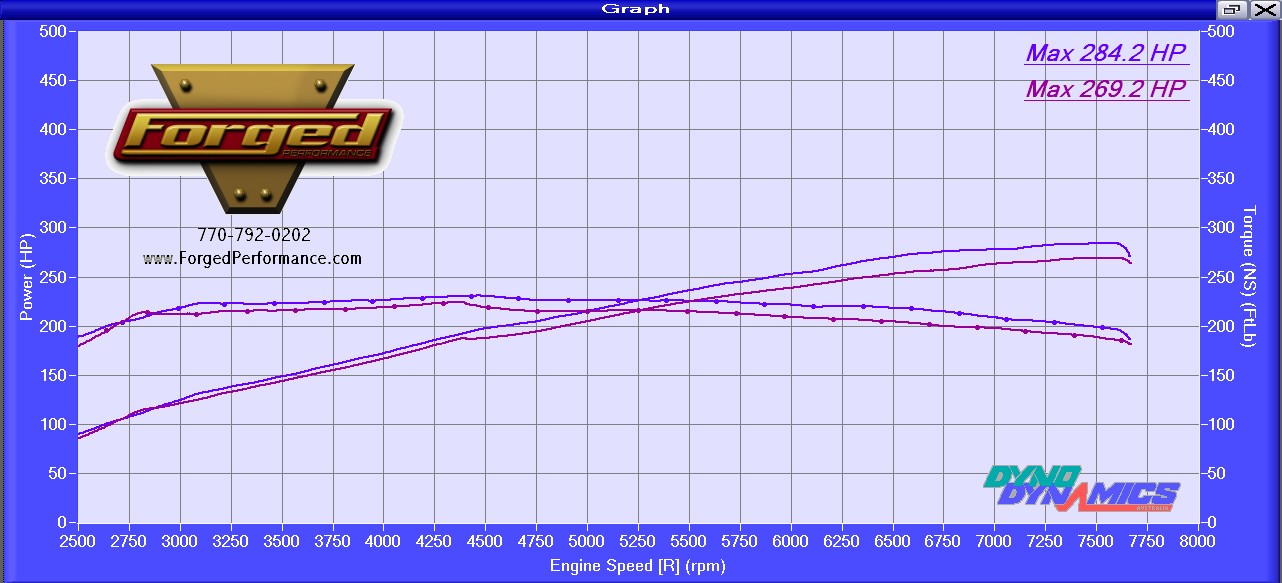

well here you go people, my dyno runs before and after with cobb accessport stage 2 reflash. My car has at time of these dyno runs 14,500 miles on it. Mods are stillen gen 2 intake, headers,hfc, dual exhaust. The wheels and tires are stock, suspension is stock. Testing was done at Forged Performance on a Dyno Dynamics Dyno which usually shows 10% lower reading than a Dynojet dyno. The car posted 241whp stock, 252.6whp with stillen gen 2 CAI and dual exhaust, 269.2whp with addition of headers and HFC. After cobb accessport stage 2 reflash 284.2whp. I plan on data logging the car and having Forged Performance and cobb custom tune car when the software becomes available. Here is last dyno sheet. Enjoy

well the jpeg file is to big to post, so i need to compress it alittle, so give me a minute

ok view attachment folks

from the looks of that graph and what you stated i would say you got some great gains! congrats!!
