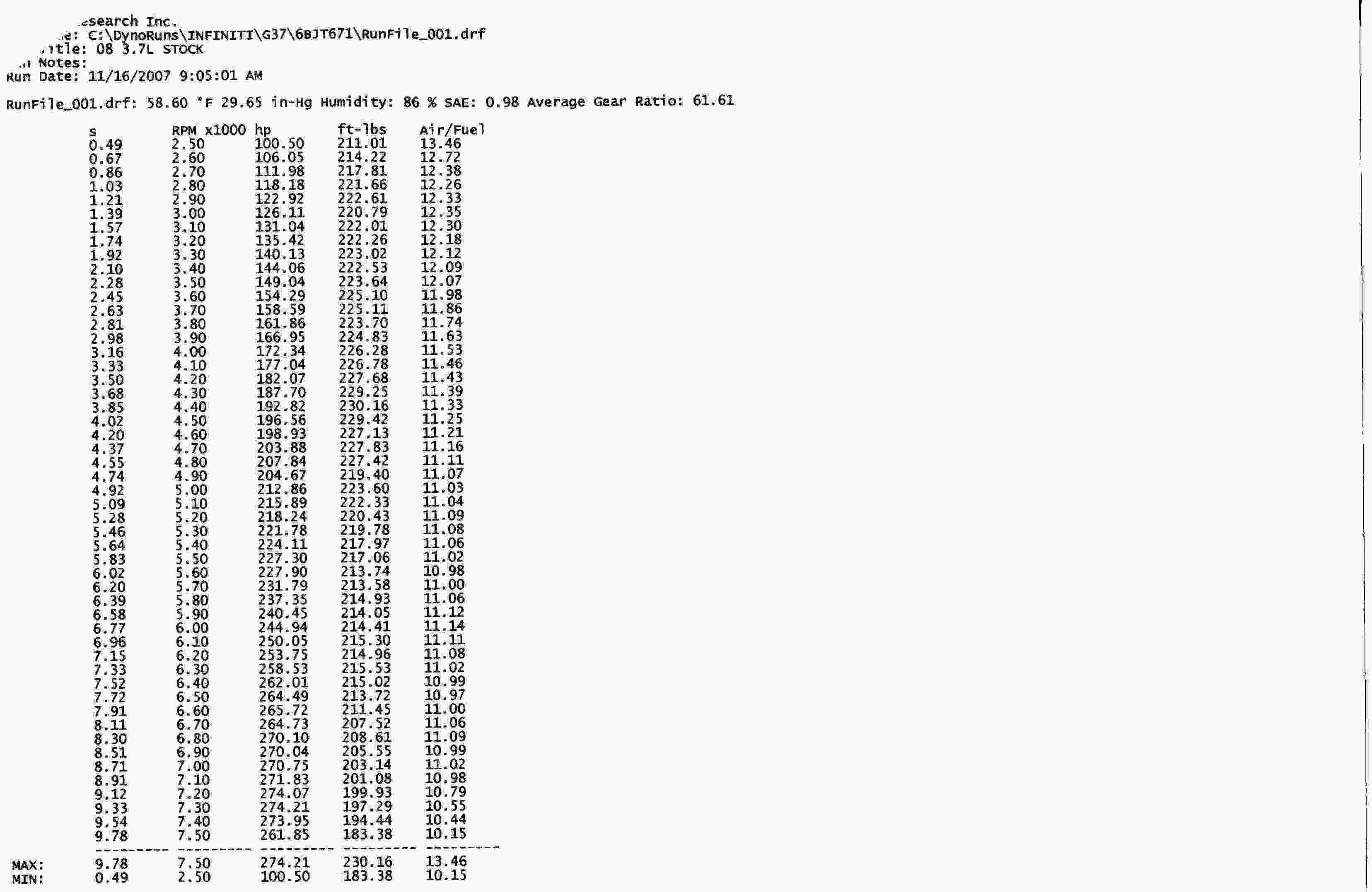

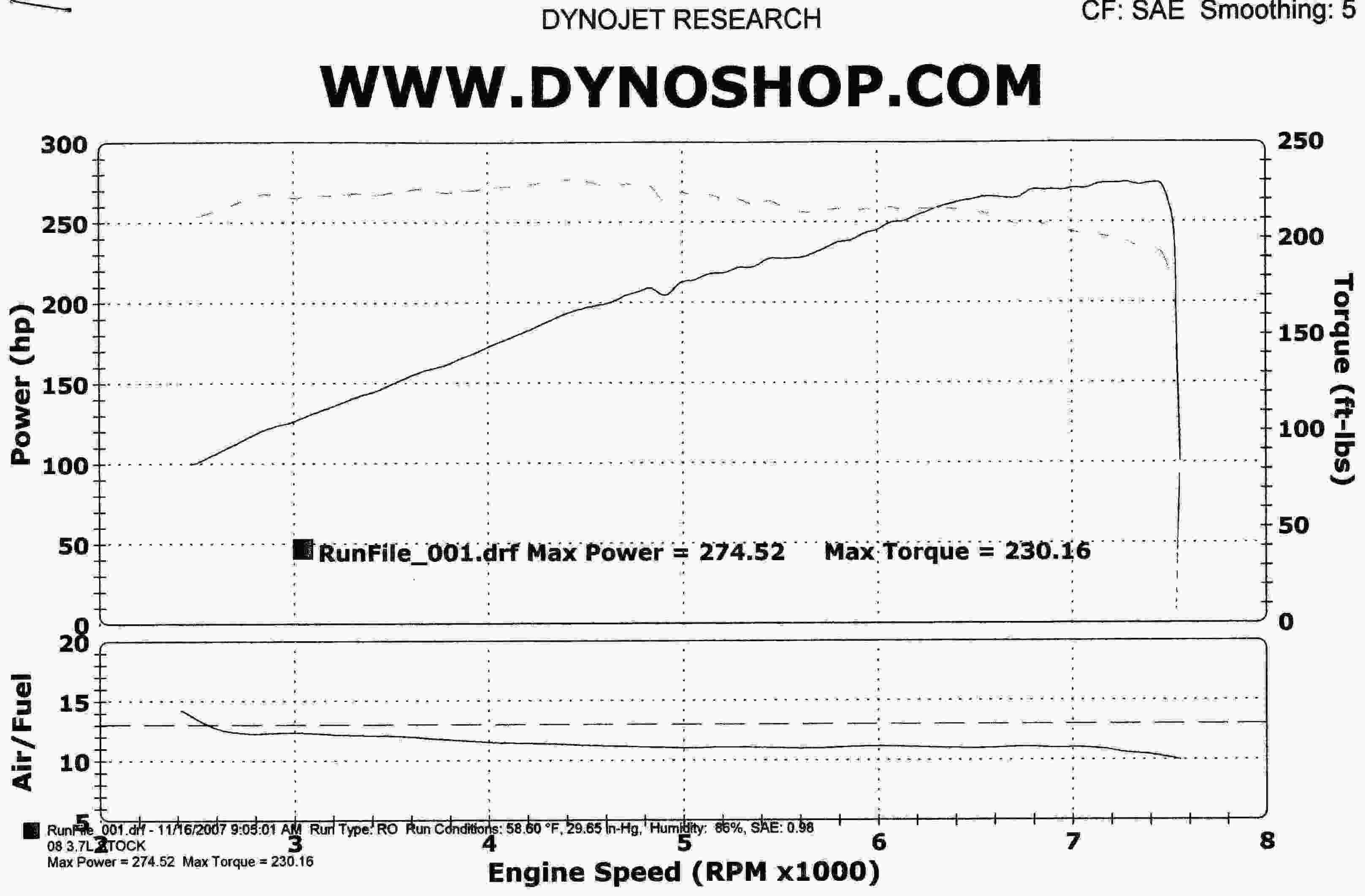

This morning I went to the dyno for a baseline run. It was a 60* morning and the car cooled for half an hour after a 45 min. drive. Two runs on a DynoJet and the best we could come up with were 274 rwhp and 230 rwtq.
I know this will be asked again, but the car is completely STOCK.

nice. you should have gone for more runs...when i used to have my Z i would get the best results by the 3rd and 4th run.
SAE corrected? 5AT or 6MT?
good job. now you have a baseline when you do mods.

stock set up seems to run rich (not uncommon for stock VQs)...i think a little more power to be had if you are able to lean the a/f to 13.0

I believe they are SAE corrected numbers. I figure that it was about a 17% loss on my 6mt.
I would have done more runs, but at $100 for 2 I had enough

The dyno is dead on. Expect 18% from the 6MT and 20% from the 5AT, same as the G35.

Automobile mag did dyno pulls on a g37 and got 287 rwhp. Goes to show the variances in dynos and weather effects on the numbers

AND also differences form car to car...no two cars are the same...

Numbers look right on par with other G37's that have been dynoed. Nice work...now start modding it!
