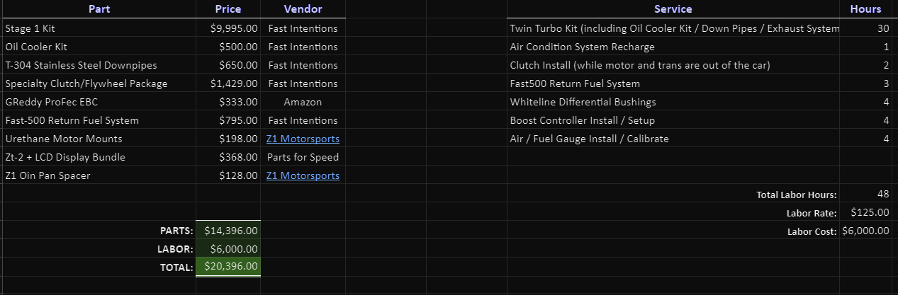

Originally Posted by Broken_2008_G37
Where are you getting 20-25k from. I'd like you to itemize how much each thing would be. So then when you're done we can all say you're full of s**t.
Here you go bud:
(Some prices have changed slightly over time and labor rates are estimated for shops. Hours were obtained from contacting various ones.)
Any more comments you'd like to add?

Whatever FI option you go with, expect to spend a minimum of $15k to do it right. A twin turbo setup will cost closer to $20-$25k.

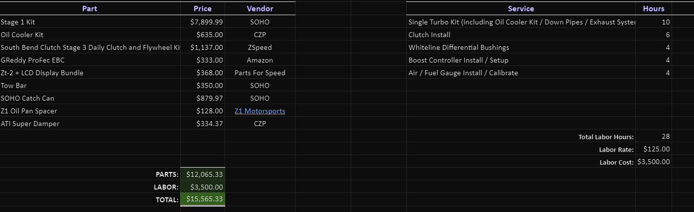

Agree with you @Broken_2008_G37 . SOHO or TopGunz kit are great set-ups. @jpowersjr2 isn't far off with the 15k figure. SC kit is anything from 7-8k, Clutch kit is another grand or two, fuel pump, injectors, tune, bigger wheels and tires, suspension; your costs will add up. 20-25k is in line with a built AT.
The kit themselves aren't as outrageous as they once were now that there's a few more options. Once you add in the cost of the supporting mods he's in the ball park.
Old Mar 31, 2021 | 10:40 AM
jpowersjr2's Avatar
jpowersjr2
Joined: Jun 2014
Posts: 1,296
Likes: 220
From: Brentwood, TN
Here you go bud:
That was a mic-drop moment if ever there was.
