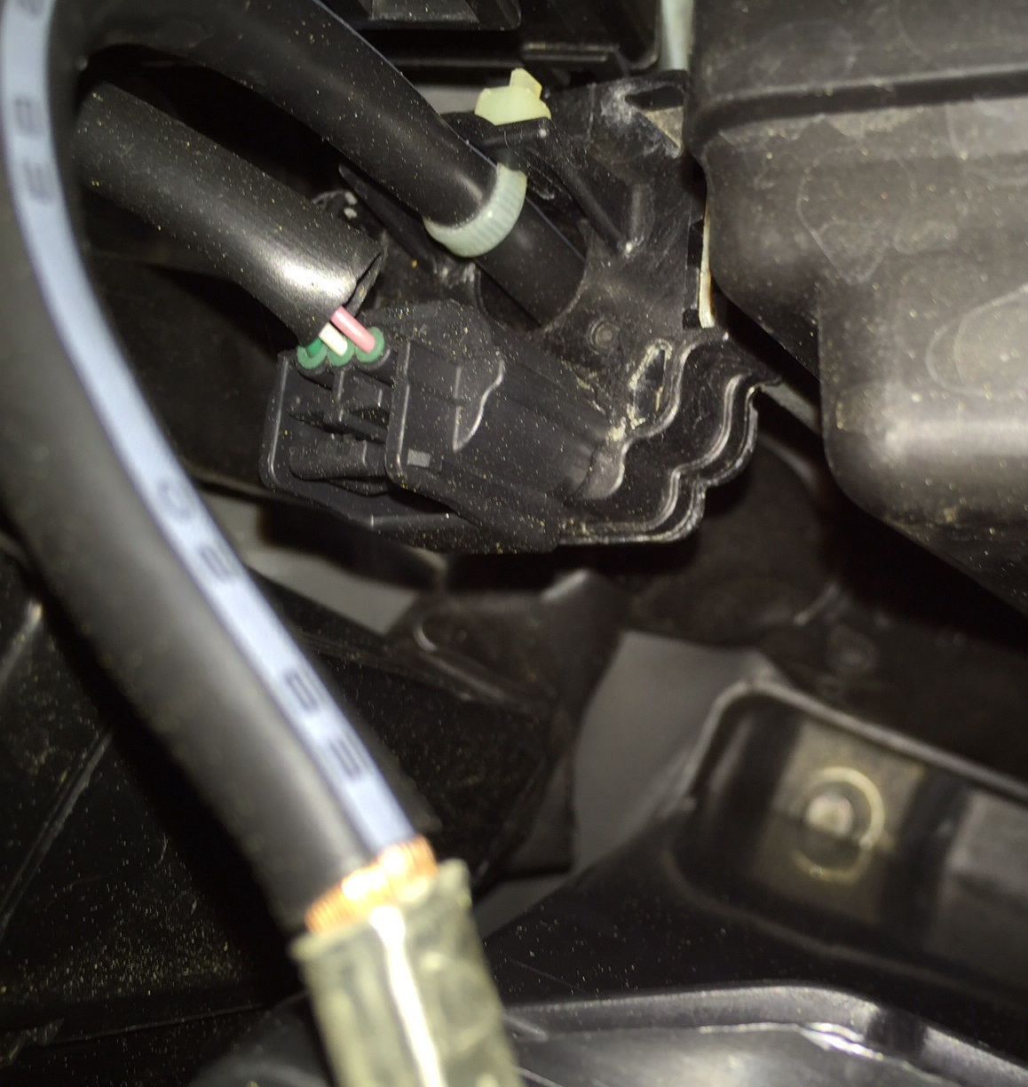

MORE DATA! MORE CAUSES OF KNOCK
So I installed a grounding kit (Big 3, etc.) and it caused some issues.
I went from a next to no knock to TONS of knock all over the rev range.
Temperature ranged from 70F-85F, high and low humidity, different gas stations, fresh oil, it didn't matter. I was getting knock events greater than 3* at different loads and RPM points.
All of that being said, I found this post by scarguy055
This is a copy of something I posted on the DIY sticky for the grounding cables. Putting it here because this thread is more recent.
Connecting an additional cable from the battery negative terminal directly to the chassis bypasses the battery current sensor, which can impact the power generation voltage variable control system, possibly leading to improper battery charging.
If this causes the alternator to charge too often, it can cause battery over-charging, premature alternator failure and decreased fuel efficiency.
It seems to me like the additional ground to the negative terminal would cause the battery current sensor to see less of the current, making it think there was less battery use, causing it to under-charge. Not only is a weak charged battery an issue for multiple reasons, but on my 'vert could impact the top operation which is very sensitive to battery voltage.
Like many current sensors, the battery current sensor appears to be a "ring" that just sits around the factory ground cable. The factory ground cable seems very thin and the battery current sensor appears to have plenty of room to accept a much thicker cable.
Has anyone tried to replace the factory ground cable from the negative battery terminal to the chassis by running a thicker gauge ground cable through the battery current sensor?
I wonder if the decreased space between the sensor and a thicker cable would cause the sensor to incorrectly sense what it thought was a higher current, causing the alternator to run too much?
After discovering this, I removed ONLY the ground from negative battery terminal to chassis. VIOLA! All of that weird knock was gone, 100% back to the normal behavior of my tune.
I think the tolerances of my tune, plus the now inaccurate voltages, caused it to deviate enough to cause issues.
My conclusion is: if you are doing a grounding kit DO NOT ground from battery to chassis, bypassing the current sensor. Especially after a tune.

Since the purpose of the grounding kit is to reduce resistance in the ground circuit, you can simply attache to the same grounding point as the battery cable instead of directly to the battery terminal. This will direct all current through the sensor. The negative battery cable is sized for the starter current load, so the running current should be no issue.
