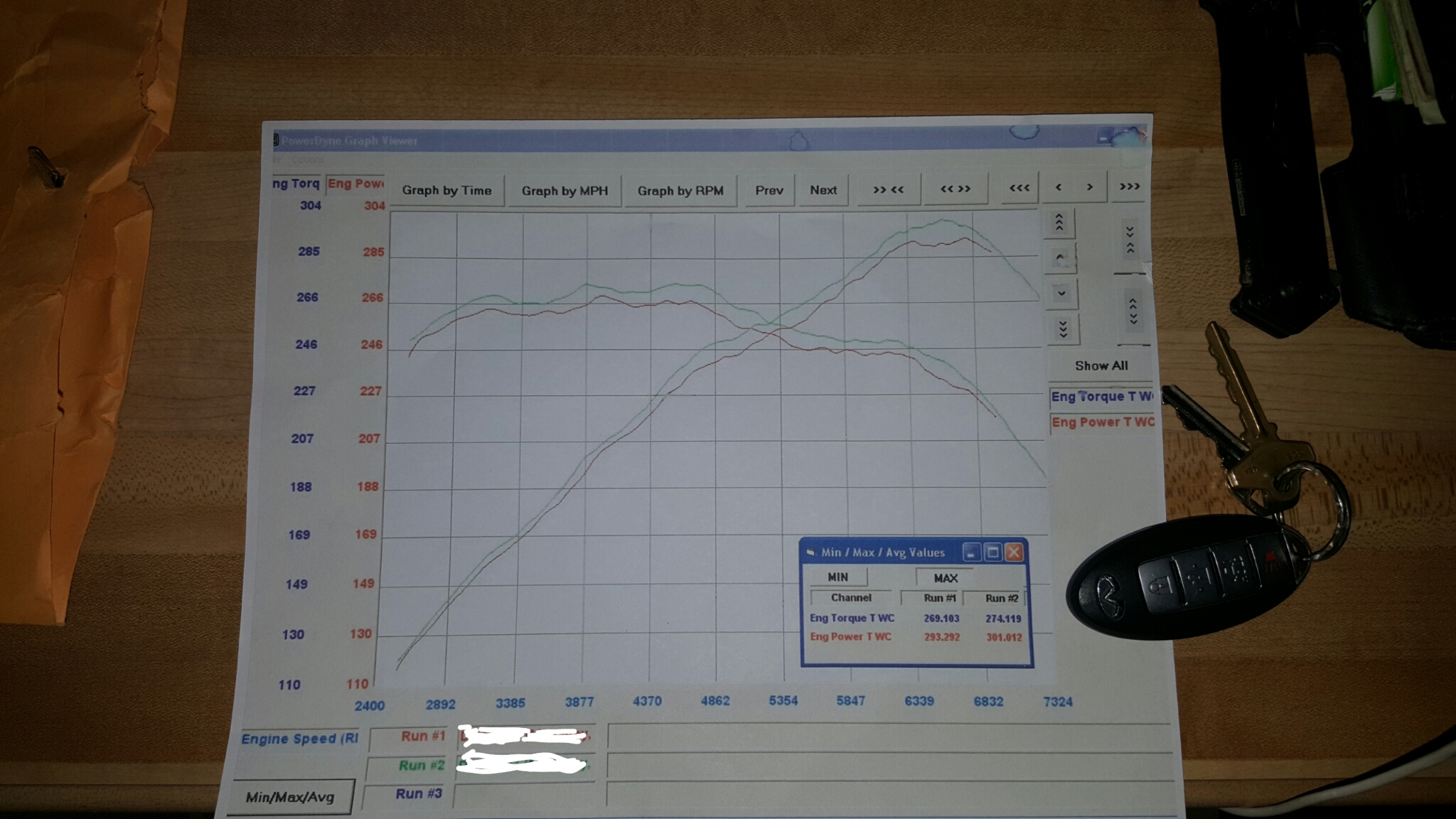

See that's what I thought, so why the cold shoulder all of a sudden, I tried emailing him again today and no response. My radars up and I'm not exactly sure why but something feels wrong, not with my car, just with the lack of response. Gonna post up the dyno log again which only shows HP/TQ, and then the conversation with names etc... removed maybe you guys can help me out. I don't want to make something out of nothing but I'm to new to this to really pick out what the issue is...thank you for the responses and help guys!

I really woulnt worry about the idle as much as your TQ falls off a cliff @ like 4700 it should pull all the way! Like mine did, it drops a hair but not like yours :/
. I really woulnt worry about the idle as much as your TQ falls off a cliff @ like 4700 it should pull all the way! Like mine did, it drops a hair but not like yours :/

Yeah the torque was a major concern for me as it's not really steady by any means... it pulls decent at first but I could always feel this wave of lag then it pulls again which is confirmed on the dyno. Why this couldn't be ironed out I'm not sure...
He did finally reply after I emailed again and it's a much better explanation but still no logs... doesn't even address that part... hmmmphh I guess that answer is as good as it gets. Now I need to see how I can straighten out the tq curve... any suggestions?
Email:
Hey, *not sure what specific numbers you are looking for, but from and AFR standpoint we are targeting mid 12's on WOT from a fueling standpoint and from a timing standpoint we are running 2-3 degrees more timing at WOT as well.* At peak TQ it hits 23-24 degrees and tapers up to 30 degrees towards redline.* Other then that it is trimming MAF values which are arbitrary to what voltage the MAF range is at to get all of you fuel trims in line.* Let me know if this is what you were looking for.
