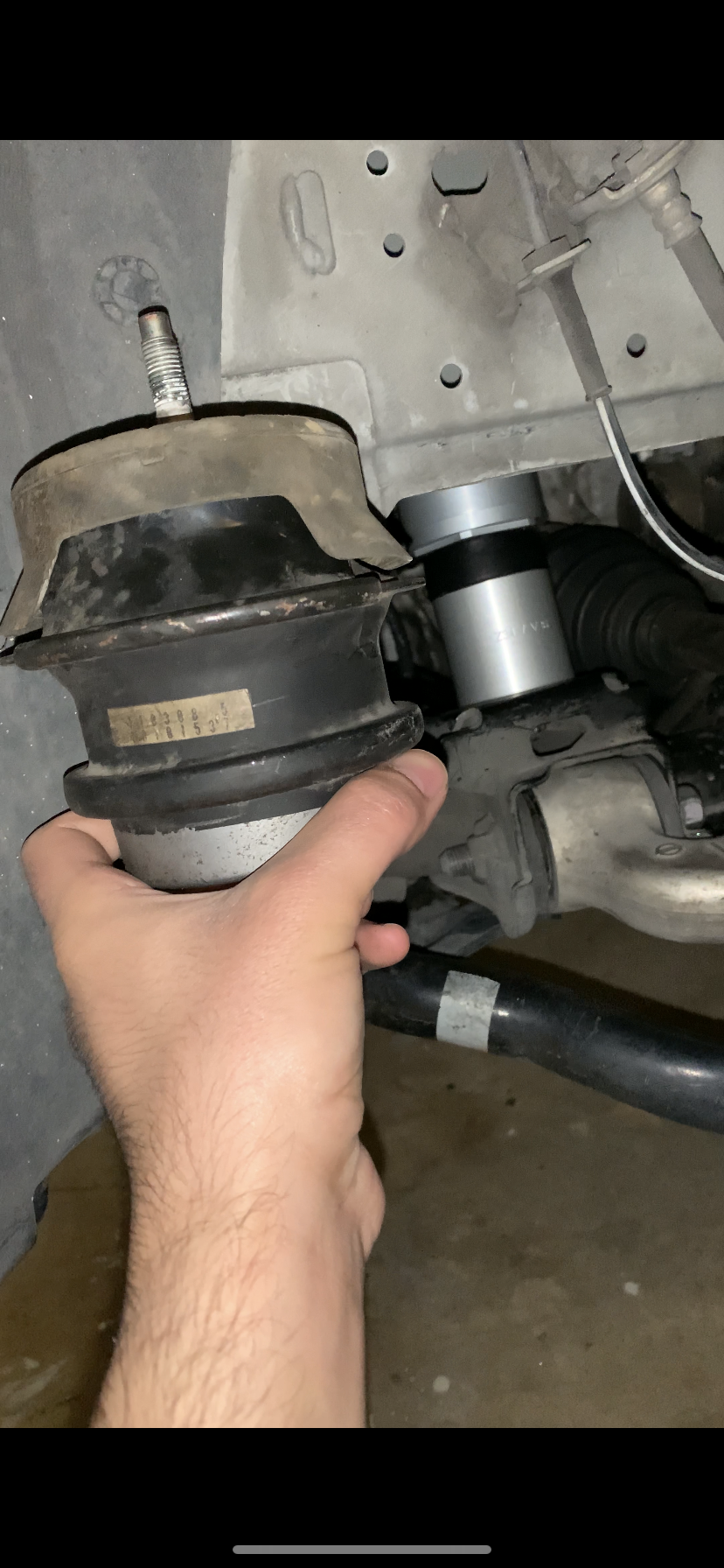

This is from the driver side view.
It is a bit bend backward not sure if that is how it is supposed to be or not?? I guess we will never know.
For the AWD owners, you have to bend these pinch welds outwards towards you in order to take the OEM motor mounts out. It does not have to be a lot just a small amount and you can wiggle it out of there.

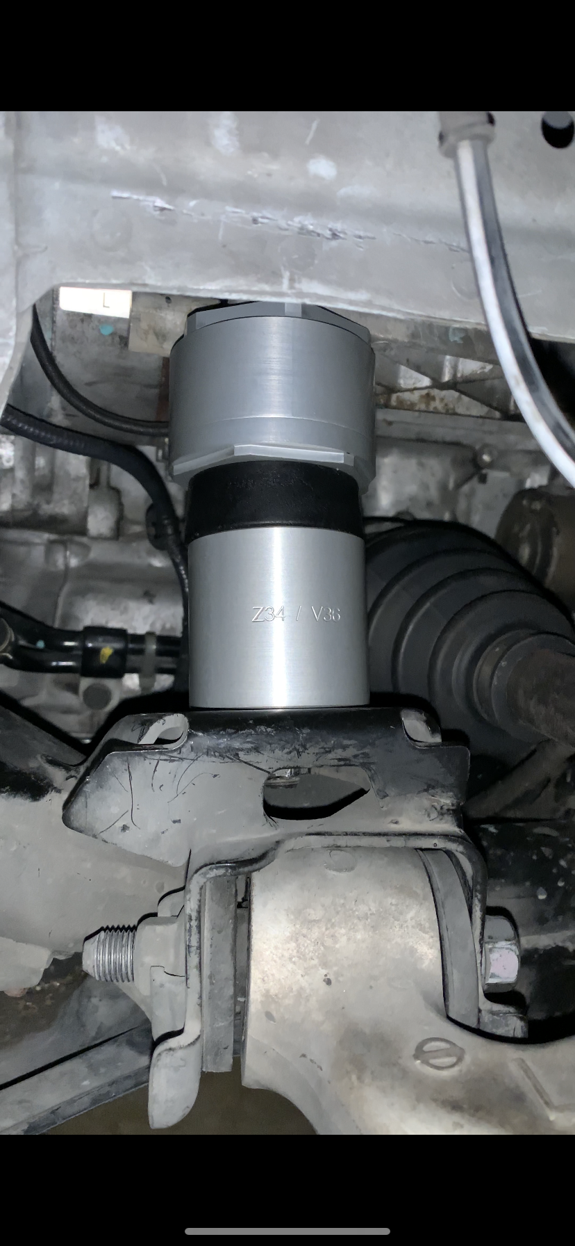

Just a little comparison.

Also a little bit more detail I emailed Brett and he informed me that these are 88A poly, unlike the Z1 which is 70A. I am not sure how much of a difference it is between the two since you will still feel vibrations during idle regardless (AT Owners). These might give you more of a "Sport" feel compared to the Z1.

For the top bolt, you will need assistance. I got a long extension bar, swivel head, and then a 14mm socket. I snaked it from the top (engine bay) and my friend basically maneuvered the 14mm socket onto the nut from down below. There is an A/C line just have to move it a little bit to the side and then have the socket seated on the nut. For the bottom motor mount nut, I loosened only that one bolt on the control arm that is below the engine mount. Once you remove that bolt you can move the control arm fairly easily forward. I pushed the control arm away from the engine mount and put a pry bar in the hole, where the bolt will originally go. Just so I don't have to fight the control arm when taking out the bottom motor mount nut. The drive side is the most time-consuming tbh.
Passenger Side:
This side is really easy. For the top bolt, I had the same set up long extension bar, swivel head, and a 14mm socket. Just put the 14mm socket on the nut and unbolt it. Fairly straightforward and has plenty of space to work around. For the bottom bolt, you will notice that the end of the control arm bolt is covering the motor mount nut. What I did is just loosen that control arm bolt until I was able to put my 17mm socket on to the motor mount nut. You do not have to take the control arm bolt out, but just loosen in.
Also, you need an adjustable wrench or something similar to bend those pinched welds a bit upwards in order to get some room to take out the motor mounts. It does not require a lot, you can see above on my images that I bent them outwards a bit.
