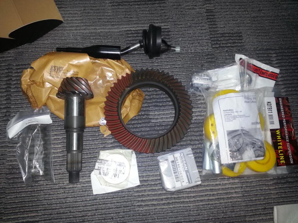

Originally Posted by G37Sam
How to do it
Here's a list of parts I used:
38100-0C760 : 4.083:1 Ring & pinion
38140-0C00A : Pinion Front Bearing
38120-EC000 : Pinion Rear Bearing
38189-P0117 : Oil Seal
38154-0C000 : Washer adjustment
43262-01P10 : Drive Pinion Nut Lock
38165-0C020 : Differential Spacer
Attachment 153943
Rochester- can you cross check these part numbers to make sure this is what you have before I order all the parts. I was hoping you might have an invoice laying around that still has all the part numbers.
It also looks like two of the parts have changed numbers according to Nissan: 38120-EC000 has changed to 38120-0C000 and 43262-01P10 has changed to 43262-01P1A.
Thanks!
Sorry, no, I don't have the part numbers.
Between researching the forums and retailers selling kits, I'm sure you've got it right, tho.
