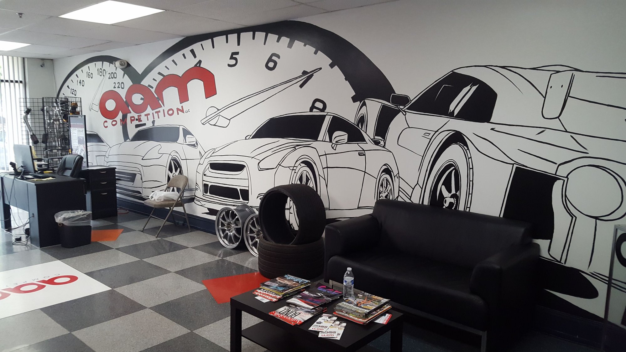

I recently purchased a Transgo Reprogramming shift kit (valvebody upgrade) for the 5AT in the 2008 g37s. Also bought 9 quarts of Matic S per fluid requirements. All work was done by AAM competition in Maryland, and took approximately the whole day for their mechanic to disassemble, drill holes, install parts, reassemble, add new fluids. I was surprised that it only took 7 quarts of Matic S instead of the original intend of 9 so I'm going to keep an eye out for that.
