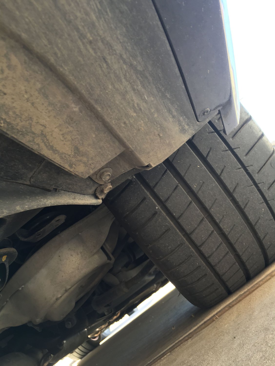

While you're under there look for the 10mm screws holding the under sides of the bumper too. Remove these on each side.
The last screws holding the bumper on should be in the rear wheel wells. These are 10mm as well. Remove these. Now the bumper is held on by the clips on the wheel well/rear fender areas. Pull firmly and evenly to pop the bumper out of the clips. (Don't rush because you may break you bumper clips, trust me...)
