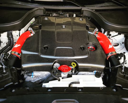

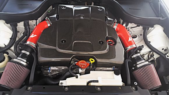

BEFORE: K&N Drop-ins, Vented Airbox and Snorkels removed with Mishimoto MAF tubes.

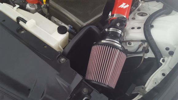

AFTER: with K&N (4.5"OD and 6"L) Cones, JWT style 4.5"-3" Velocity stack, 3"-2.5" reducer coupler, K&N Typhoon heat shield, Mishimoto tubes and OEM MAF sensor tube removed from intake.

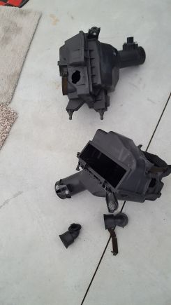

First step: is to remove the intake boxes and cut the MAF housing tube off an inch past the box.
Second step: is to remove the stock snorkel which you can see in photo sticking up near the frame.

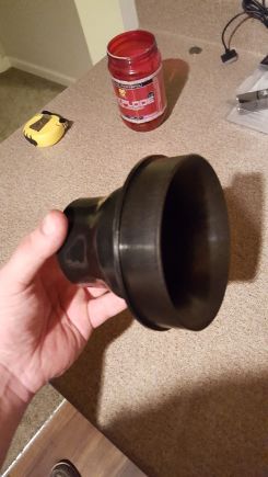

Here is the reducer coupler with the 4.5" od JWT popcharger style velocity tube

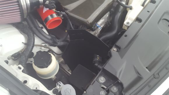

Here is what it looks like with the K&N Typhoon Heat Shield mocked up without OEM MAF housing tube, reducer coupler, and K&N filter (all mount together using hose clamps pretty self explanatory there)

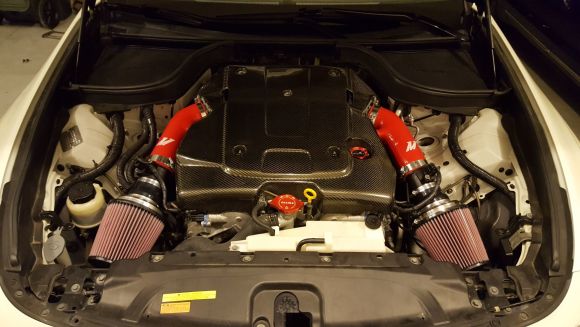

Here is with the full intake installed with the K&N Heat shield.
This is what it looked like before the Typhoon Heat Shields were installed.
Once I get a good day I will be running my Dashcommand to gather more log info and will do a video with sound. With the hood dampening mat out (commando mode) it sounds aggressive up top but not over bearing during normal driving.
