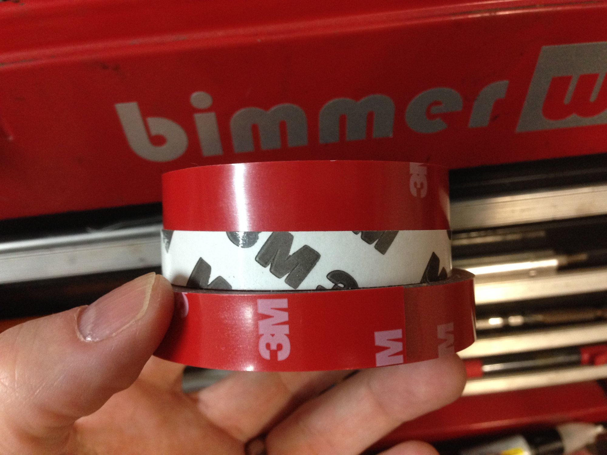

Also the "3M" logo on these is just that a logo. It is not real 3M adhesive tape.
This is:
The removed backing wrapped around REAL 3M adhesive that I had to use because the Chinese version didn't stay. Yes I cleaned the bottom of the door first.
