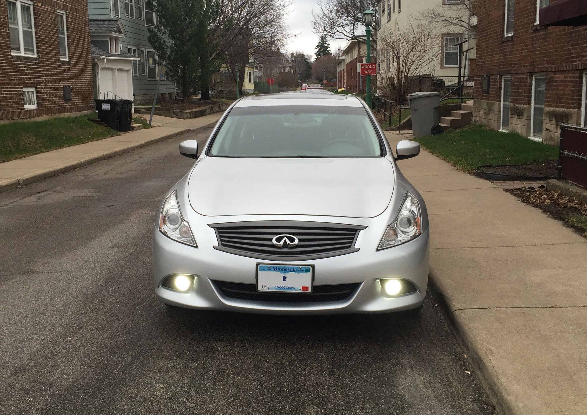

Daytime

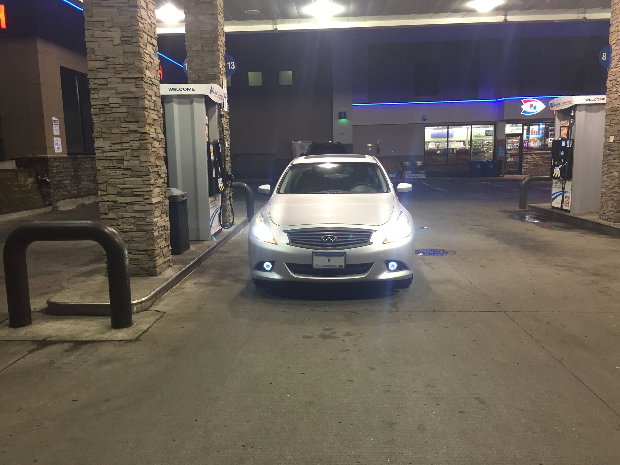

Nighttime - Halos
Nighttime - Fogs
***just to note: The fogs appear kind of yellowish in the daylight photos. They are bright white, no yellow whatsoever -- Blame Apple for their camera quality. While the halos do have a definite hint of blue, they look MORE blue in the night pics than they actually are.
