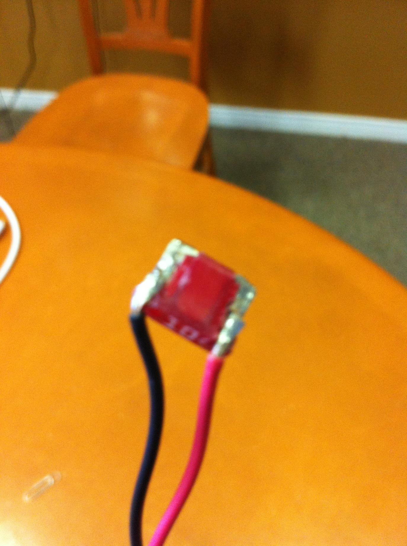

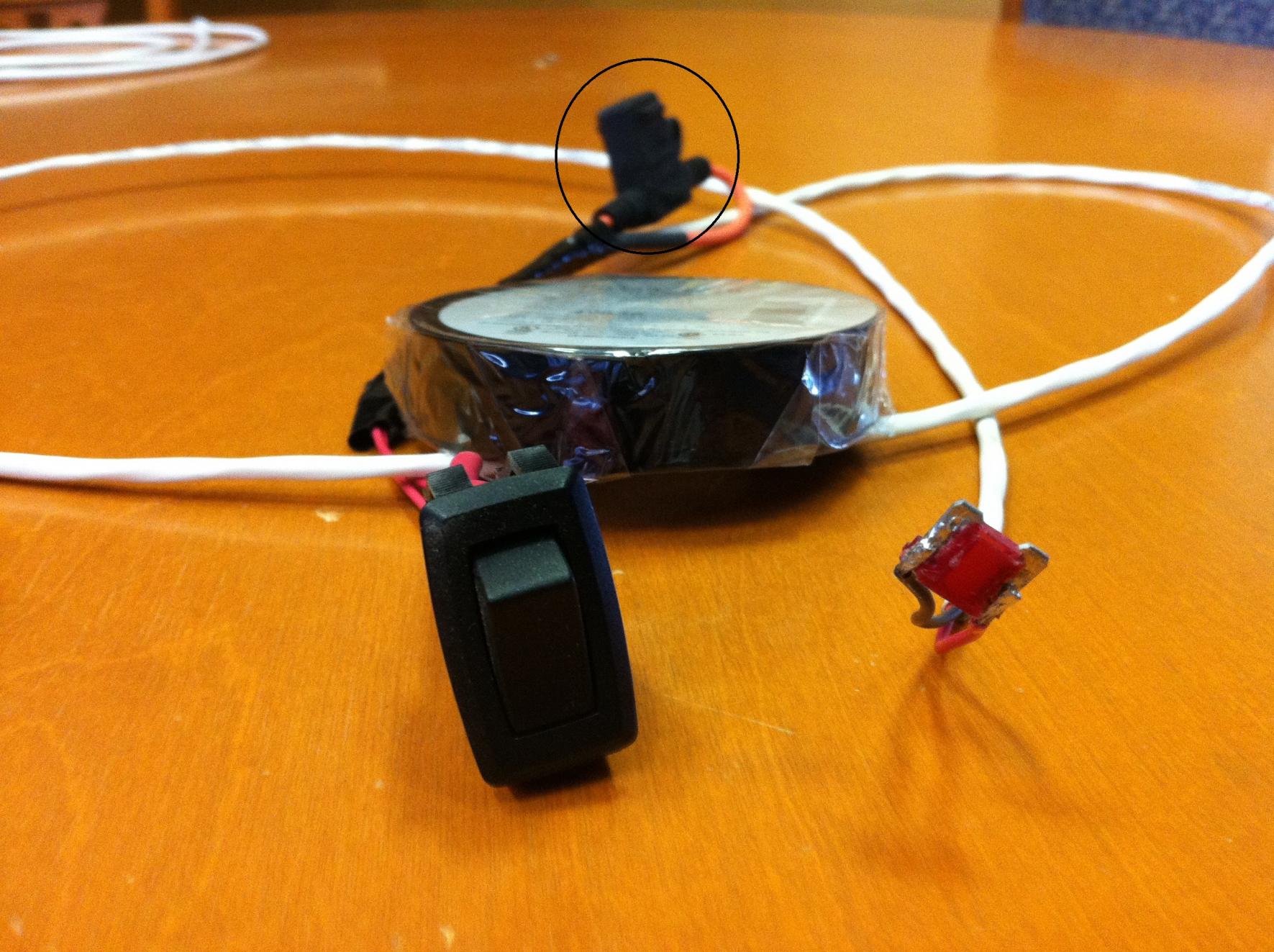

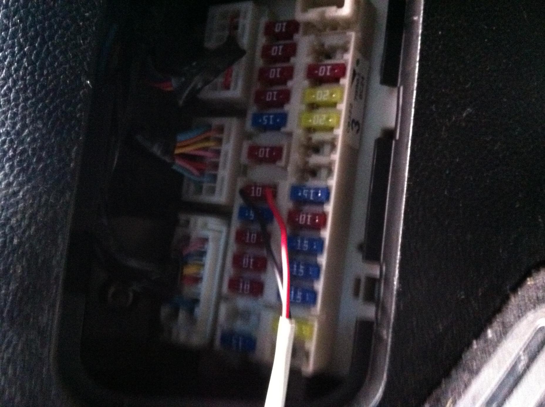

here you go. i did this over the winter and had fun on winter tires. lol
hopefully my explanation will make sense or pics should explain itself.
- pic 5 & 7 - i broke the fuse and then solder wire in each end. you can see from the 2 pics that i had to remove some of the plastic in order to have room for soldering and that i can only solder on top of the leads and if i solder too close to the middle the fuse will not fit back in
- i use a inline fuse holder and attached it to the switch.
for now i just have the cable/switch by the left side of the seat. i will be switching switch to a flip cover style switch when i have time and put it next to vdc & trunk release.
