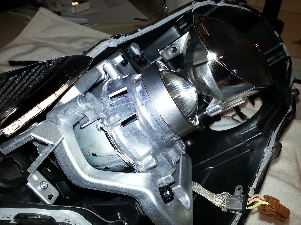

So I was looking to see how to do this, and found nothing concrete. I would like for this to be concrete with picture of how to lens swap a 2008 G37s coupe lens from stock to tsx-r.
Plenty of DIY on opening headlights and whatnot, so this first picture is where we will start. Headlight opened, and some plastic around the lens removed.
1st pic- everyone knows how to open the headlights. If you don't check for some other DIY's, this one is for tsx-r lenses. This shot is from the side. The metal ring you see on the side of the lens, holds the lens.
2nd pic- I don't have a pic here, but see the crimps in the metal ring in the first picture? There are 4 crimps around the metal ring which are holding it on. You will need to pry these crimps open a little before trying to remove the lens. To do this I used a paint can opener. I guess there is a second picture, here it is.

3rd pic- Once you have attempted to release the 4 crimps on the metal ring, you will need to get it off. To do this I used pliers, but instead of using them to pinch, I used them to pry open. This is the best pic I could get. Use common sense to get your pliers to grab the edge of the ring. Work your way around the ring and pop it off. Here is my pliers method
4th pic- So work your way around the ring. It will start to come off
5th pic- The ring is off, the lens is free to be removed.
6th pic- It is time to add a spacer. I did not pay for a spacer, I have no idea if I need a spacer (due to conflicting internet information), but I added a small spacer. This spacer you can barely see is 1x cardboard cereal box. If I get a nice cutoff, great. If not, I doubt I open this back up. When I can test I will show you what these look like but it is 7 degrees outside.
7th- just a pic of the lens on top of the spacer

8- put the ring back on over your new tsx-r lens which is resting on the spacer, and push hard to crimp the metal ring back into the 4 locations it was originally crimped.
9. reassemble headlight
