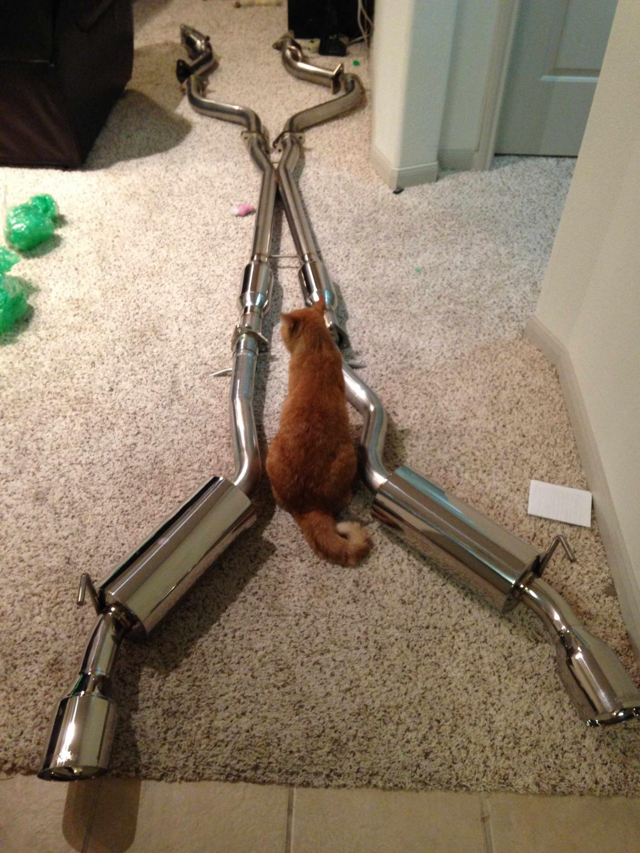

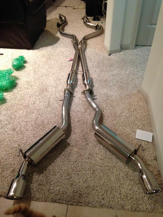

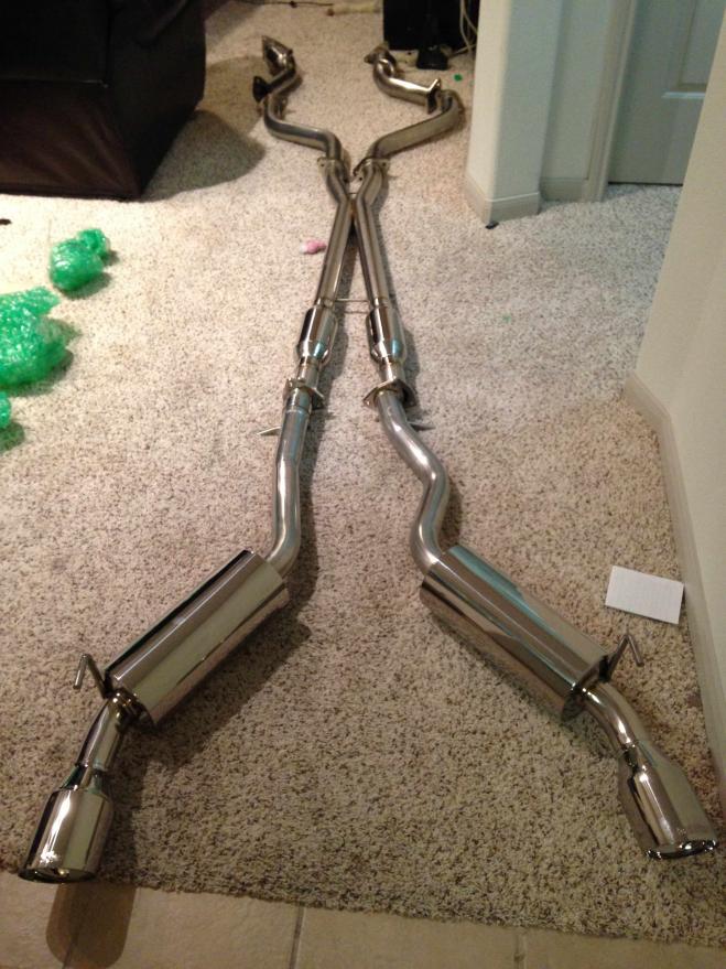

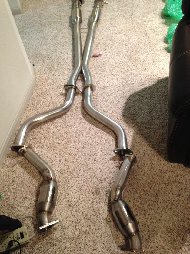

It's late, and I just got my shipment. I'll be doing the install tomorrow, and upload pics once everything is done. For now, I'll post up pics of the exhaust sitting arranged on the floor. Tomorrow I'll come clean up this post and add in the rest of the writeup/pics/what worked/what didn't work.
If you've got tips and hints before I get started, let me know. Apologies for crap pictures/video/advice.

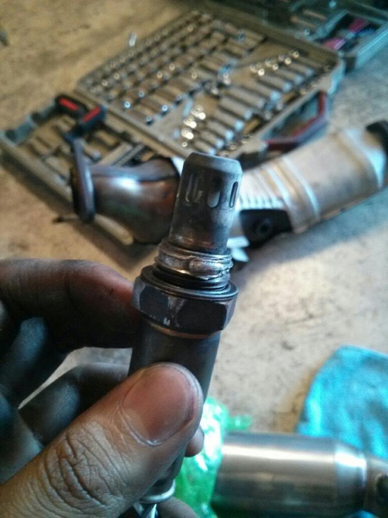

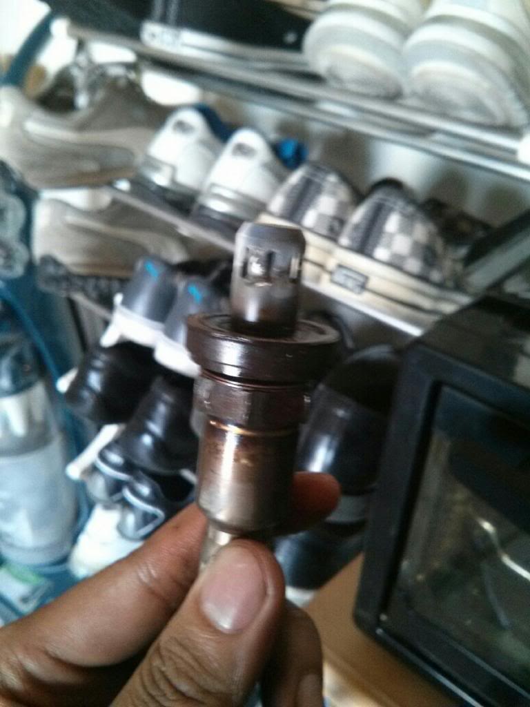

I just installed my FI RHFC on my 08 G37S with 70K miles. It is a California car and those demon bolts were rusted on there pretty good. I would rate this DIY 8/10 difficulty.
Here are some tips:
-Spray WD40 a couple of days before.
-Do not use long impact socket on the driver side just use a regular 14mm socket because the steering column will be in the way.
-Do not resort to using 9/16 or you will round the bolt like I did.
-If you do round the bolt purchase a bolt extractor socket.
-Have a 20 inch extension bar, 1/2 socket.
-Be prepared to purchase some new O2 sensors if your car is old and has 70K miles like mine. I recommend some used ones on eBay.
-Remove the O2 sensors off the car.
Check out my O2 sensors, this was not my fault and I have no idea why they seem to be fused with my OEM cats. I applied so much torque that I broke of the driver's side threading...

I didn't use an impact wrench for any of it, but it would have definitely helped. Heat + mileage = fused O2 sensors. Good additions, this is a japanese car, don't resort to imperial sockets!
