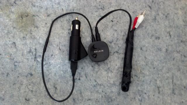

All tucked away. Once I find a shorter Aux in cable, I'll clean it up a bit.
This is what your setup will look like. I didn't shorten the Aux In cable yet because I was afraid of causing noise artifact.
Another possible mounting point. Note to self... clean my seats.

I read some of the reviews about it before I bought it and that seemed to be a complaint from a few owners, however, that doesn't seem to be a problem with mine. Ultimately, this started out as an experiment for me to see if it could be done, so I went with one of the lesser expensive ones.
Now that I know it works well, I will probably buy a better BT gateway and hopefully I can find one that auto-connects.
