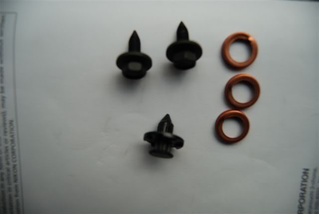

Anyone have an Infiniti/Nissan part number for the under-engine splashguard (belly pan) retaining screws on a 2010 G37? There are 15 10mm screws (M6 threads, 22cm long, 10mm hex head). A "quickie lube" joint lost 4 of them during an unfortunate oil change event. Never again. Thanks.

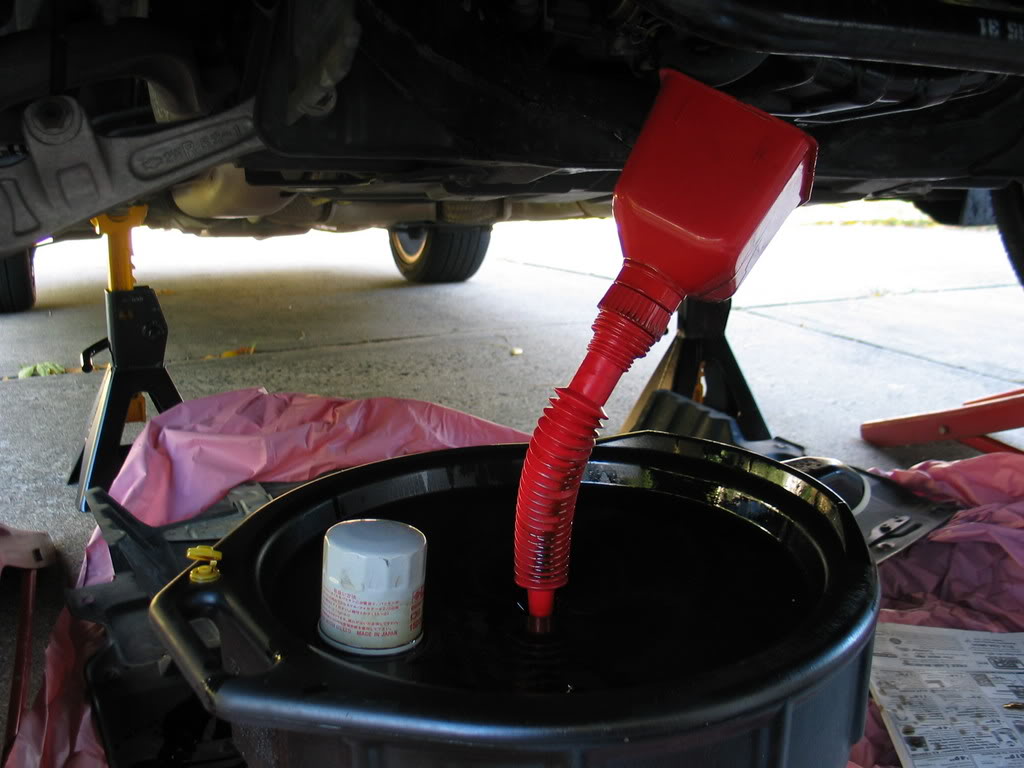

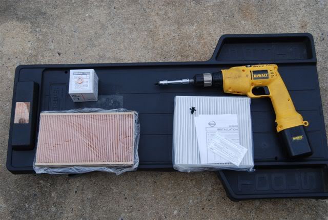

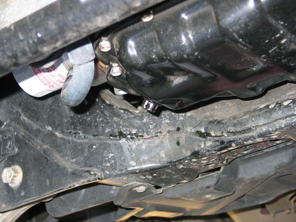

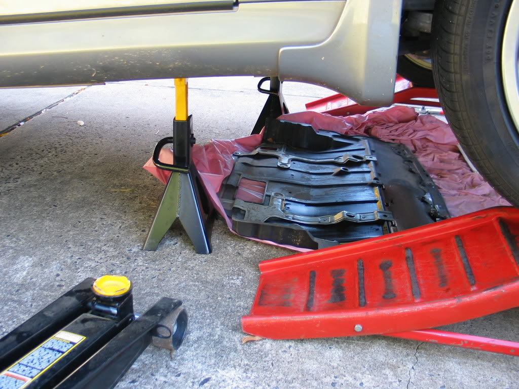

I am buying a used 2008 G Sport M/T, and will probably change my oil most of the time, I am sure it is easy , but where is the DIY just so I can become familiar with the car? I searched, and searched, and only found changing trans fluid

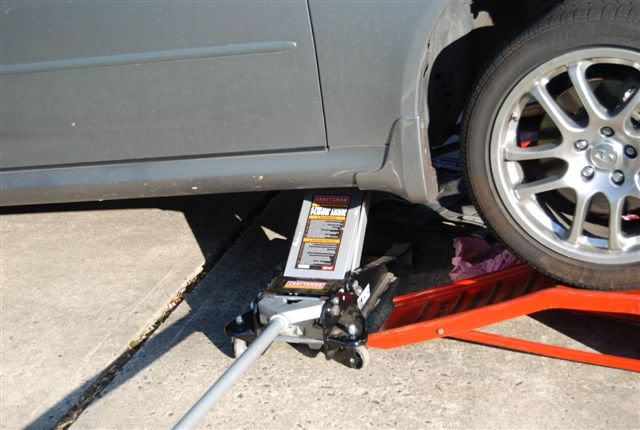

You'll need a four ton floor jack, ramps, jack stands, and sockets. A cordless drill helps for quickly removing the fiberboard shroud.
Notice the wife's old plastic shower curtain that prevents oil spills on my concrete driveway
Have fun

Originally Posted by jerry814
anyone have an infiniti/nissan part number for the under-engine splashguard (belly pan) retaining screws on a 2010 g37? There are 15 10mm screws (m6 threads, 22cm long, 10mm hex head). A "quickie lube" joint lost 4 of them during an unfortunate oil change event. Never again. Thanks.
01456-00691
Have fun
Telcoman
You don't think that might be a little overkill?
Old Jan 29, 2015 | 02:13 PM
  #23
telcoman's Avatar
telcoman
Posts: 1,638
Likes: 161
From: NJ
No!
If one is going to acquire one get one with a little more capacity. I had a three ton and was not happy with it.
Telcoman
Just my opinion
Old Jan 29, 2015 | 04:58 PM
  #24
G37Xtreme's Avatar
G37Xtreme
Posts: 1,047
Likes: 104
From: Charlotte NC (sorta)
I have a 1.5 ton floor jack, and it works just fine for each corner of the car. It would probably work fine for either half of the car as well.
I'd rather have a 2 ton...but that one wasn't discounted nearly as much as the 1.5 ton. I also wouldn't bother jacking the car unless I need to remove the wheels or take weight off the suspension.
A nice wide set of Rhino Ramps (or alternative) is all I use when I change my oil. It takes all of 5 seconds to drive up on ramps.
I also use a battery powered impact driver on the splash guard bolts. Be careful when reinstalling not to over-tighten.

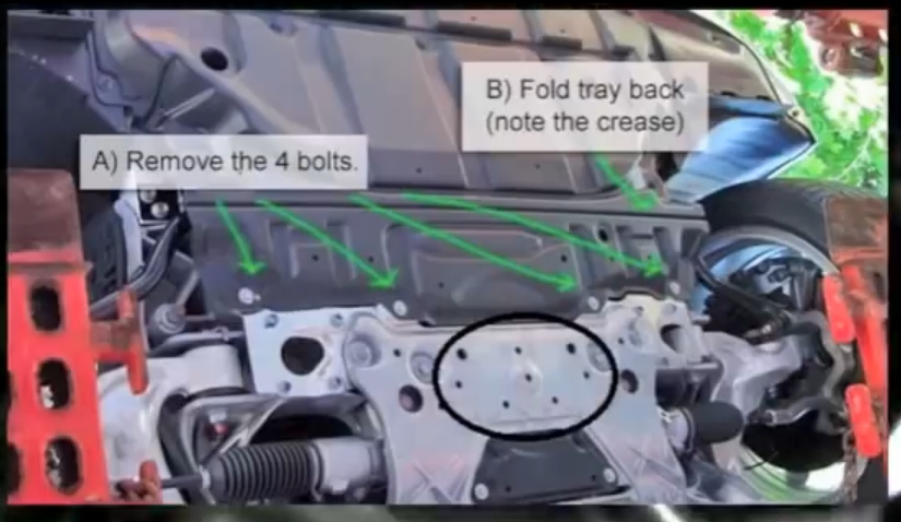

Replacing the "belly pan" (lower engine cover) screws that the idiot "quickie lube" idiots forgot to replace after an oil change. Never again, never again! Do it yourself or go to the dealer.
The 2010 G37 convertible has 15 screws that retain the center plastic cover - only 4 need to be removed to get to the oil drain and the oil filter.
They are M6 x 1.0 metric screws, 22mm in length, captive washer, 10mm socket head to remove. The Nissan/Infiniti part # is 01456-00691.
It has been like pulling teeth to get this information. I put the 2010 G37 up on ramps, and did it myself.
A fine YouTube video is at
