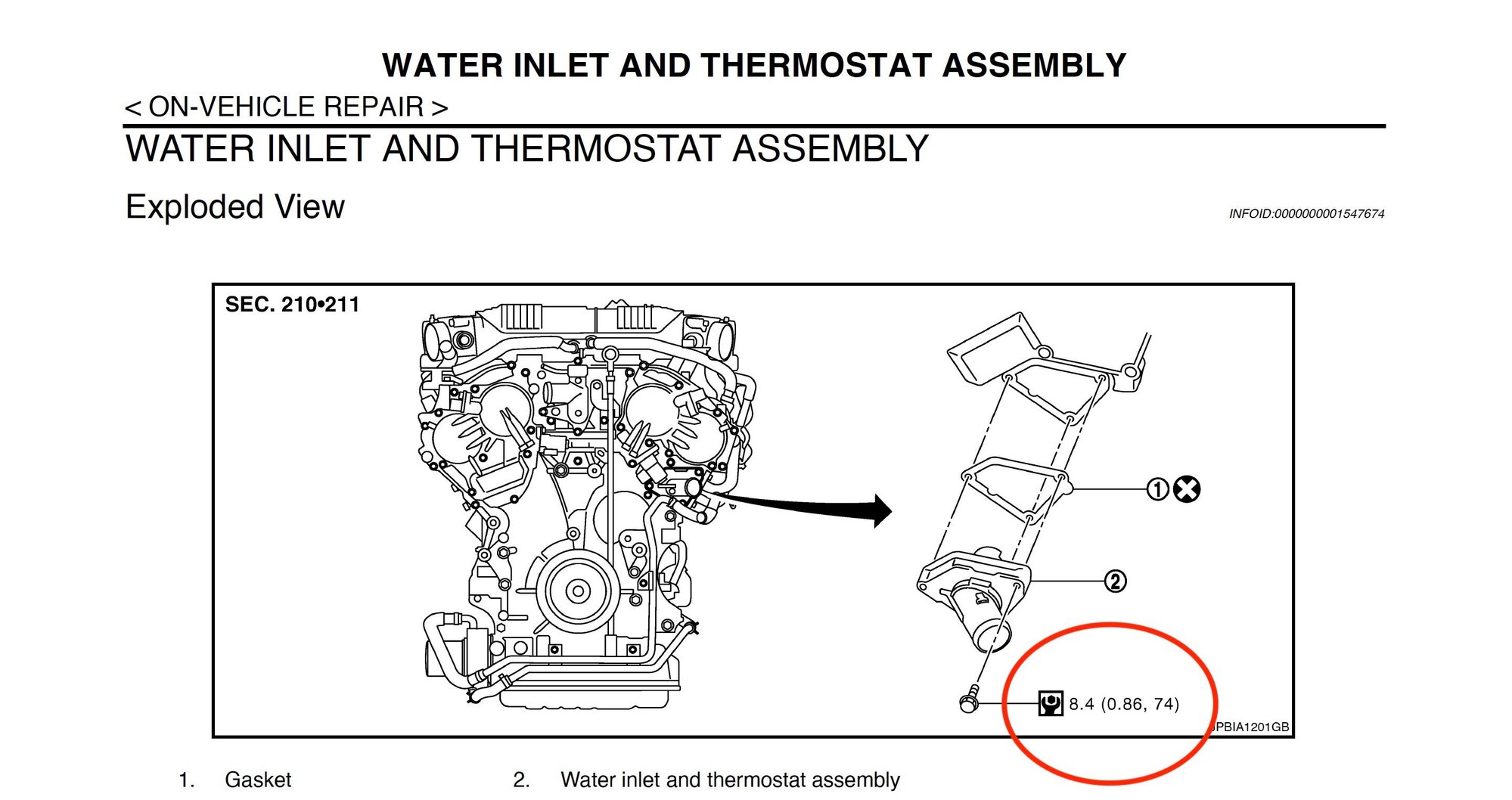

What is the torque for thermostat install??
2010 G37 Sedan
Old Mar 6, 2021 | 10:09 PM
ILM-NC G37S's Avatar
ILM-NC G37S
Joined: Apr 2014
Posts: 4,854
Likes: 1,610
From: NC
74 INCH/LBS. or about 6ft/lbs.
In other words, not super tight.
