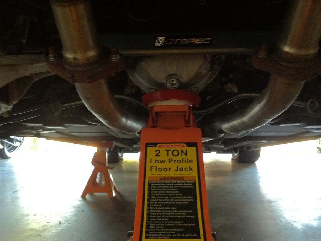

heres a picture of where to jack up your car from behind!

updated with a picture! check the first post
btw... this is the frame rail youre talking abotu right?
