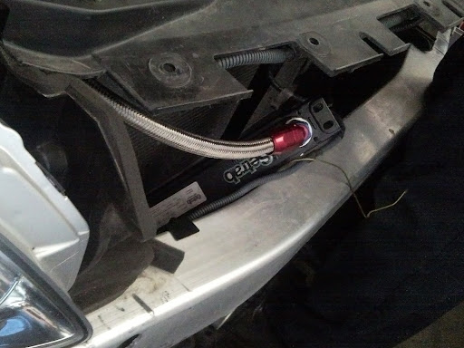

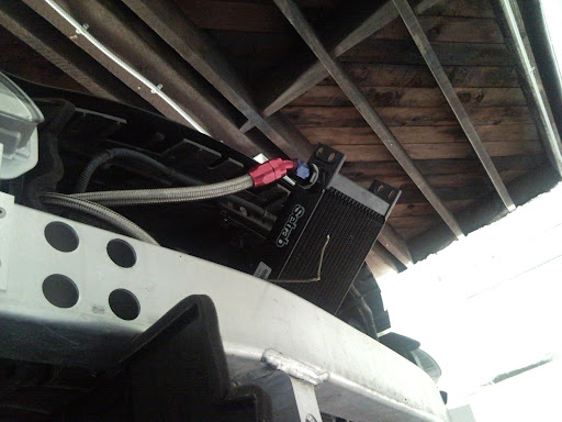

Setrab Series 6, 16 row oil cooler. $145 Shipped.
Bought from eBay seller. Setrab is made in Sweden and it is best oil cooler out there.
8AN 90 Degree Double Swivel Hose End - Anodize from sweet performance. $16.94 each you need two.
8AN 45 Degree Double Swivel Hose End - Anodize also from sweet performance. $16.94 each you need two.
You have option of using 8AN or 10AN. We chose 8AN, no special reason. But make sure to fit all hose and hose ends to match the size. Make sure to use Anodized hose ends.
8AN Stainless Steel Braided Hose - $6.50 per foot from sweet performance. We used 6ft, but I recommend 8ft. All aftermarket oil cooler kits use, nylon hose. But we opted for stainless steel for protection against rocks and debris.

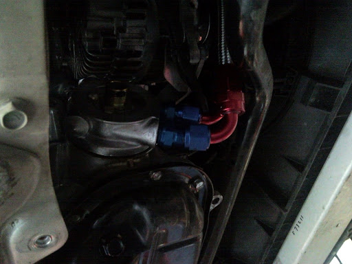

Mocal Hi Flow Sandwich Plate Thermostat BSP Adaptors, $95 shipped from eBay Seller.
Oil Cooler $145
Anodize Hose Ends (x4) $67.76
Stainless Steel Hose 6ft $39
Mocal Hi-Flo T adapter $95
10AN to 8AN adapter (x2) $20
Total cost before tax $366.76

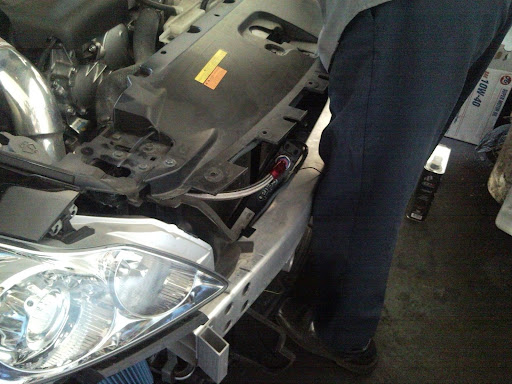

After acquire, all item above fitting is pretty easy. Almost

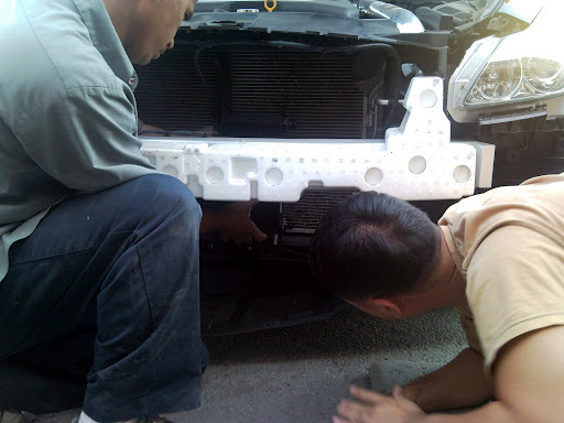

1. Remove bumber
2. Fit 90 degree hose ends on Sandwich adapters
3. Run hose up and over intake duct.
4. Secure oil cooler in front of radiator. I ran holes through center steel post and secured with some bolt. But there are brackets out there.
5. fasten 45 degree hose ends to the oil cooler.
we have originally planned to place the oil cooler on the driver side of the vehicle. However 3 ft stainless hose we bought forced us to move the oil cooler over to passenger side. Oil filter is closer to the passenger side of the G37.

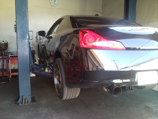

Yes we are lucky, one of our friend owns a service center. So we got to use his.
Drain all you oil before any fitting

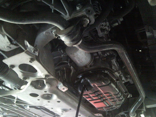

Remove oil filter and fit the thermostat sandwich adapter

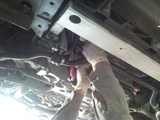

Run the hose over and through intake duct.
Make sure to adjust angle of the oil cooler so the hose nor the ends touch other parts of the car. We fitted our between front sway bar and ignition motor on top. It is tight.

1. Remove bumber

Wondering one thing though... where does the oil filter go after you remove it and install the thermostat sandwich adapter? Does it just screw on on top of it?
*Answer* Yes. Duh! lol
