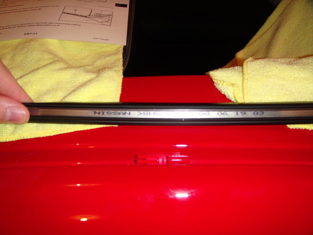

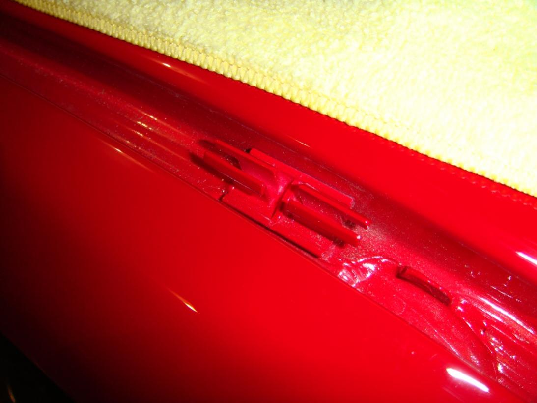

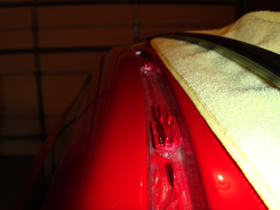

You will need some type of tool to help disengage the first clip. The manual has a “removal tool” that is nothing more than a flat blade. I used a scribe with a 90 degree bend on the end. This allowed me to get under the trim and right near the first clip (the tool acted like a hook). I then put pressure on the inside of the trim towards the center of the car and pulled up. Once the first clip was disengaged, I put the scribe down and used my hands for the rest. Gripping the trim as close to the next clip as possible, tug and pull at the trim until the clip lets go. There are five clips on each side. I started at the rear and worked my way forward. The clips stayed in place for me and looks like they were attached to the car before painting. Total time was about three minutes for each and that was taking my time to not hurt anything. With whatever tool you choose to use, be careful of the paint and the rear glass. I did not like the idea of prying the trim up and that is why I choose to use the scribe (to hook it and pull up).
<O</O
<O</O
Here is what the manual shows and pictures of the actual clips. <O</O
