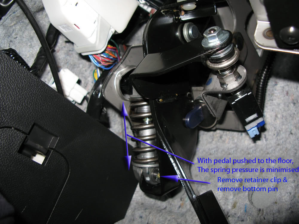

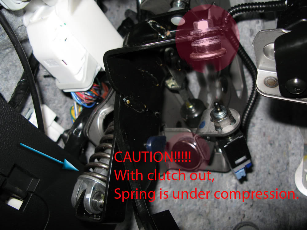

The pics pretty much tell you what you need.
Basically;
- hold the pedal down to the floor to un-load the spring (Tie the pedal down)
- remove the spring clip
- remove the bottom pin
- take note the order of assembly, so that you can put it back.
- after testing, (if you like it) remove the top pin to completely remove the booster spring assembly
Again CAUTION!!! with the spring under load.

Question: About the spring being dangerous.. if the clutch is all the way down isn't the spring un-tensioned and no longer dangerous?...
