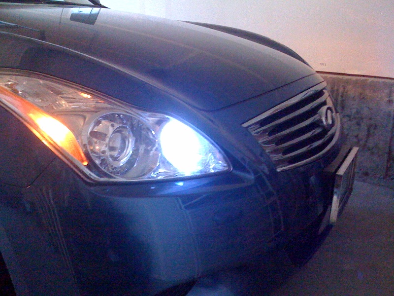

Yep....It was also tough getting the bulbs on with only one hand. Here is a picture taken from my iphone. These bulbs are a little bit more white than the HID headlights.
What bulbs are those? Are those the fogs or the driving lights?
Old Nov 9, 2008 | 10:19 PM
reddemon73's Avatar
reddemon73
Joined: Jan 2008
Posts: 93
AndrewDDS,
These are driving lights. I got these at superbrightleds.com. They are the 921-cw12 model.
