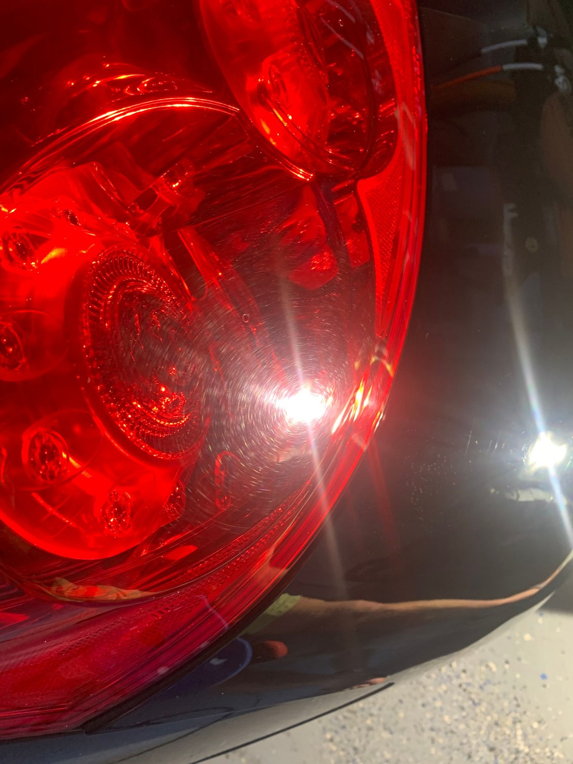

Recently bought a 2009 Sedan and wanted to polish and ceramic coat it. Got a little curious as to how it would go once I read about the self healing paint, but it polished up without a problem.
I thought the paint was pretty decent when I bought it, but proper lighting really shows the 11 year old black paint in all it’s glory. No shortage of swirling, oxidation, and just overall haziness.
Much improvement after just the first pass. Removed roughly 75% of the surface scratches and oxidation. Still plenty of haziness, but that will be dealt with the following passes.
Same photo as above, just not zoomed in.
Original vs fully corrected
No photoshop or filters. Just an iPhone camera and a lot of time spent polishing. Coated with Dr. Beasley’s Nano-Resin.

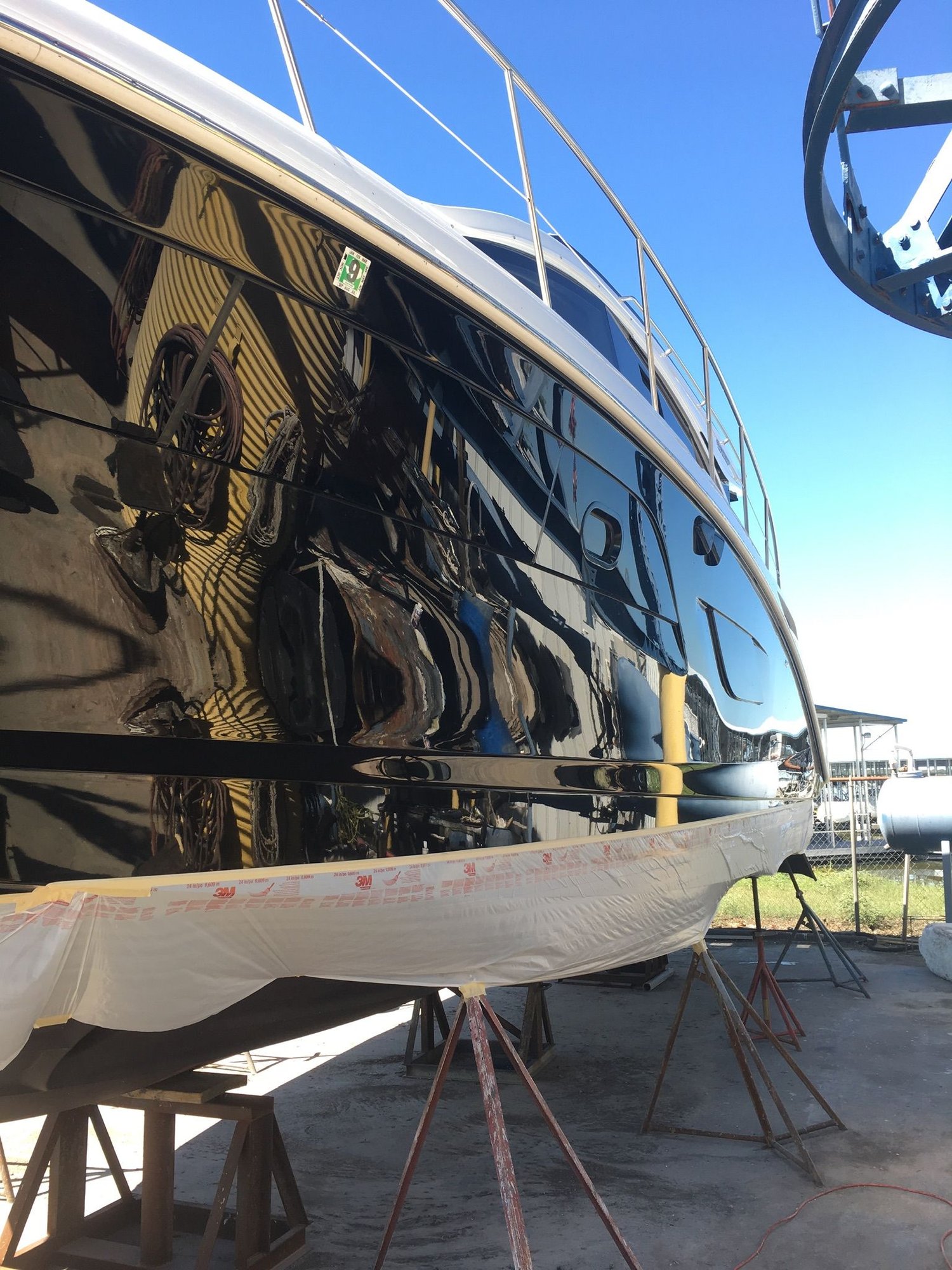

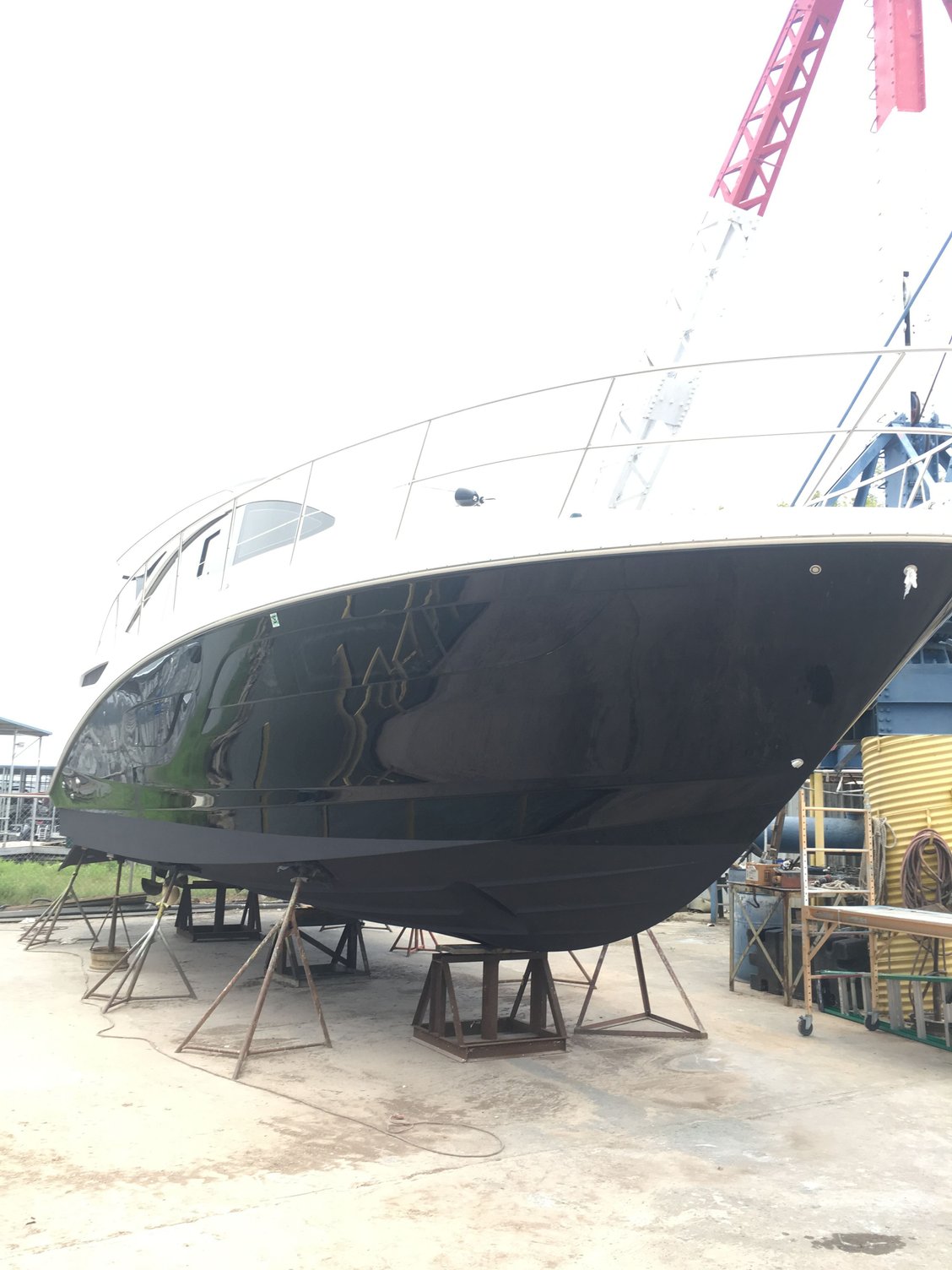

I paint and repair fiberglass boats for a living, so paint imperfections are often the first thing that catches my eye. Since the paint wasn’t the best and it’s my own car, I really wanted to see how much improvement could be made and pushed the clear as much as I was comfortable with. There’s at least 25 hours into this correction and she’s still not perfect, but I’m probably the only one that’ll ever notice the imperfections now at least.
And if you think 25 hours is a long time, then allow me to provide some perspective.
This was our more premium paint job which includes sanding, body work, primer, base coat, 2 stage dry polish with 1500 and 3000 grit sandpaper, lots and lots of clear coat, 3 stage dry polish on the clear with 1500, 3000, and 5000 grit sandpaper, a final finishing buff, and then waxed.
Please don’t interpret this as advertising or anything. We couldn’t get to your boat this year if we tried.
