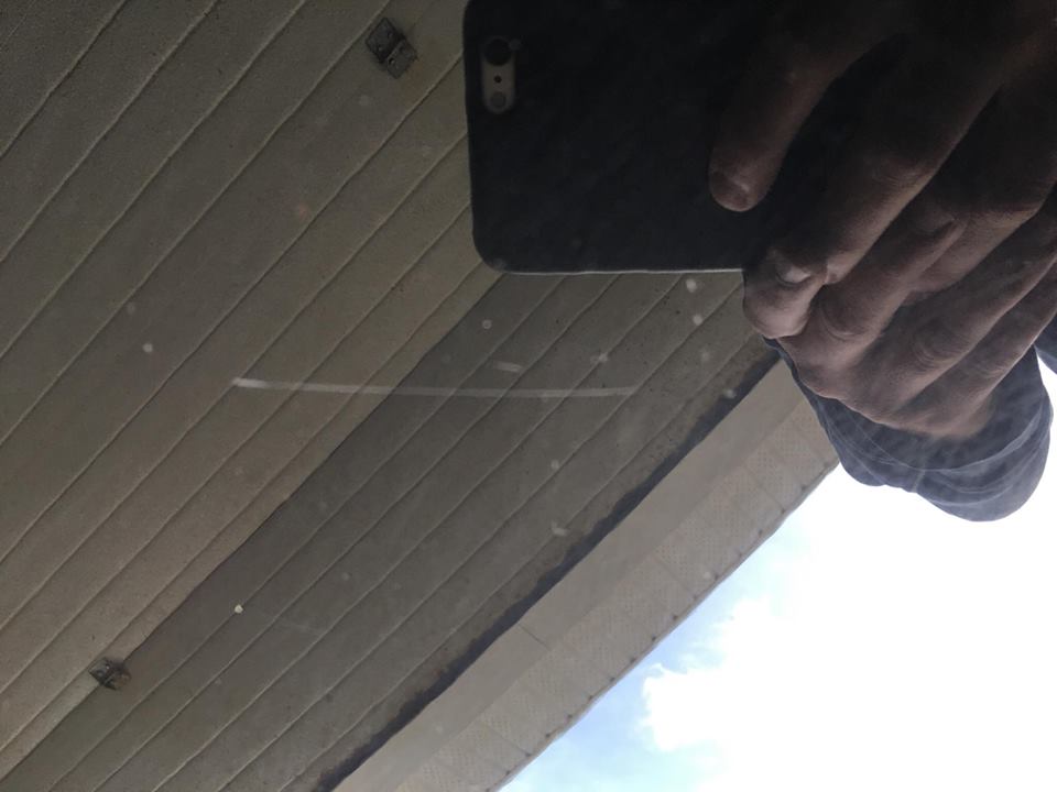

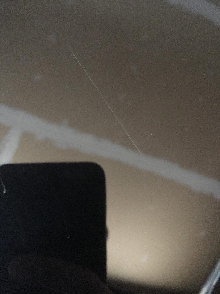

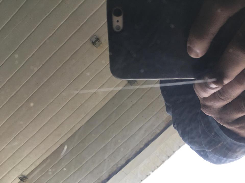

Hey guys,
Today I gave my car a wash (2 bucket method) and noticed a couple things that I didn't before
1. The scratches? on the hood, I didn't have these before so Im suspecting that i got them with the mircofiber washing mitt (chemical guys), maybe something was stuck in it and caused these scratches. What can I do to get rid of them

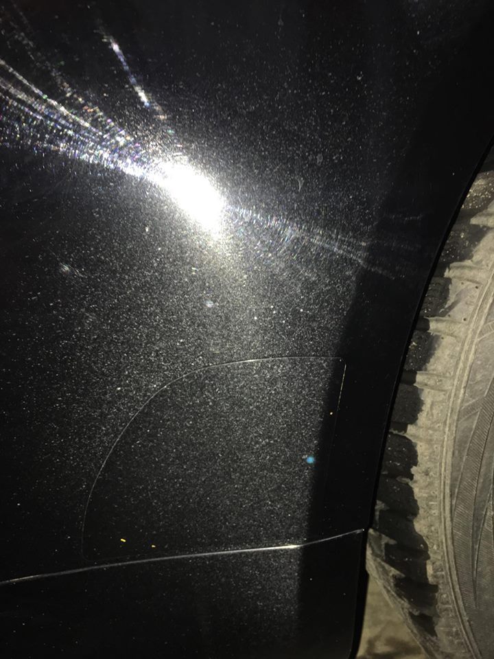

2. On the side of my car, lower part before the rear wheels is a dirty spot that I cannot get rid of. Im suspecting it may be stuck on there and need a pressure washer to get rid of (I'm using a normal garden hose). Will a pressure washer take care of it?

go out and buy a clay bar. that will get the particulate that is stuck on the paint off. next get good microfiber cloths and some polish. it looks like you can hand polish out that scratch on your hood. then apply a coat of wax over the top.
hand polishing can take some time so be patient.
if you have never tried detailing before i would find a local detailer that can do a full paint correction. have them take care of your car and then watch them how they do it.
or go and watch videos on youtube then first try on a friends car. LOL
so you dont **** up ur own. but if you do it by hand and only use polish you have almost nothing to worry about.

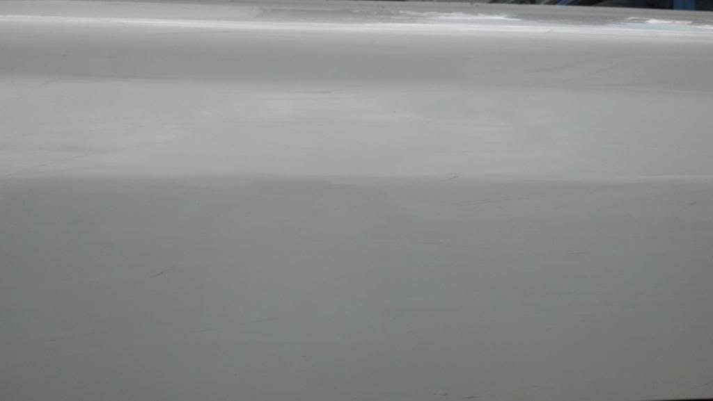

Even cheap products and a hand buff can get great results
I had to take the work truck down a narrow path with train tracks on one side and brush on the other.
This is what happened
I bought some cheap Turtle Wax compound and polish along and some hand buff pads.
This was the result
[/URL]
Note, that there isn't even any wax on in that picture. I was going to run out of daylight before I could get the wax on so I just snapped the pic as it was.
This was the result
[/URL]
