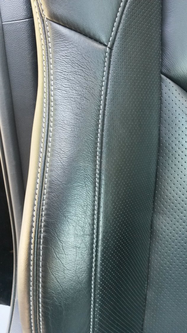

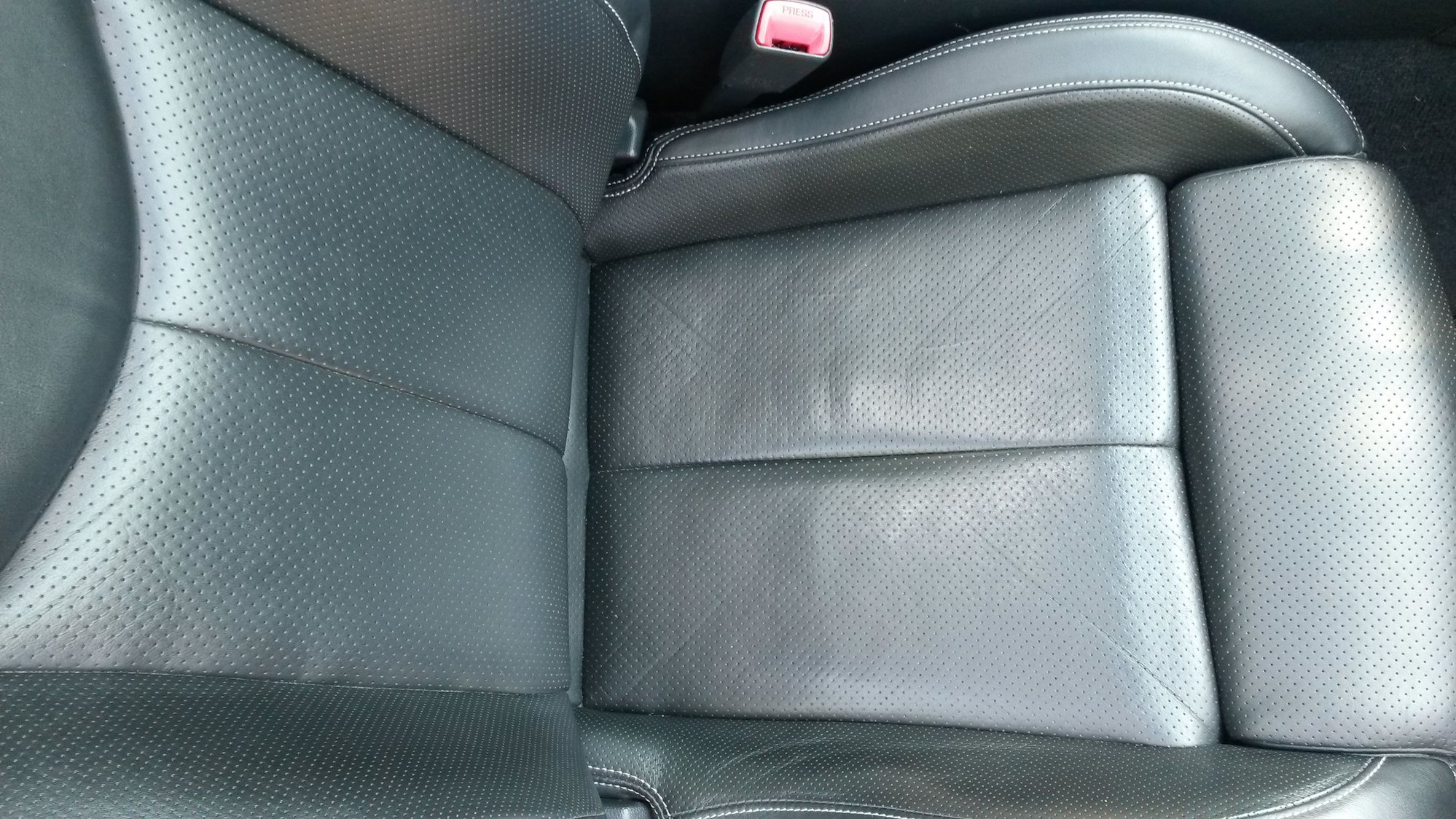

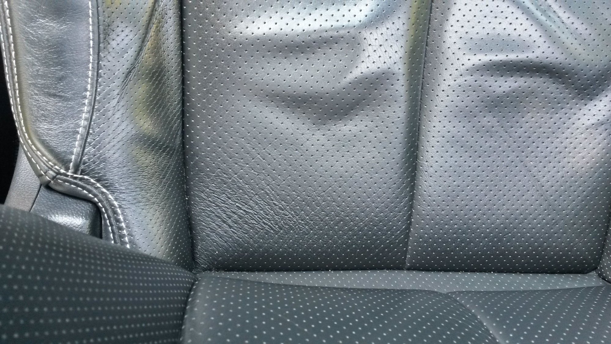

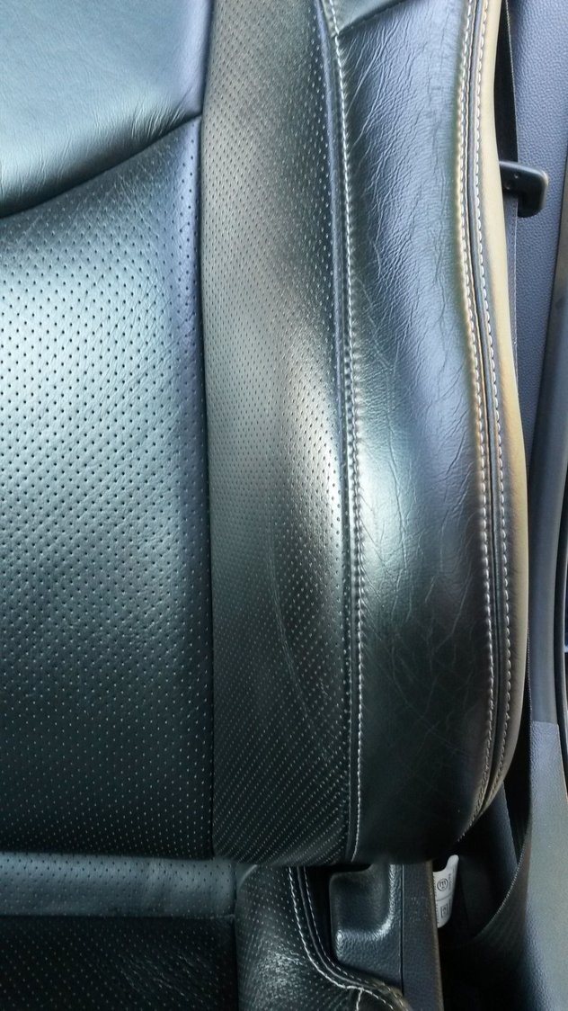

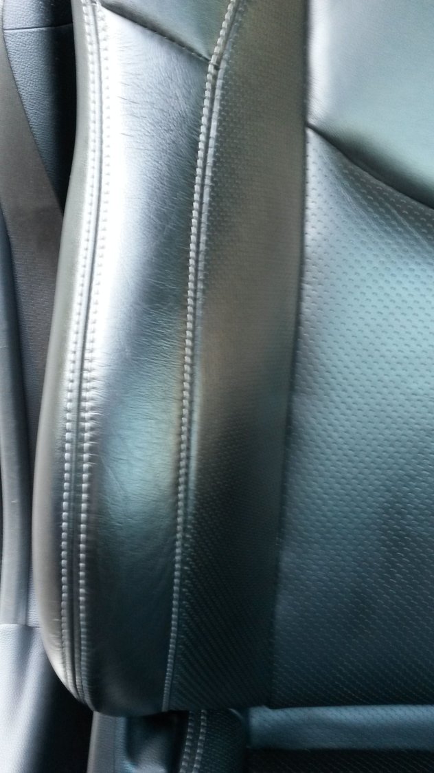

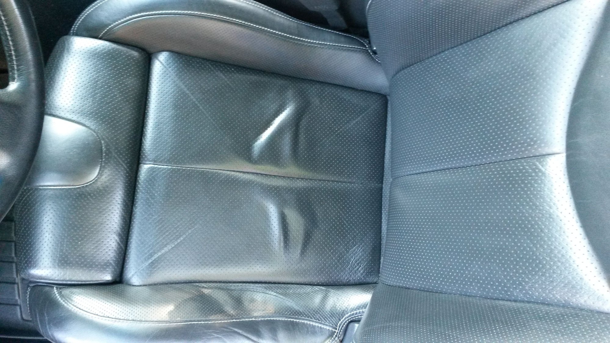

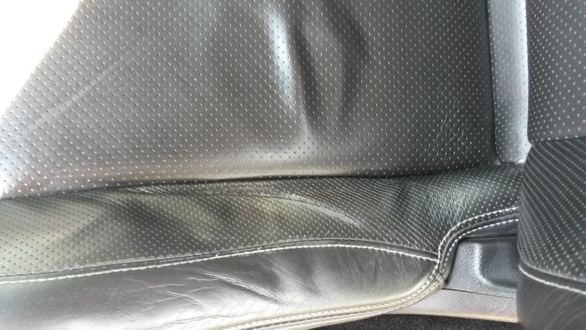

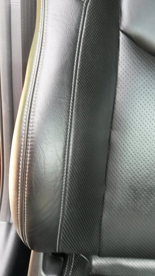

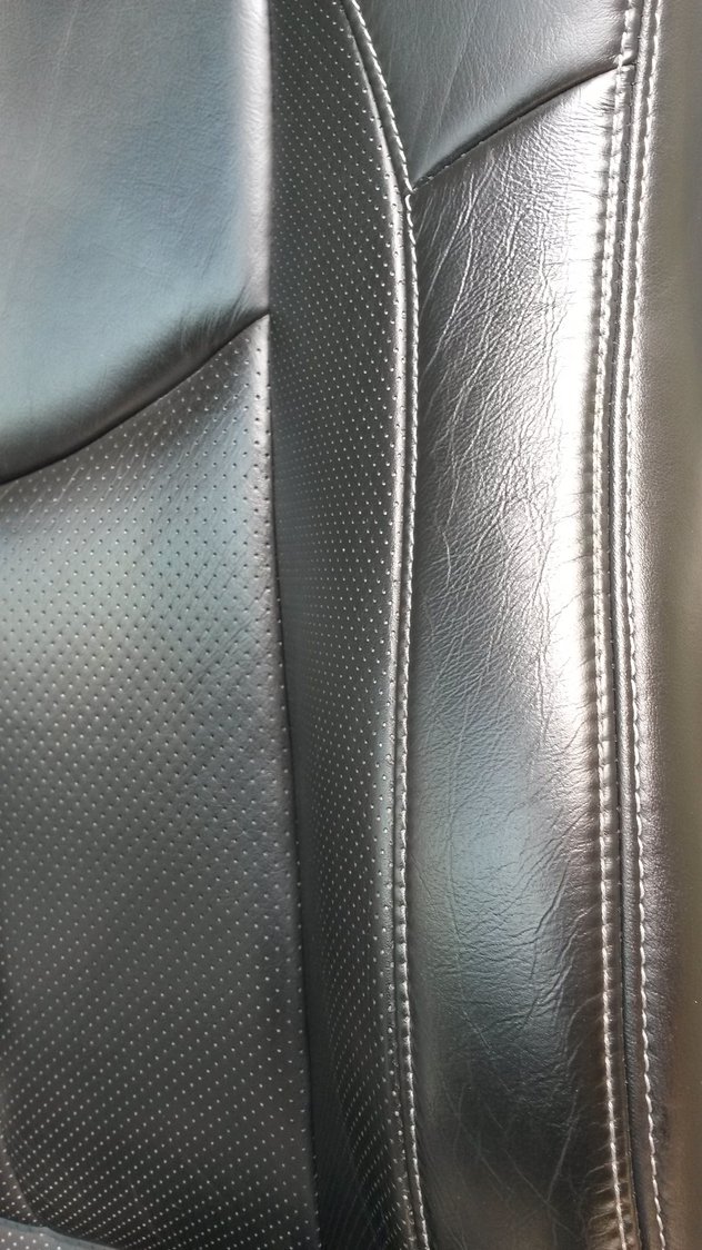

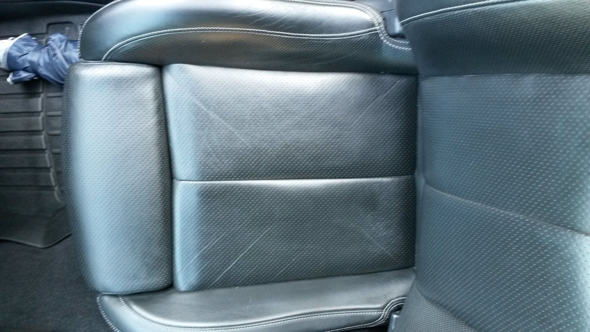

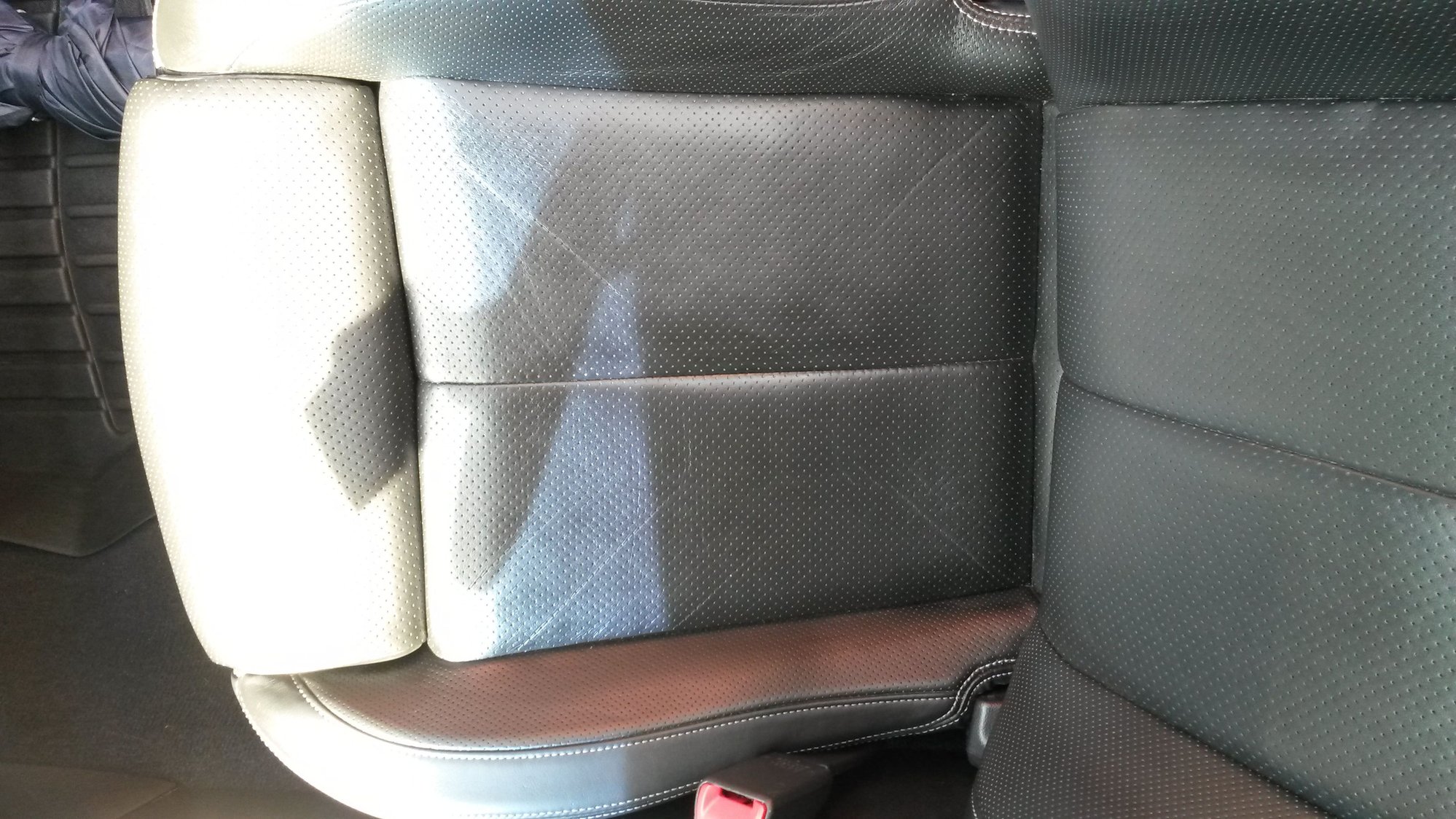

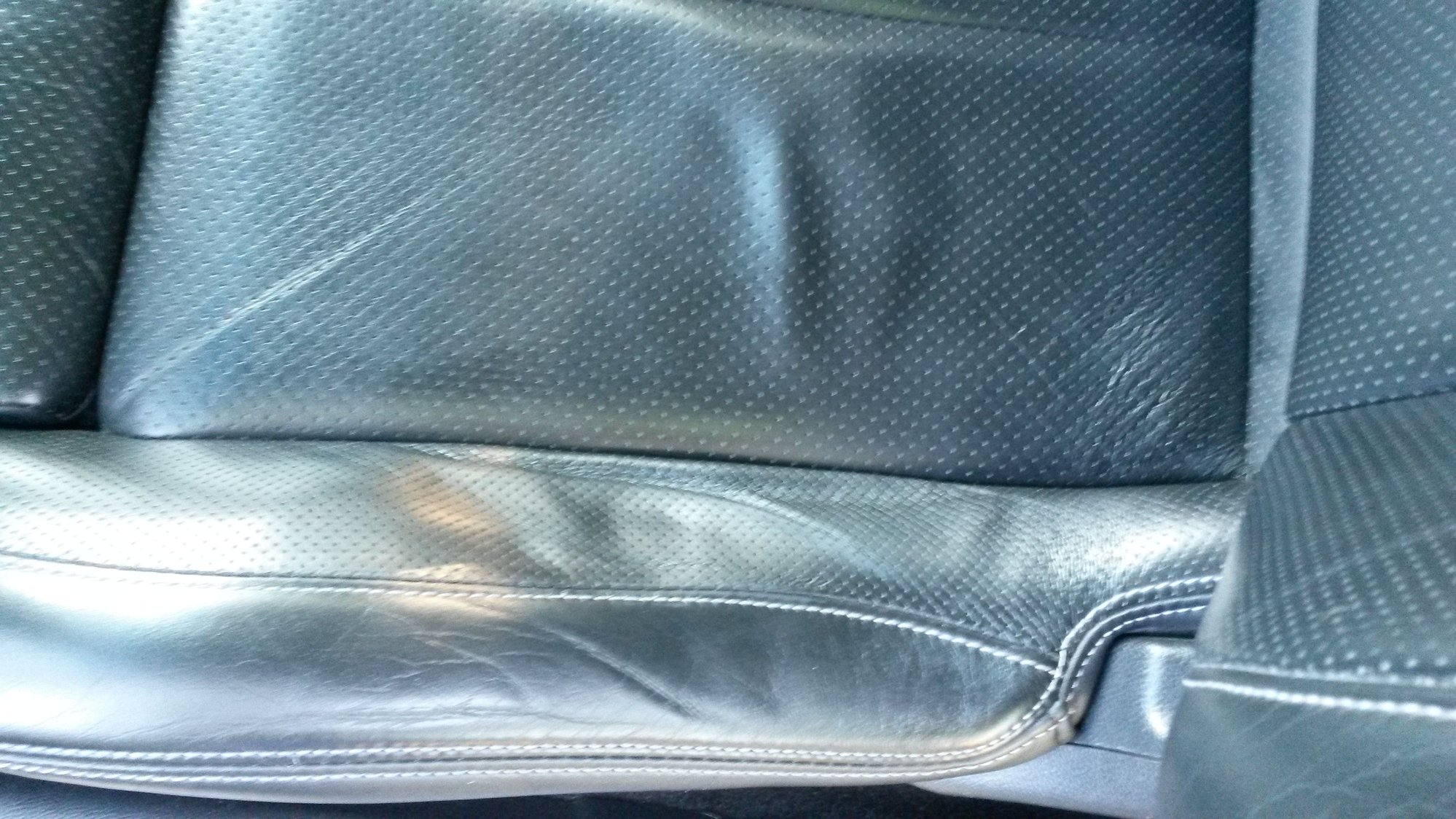

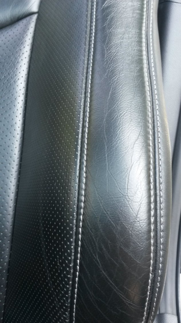

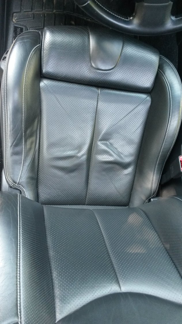

This past weekend was really humid so I decided to whip out the Leatherique that I bought a few months ago and give it a try. I cleaned the front seats with Meguiar's leather cleaner and applied Leatherique as directed on the bottle. Then I put a large trash bag over the driver's seat (to test if the effects intensify) and put the car out in the sun to bake.
After several hours of letting I wiped down the seats with leather cleaner and wasn't 100% satisfied with the results. They were better than before, but the driver's seat still had that very dry spot near the door, so I repeated the process, this time without the trash bag on the driver's seat, and let it sit overnight. It was a cool 60 degrees so the product didn't bake into the leather.
Overall I'm very satisfied after the second application, and it seems like time is more of a factor than heat/humidity, which helps the process. For the best results, I'd recommend leaving the product alone for an entire weekend if possible. This was about 16 hours of exposure to Leatherique and it definitely helped restore my seats to what the condition would be a few years ago.
I give it a 4.5/5 stars, only because it didn't completely unwrinkle the cracks in the side bolsters. But at the end of the day, this is maintenance of an old car, and it leaves me more satisfied than before.
driver's seat
before application
driver's seat
1st application
driver's seat
2nd application
driver's seat - dry spot
before application
1st application
2nd application
driver's seat - bolster
before application
1st application
2nd application
passenger seat
before application
passenger seat
1st application
passenger seat
2nd application
passenger seat - bolster
before application
1st application
2nd application

Leatherique is great. For the loose and wrinkly spots:
1. Put a couple damp wash cloths in a microwave safe container and microwave them for about 3 minutes to make them steaming hot.
2. Use tongs to place the steaming damp cloths on these problem spots. It helps for wrinkles, loose spots, etc.
3. Be amazed at the difference. Repeat as necessary.
