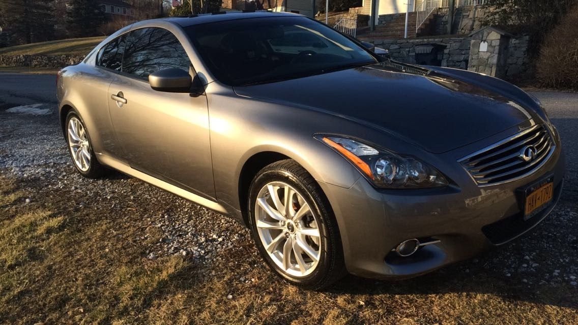

Here is a final pic. The paint is smooth as butter, no imperfections, swirls etc. Looks showroom condition. My detailer did an amazing job. Going back in 2 weeks for reload application.
