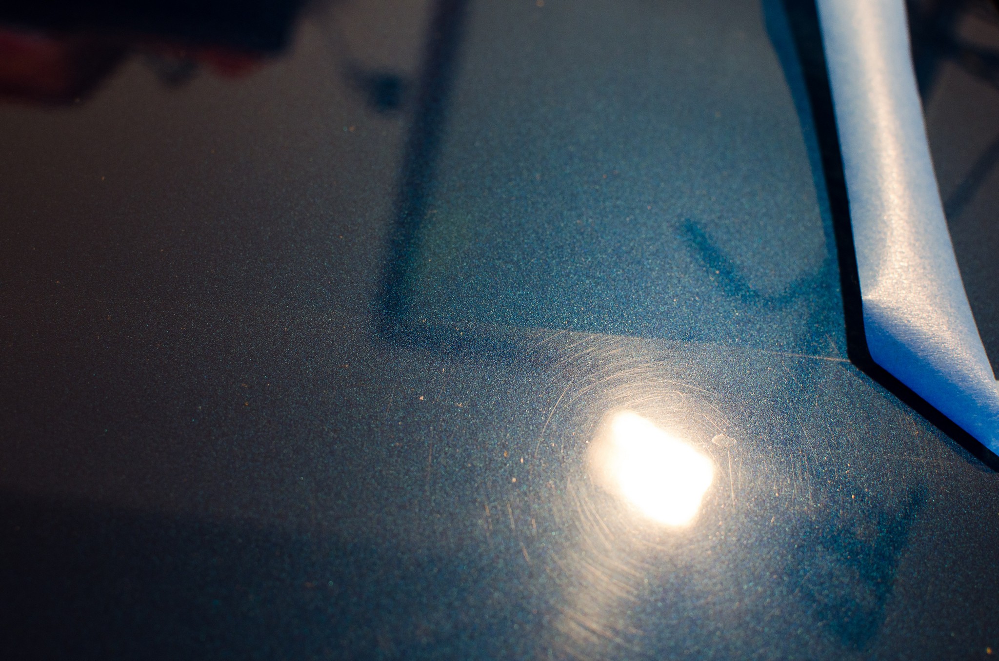

SF4500 is perhaps the finest polish on the market. This polish is designed for jeweling the paint to remove very slight haze, and not necessarily for defect removal unless you're working with incredibly soft paint.
If your vehicle is truly almost flawless as it is, you may not notice a visual difference from polishing. It is the flaws - ie swirls, marring, oxidation, etc that lead to a lack luster finish that can be revived with paint correction and polishing, however if your vehicle is already super glossy, there is not much room for improvement.
A product like Menzerna SF4000 will have quite a bit more defect removing power than SF4500, and therefore may produce a more noticeable difference if you've got swirls that need to be tended to. If the defects are deeper, you'll need to use something like Menzerna FG400 or even SC300 depending on the severity.

SF4500 is quite high in oil content, which makes it very smooth and allows you to work it seemingly forever without producing any dust on a clean pad. The abrasives do break down throughout the working cycle, but this doesn't mean you will be able to see/feel a difference when that happens as the abrasives are incredibly tiny (microscopic).
Polishing IS what gives your paint the most pop. A perfectly polished vehicle (ie free of surface imperfections) will look good regardless of what type of wax or sealant you apply to it, while a vehicle that is swirled and scratched will look poor even if you apply a very high end wax to it.
Polishing/Paint correction yields the most dramatic visual improvement compared to anything else you can do to the paint, however if the paint is already nearly flawless and you're looking for a bit of extra gloss, then the LSP will have some effect. Waxes, Sealants, and Paint Coatings all have their unique look to them.
Hope that helps.
