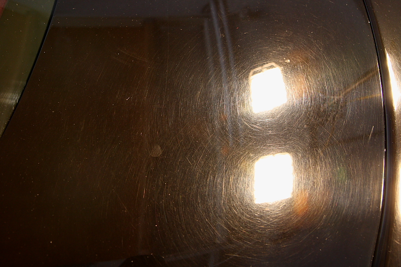

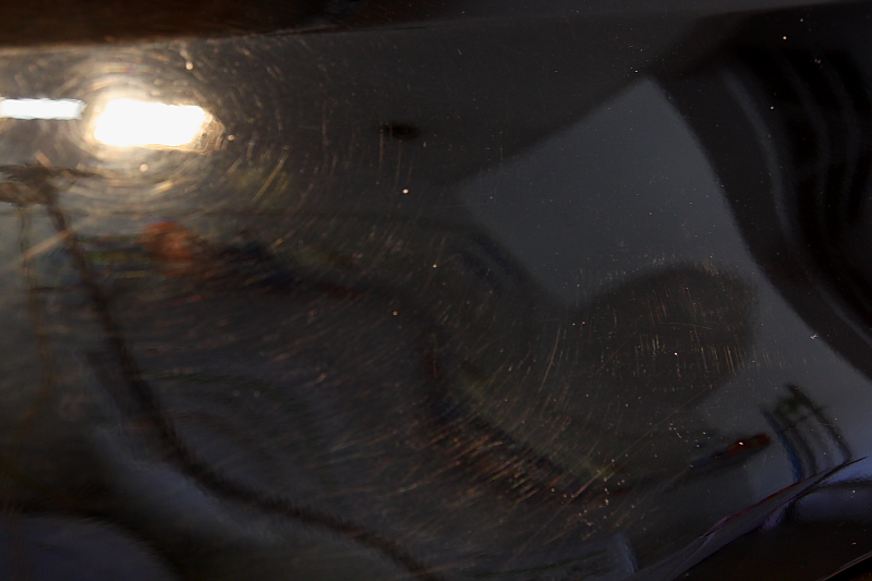

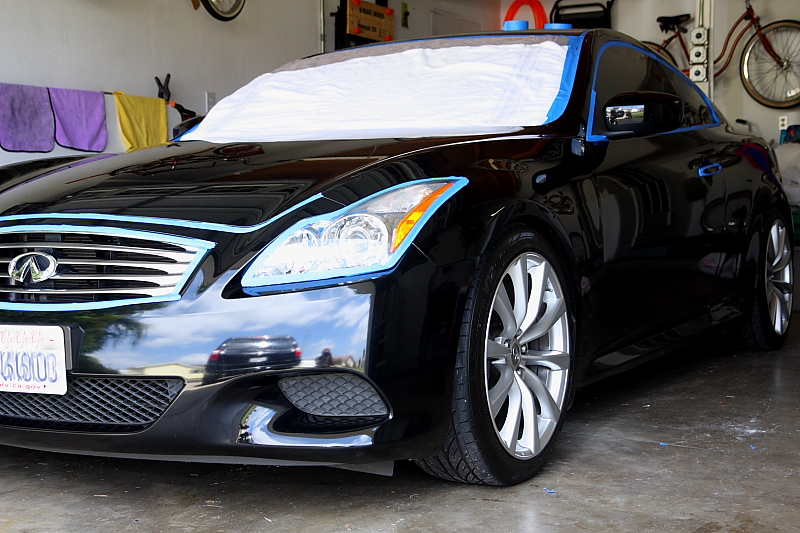

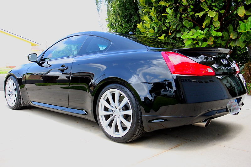

After many hour of hard work I finally got my G done.
This is my first attempt and it took me longer than what I had anticipated but really happy with the results.
Including prep work and clean up it took me about 14 hrs.
  • Wash
  • Clay bar
  • Prep (tape )
  • Swirls removal
  • Polish
  • Wax
  • Clean up

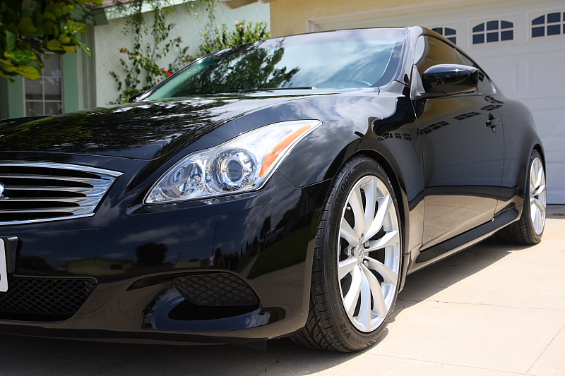

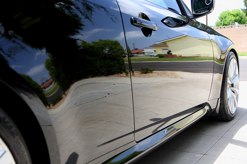

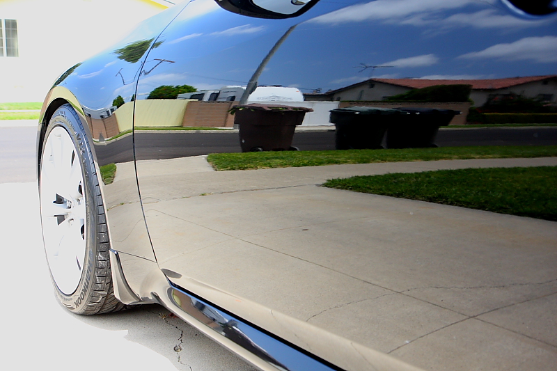

After:

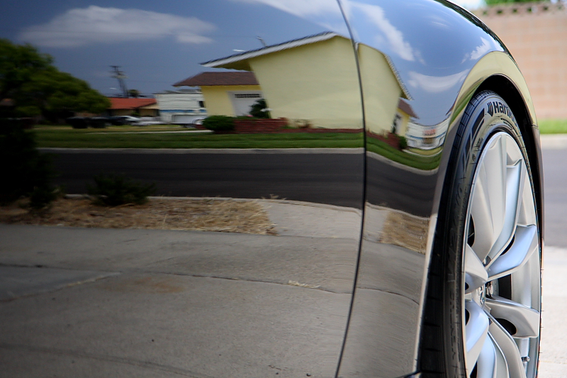

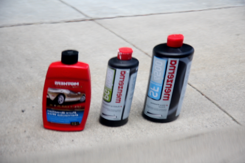

Items used:
  • Mothers California Gold Clay Bar kit
  • Porter Cable 7424XP
  • Menzerna Power Gloss Compound PG-1000
  • Menzerna Super Finish Polish SF-4500
  • Mothers Natural Formula Pure Carnauba Wax
  • A lot of MF cloth

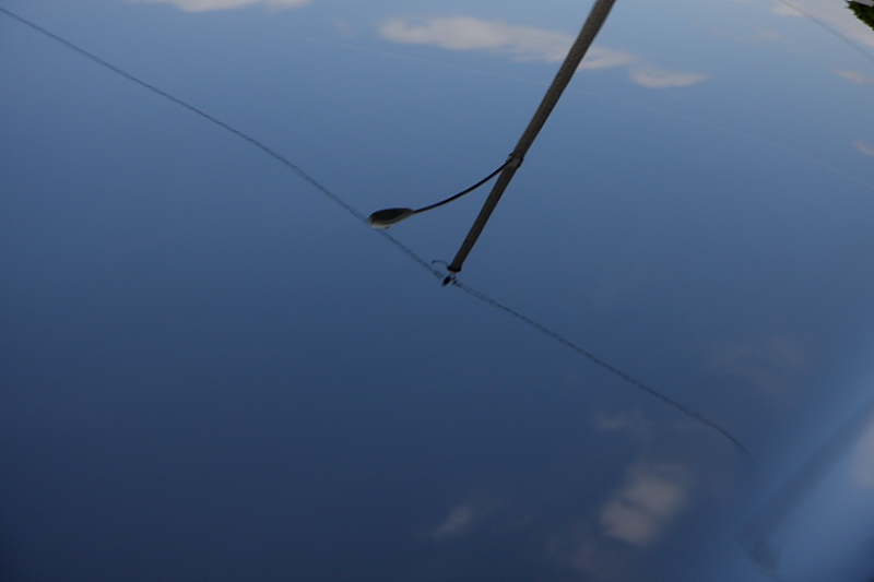

Job well done Gio. Were you able to get all the swirl marks off?
Old May 28, 2013 | 09:23 PM
Gio37's Avatar
Gio37
Posts: 1,397
Likes: 245
From: Happiest Place on Earth
Thanks.
All the swirls are gone, I just have to keep them off
There are just a couple of scratches not really noticeable but I didnt want to be too aggressive to try to take them out.

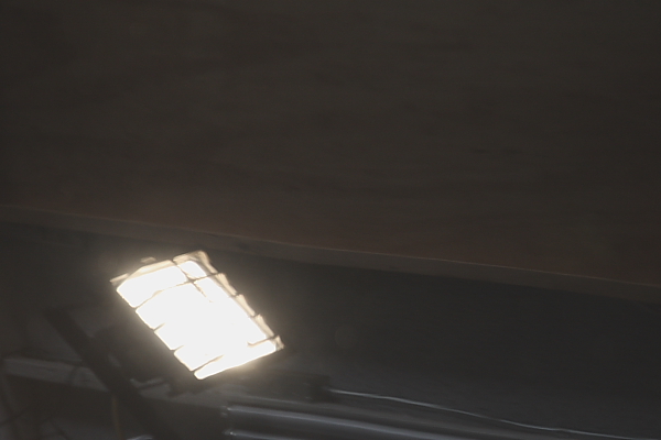

Here is another picture I took inside the garage with the light trying to capture any swirls.
