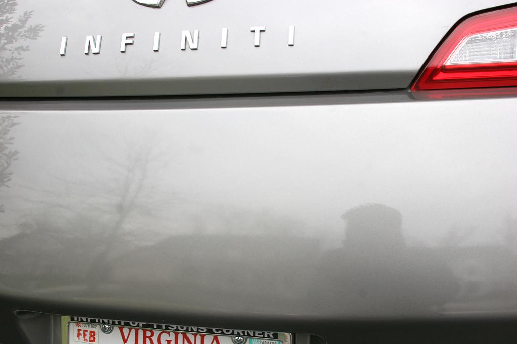

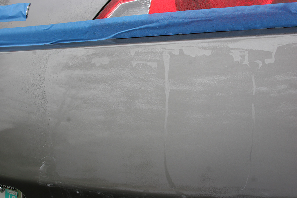

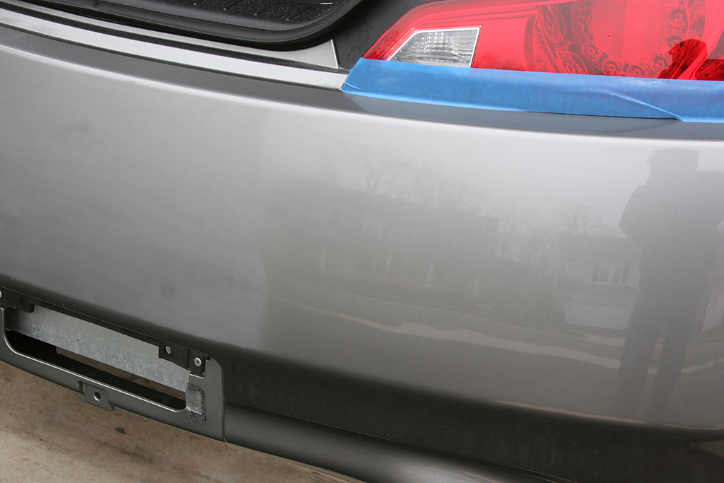

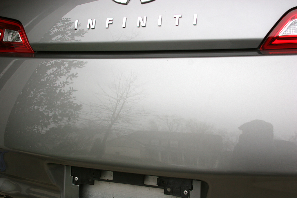

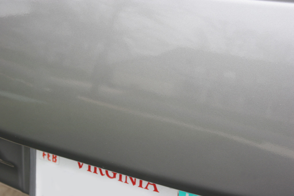

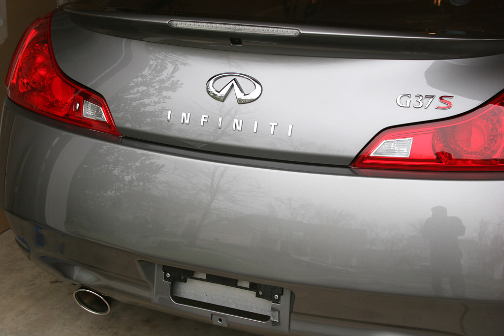

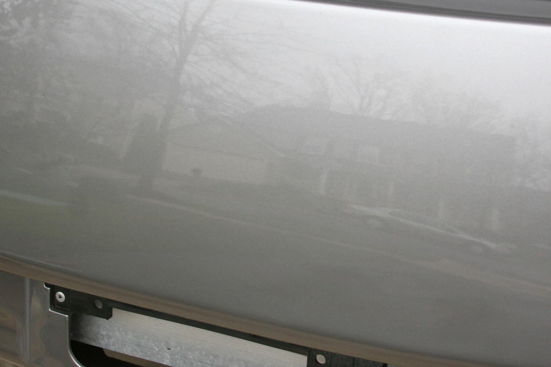

Ive had my car for a month and finally had some time to do some of the serious detailing it needed. The rear bumper on my 08 G looked dull and had heavy orange peel. Did a little wet sanding with 2000 grit, Meguires 105 and orange pad, Menzerna SIP, and Menzerna R85, topped off with Swissvax Sheild. Sorry for the bad lighting, very overcast in Northern VA today. I have before, during and after picks. I feel it is a big improvement and got a lot of the orange peel off. Let me know what you think!
In the 4th photo below I wanted to show what it looked like part way thru the wet sanding. You can see that I havent yet removed enough clear coat to get all of the orange peel out.

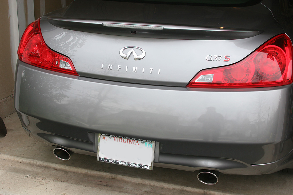

The after photos....

What grit(s) did you use?

Just used 2000...Original post updated.
