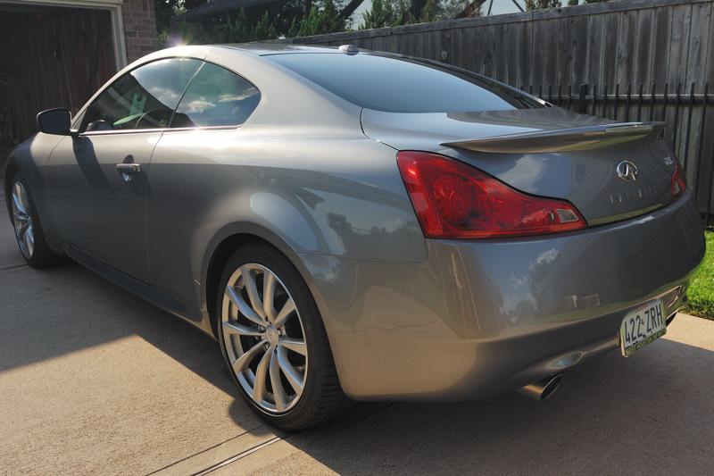

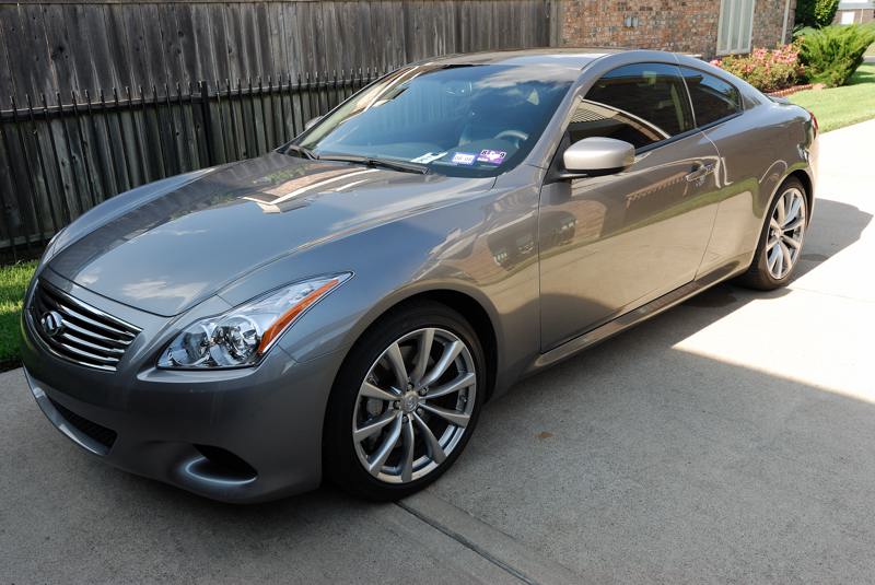

Sonus Fine Clay - Klasse Gloss Sealant - Sonus Paint Cleanser - PS21S works great! Sure other combinations do too. Paint cleanser and P21S really added a deep shine. Durability of the big shine will be limited I expect but Klasse stuff should be around a while for protection.
When i went to clean the wheels i was astonished to find no brake dust - fantastic!
Couple of gotcha's - door handle rubber entry buttons grab wax in tiny grooves and its a bugger to get out. I have some film like material on lower rear qtr panels and wax likes to get under that too. Easy enough to get out just a little added extra effort.
Noticed 2 or stone ships on front bumper already after only 800 miles. I'm going to explore paint protection stuff I think..Anyone got any suggestions?
