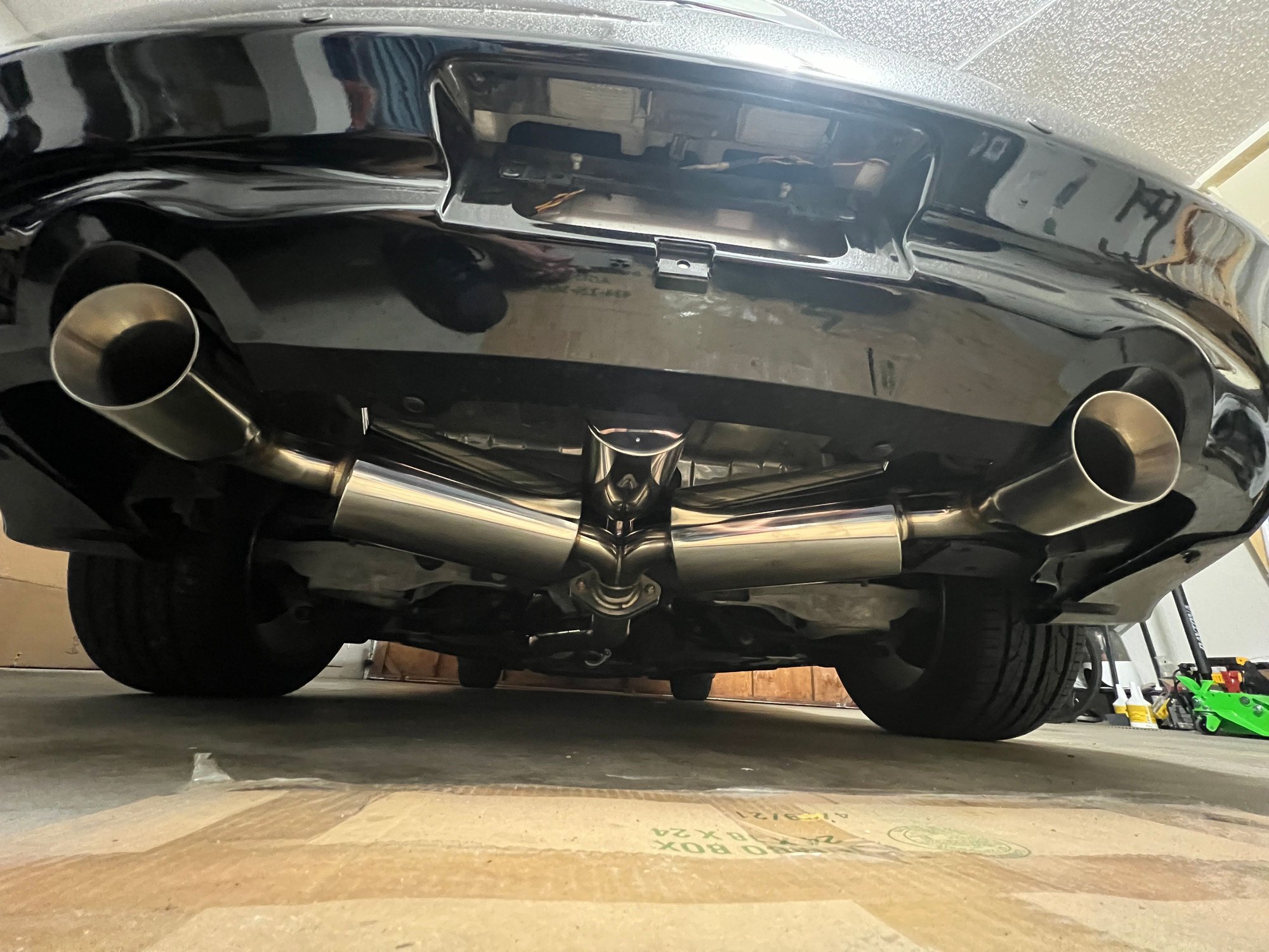

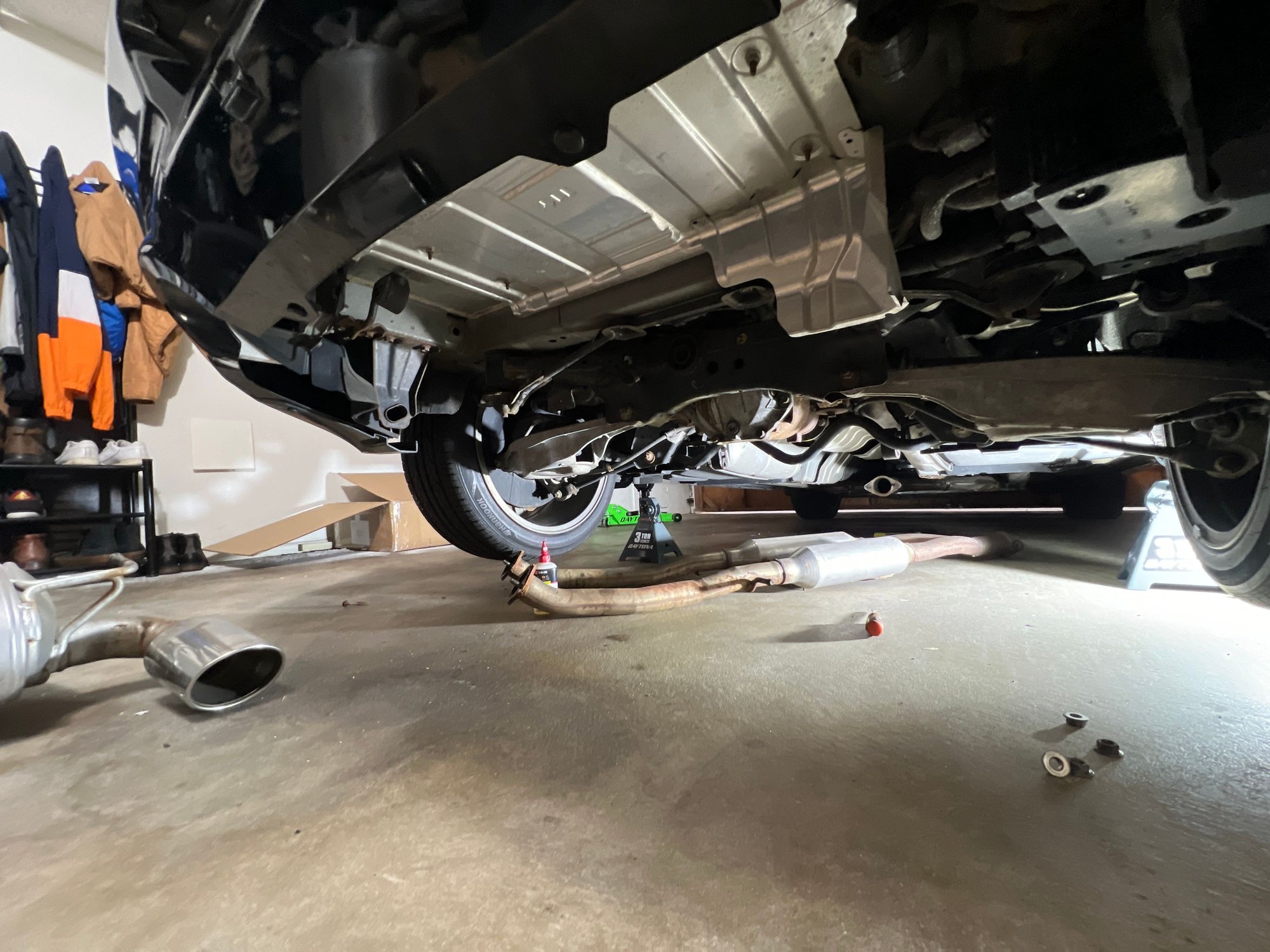

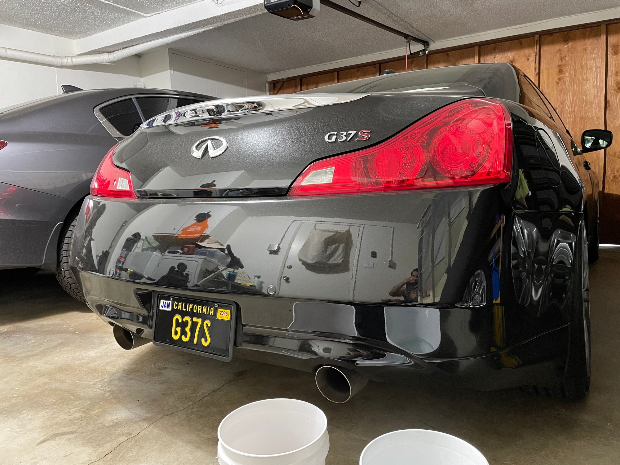

Here is a picture of the Beluga Y back exhaust during and after install:
And a few installs along with my thoughts from the last week of March:

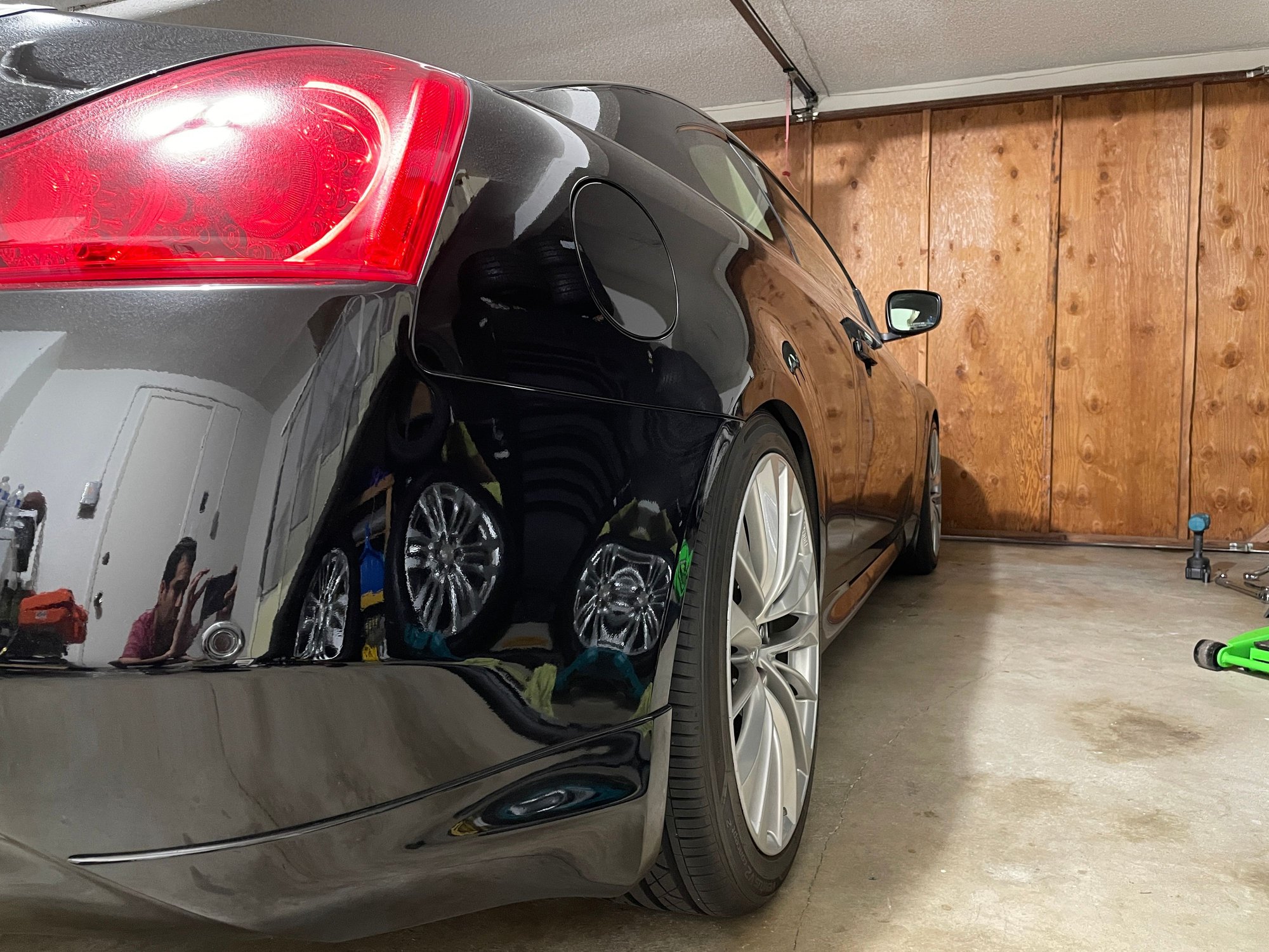

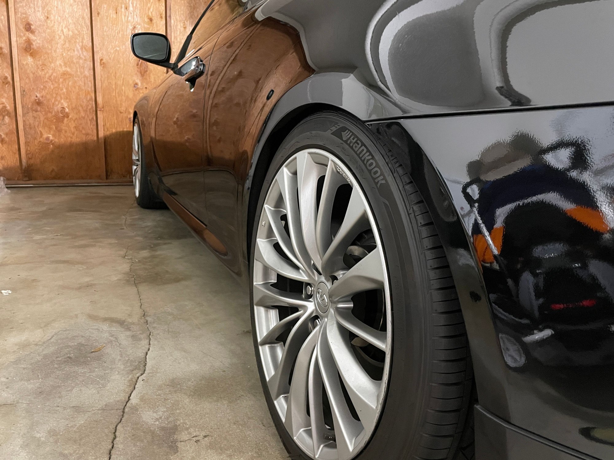

- Clutch pedal return spring replacement with lower spring rate. It was an easy install and the improvement in feel was decent (10% - 20% if I had to put a number to it), I don't think I'll be itching for an upgraded clutch pedal assembly any time soon.
- ISR Y pipe. A few weeks ago I got a Beluga Racing Y back exhaust (~$530) that is originally made for the 370z, however it is offered for the G coupe with the addition of an extension pipe connecting the Y pipe to the mid pipe. Initially I was running the OEM Y pipe and this was somewhat hacky given the inlet diameter for the BR exhaust is 3" versus the smaller OEM Y pipe outlet. In general this exhaust is pretty modest, but with the OEM Y pipe I felt like it needed maybe 10-15% more volume for it to be perfect. With the ISR Y pipe ($250) installed the sound is both deeper and just a little bit louder, and I'm very pleased with this setup. With my butt dyno it also seemed like throttle response and/or mid range torque had improved making the car feel more responsive.
- OEM 370z front springs. I kept mulling over getting Swift lowering springs but I couldn't justify spending $400 on them given how much time/money I had been putting into the car since getting it (ask my wife). Despite this I wanted to do something about the front wheel gap and after doing a bit of research learned about the 370z springs. I found a pair of front springs on eBay for about $60 shipped expecting a drop between 0.5" to 0.8" based on what I had read, and I was prepared to cut the rear spring perch in case the springs dropped even more. Me being a cheap ***, I chose to reuse the front struts and spent a couple of days installing the springs. After one side was done I tried to compare it to the other side and couldn't see any difference... welp. I trudged along, got the other one done and was pleasantly surprised to see both fender gaps reduce by enough to make the front and rear fender gap difference virtually indiscernible, which was ultimately my main goal. As far as how it feels to drive... I would say the car feels just slightly more taut (in a good way) but ride quality really doesn't feel any worse. For $60 and being sore from the install, I'm really happy with the results. Note that using brand new 370z replacement front springs is also an option and inexpensive (~$40 each non OEM) but I opted to go with what folks have already reported on. I don't think an alignment is in order, but we'll see.
Pics:
Top right is more zoomed in, makes the gap look bigger. Front still has a hair more gap vs rear, but it is much improved.
Link to a shot of the car before the front spring install. I'll try and get a similar shot of after.

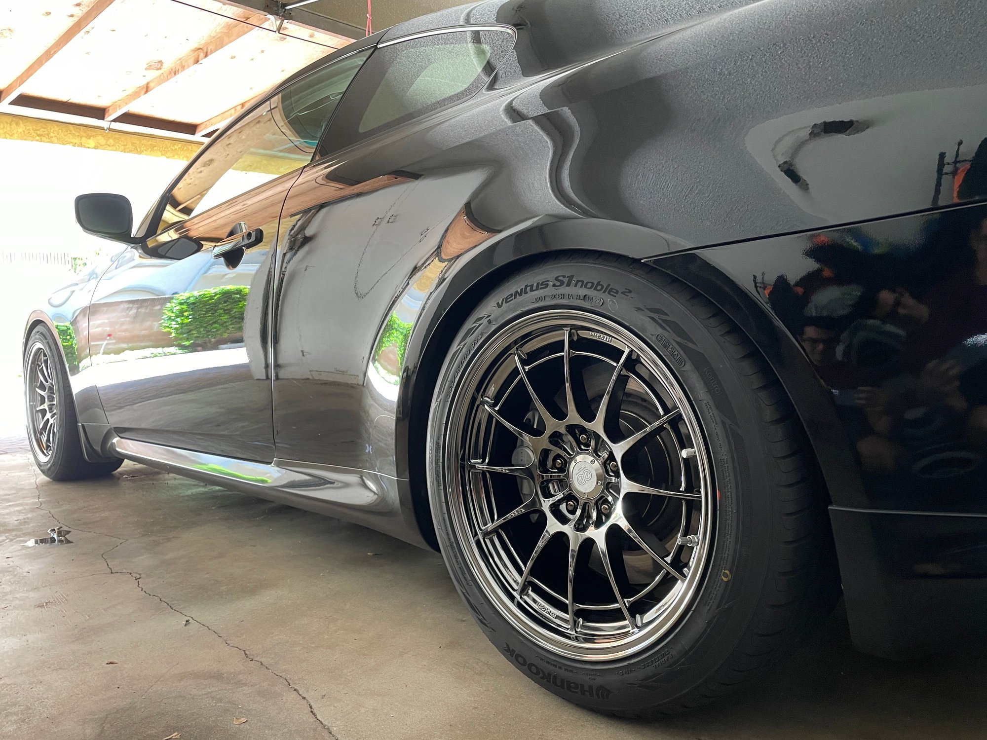

I just placed an order for a set of Enkei NT03+M in 18x9.5 +27 with the SBC finish (Special Brilliant Coating) and a square set of Hankook Ventus S1 Noble2 in 255/45r18. I got everything for a pretty good price all things considered, though there is a 2-3 month wait for the wheels. With the NT03s weighing in at 20 lbs, the total weight up front should turn out 3-4 lbs lighter per corner compared to stock (despite much wider tires) and the rear should turn out about 5-6 lbs lighter. I imagine this will provide some improvement in driving dynamics all around and I get to stick with Enkei. I'm going to go on a limb and call it OEM+ (cosmetics aside). I don't really drift but I like to peel out every now and then, so I'm wondering how this setup will fare in regards to traction. Total diameter will increase but its negligible (<1%), although for a moment I kind of wanted to go a bit larger in diameter since my speedo seems to be reading fast by some 3-5%.
According to my research, I'll have to run a ~5 mm spacer only up front to clear the brakes but its a big improvement over the 25 mm spacers I'm currently running (all around) with the stock setup, haha. I'm still not sure whether I want to lower the car any further, with the 370z springs up front I think it looks "factory perfect" but sometimes I itch for a slightly more sleek look. The Tein H-techs are pretty inexpensive, I might just swing for a set of those to try out even before the new wheels. I just made an order for Tein H.tech springs. I realize they have fairly low spring rates compared to swift and stock. In theory this would provide more grip at the expense of handling feel, but I’ll give a review once I get them on the car, let it settle, and do an alignment.
Once I get the new wheels I'm going to move my original sport coupe 19s with the new Hankook Ventus2 Concept2 I got in February over to my 2017 Honda Accord Hybrid. Not sure what I'll do about the center cap but it'll be a massive upgrade cosmetically to the EX-L hybrid wheels...
I’ll be getting the Tein H.Tech springs in the next couple of weeks and will try to install them before the end of the month. Tangentially, I’ll be picking up a 52 x 21.5 inch Husky tool chest with top box set up from my father in law around the same time, which works out since I’ll have the family car out of the garage for the lowering spring install and can move it into place (as well as start organizing my tools).

That center-piece for the Helmholtz resonator on the Beluga exhaust is such a cool design. Love that look.
Your coupe looks exceptional.

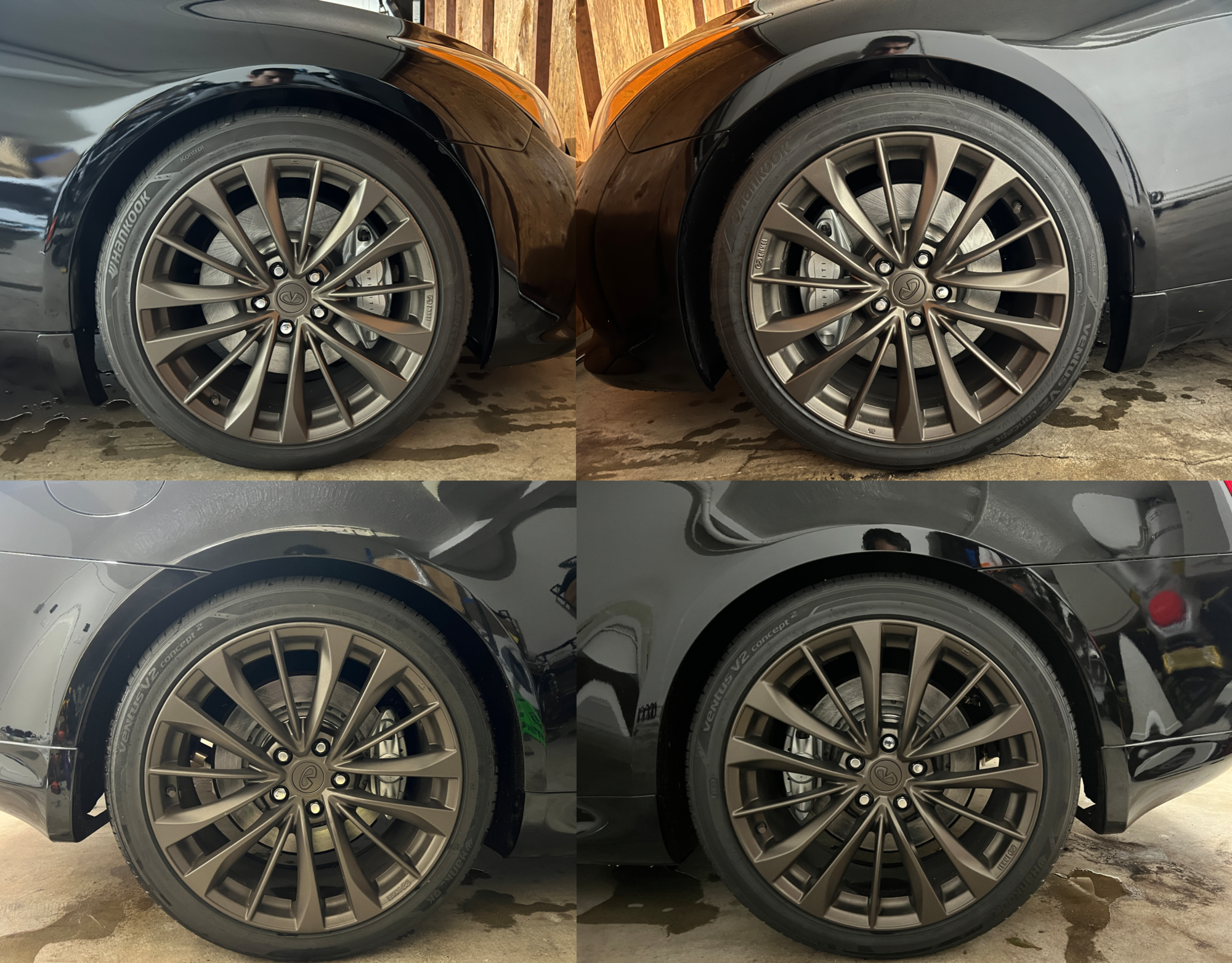

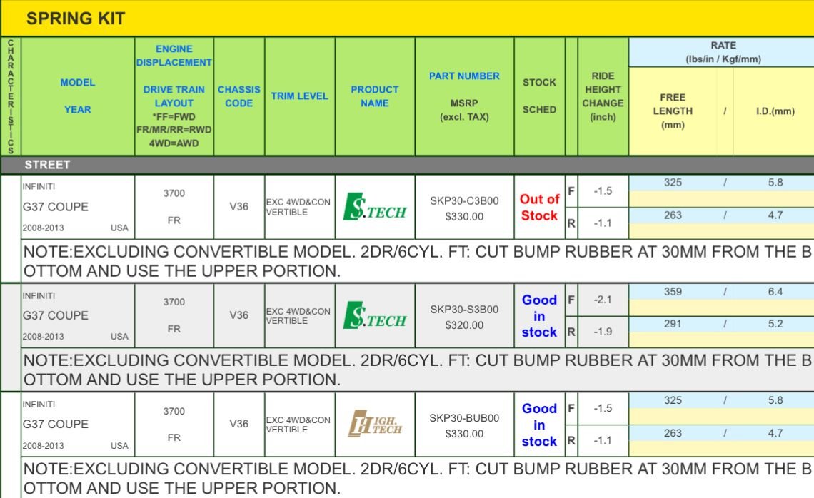

Well, I wasn’t able to get the Tein lowering springs in time to install them before June came. The vendor I purchased them from gave me a 4-6 week lead time and I purchased on May 11th.
Fortunately I received the springs today but much to my chagrin, they were Tein S.Tech springs. I was writing an e-mail to the vendor and as I went to look up the part numbers on Tein’s website, I realized that they actually have two different S.Tech springs for the G37 coupe, which are SKP30-S3B00 and SKP30-C3B00.
I was happy to find that the ones that I received were the SKP30-C3B00, which have the same exact ride height change and spring rates as the H.Tech springs. The only physical difference is the color. I think I’d have preferred gold, alas I will settle for these since they’ll never be visible anyway.
I had waited long enough to get the part, so at precisely 8 PM I became determined to install the springs, replacing the 370z fronts and the OEM rears. I got it done in about 4.5 hours.
My initial impression was that I was slightly underwhelmed as the drop seemed so small that it was hardly noticeable. Okay, so at the brisk of half past midnight I went for a drive to see about the ride. I was pleasantly surprised to find that ride quality was also difficult to notice a difference in. Waste of money? Maybe. As I carried on with my 20 minute drive I started noticing maybe a slightly bouncier ride, which makes sense given the lower spring rates compared to the previous springs. On smooth pavement the ride was really nice, on rougher pavement the ride was only a hair bouncier. On a couple of quick turns I heard a faint scrape/rub sound. Oh.
I get home and park the car in the garage to have another look before calling it a night. Boom, all fender gaps eliminated. Ride quality notwithstanding, this looks GOOD.
I figured I’d pull out the tape measure for, well, good measure. The rear fenders were a consistent 26.125 inches from the ground and the front fenders were 26.5. This is probably about as low as I would ever want to go, though I expect the springs will settle a bit and these numbers will drop slightly. Tein says they warrant against more than 5 mm, let’s see what happens.
I don’t know if I mention it in this thread but my CV36 is wearing 25 mm spacers all around, and I think this is just a hair too much to avoid any rubbing whatsoever, which I’m okay with for the time being (won’t take the spacers off, can’t hang with the look of tucked wheels). I’m not sure how the wheel and tire setup that I’m waiting on will fare with these springs but I’m hoping for the best. In the worst case, I’ll pony up and get some decent coilovers to be able to raise the ride height a bit and address the bounciness, if it gets to that.
Part of me wonders what if I had gotten Swift springs instead. I think those have a slightly milder drop which I might also consider switching to. I had them on my 2013 Journey sedan and enjoyed them. I’ll give the Teins a fair chance though. They were <$200 before taxes after all.
The things we do…
edit two days later: I’ve driven around a bit more and I haven’t rubbed again yet so maybe the fitment is just right. As far as the ride quality second impression, it’s really tough for me to tell a difference compared to stock (before the 370Z front springs) so I’m pleased with this setup. Alignment seems to be fine as well but I will get an alignment in the next couple of weeks to be sure.

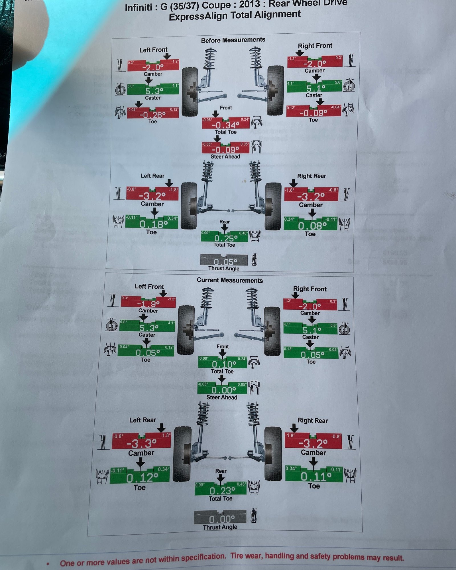

Yesterday I went to get an alignment after nearly two weeks since installing the lowering springs. I certainly didn’t feel like it was super necessary as far as driving impressions go, but after getting the before/after sheet, I saw that the toe at the front was a bit too out of spec beforehand so I’m telling myself it was necessary and worth it.

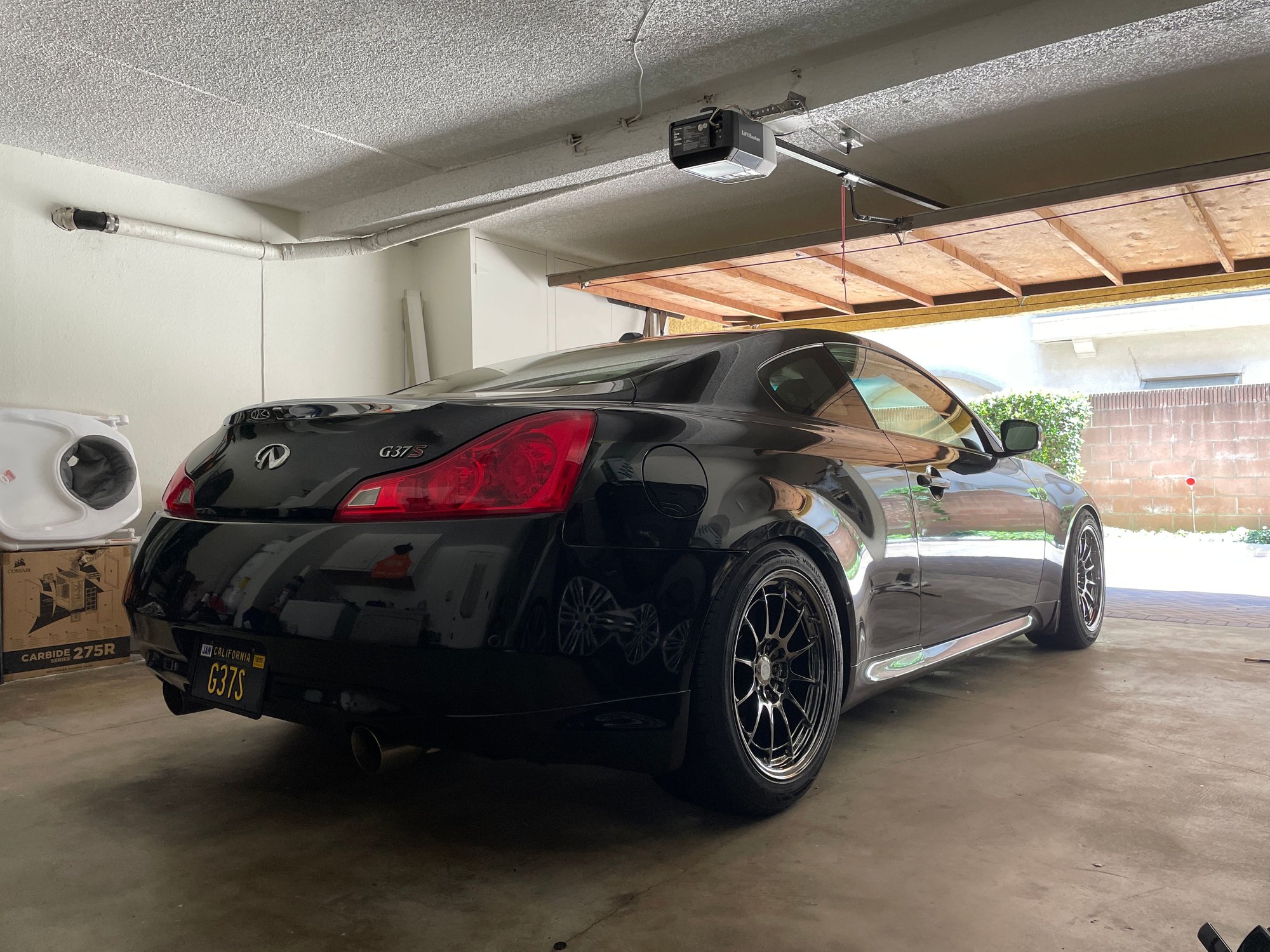

I recently installed LED turn signals both front and rear. These cost me about $48 for each pair from Lasfit. As of this afternoon I’ve also installed 6000K HID bulbs from Diode Dynamics. I am hoping these match up better with the LED foglight’s in white mode (they’re switchbacks).

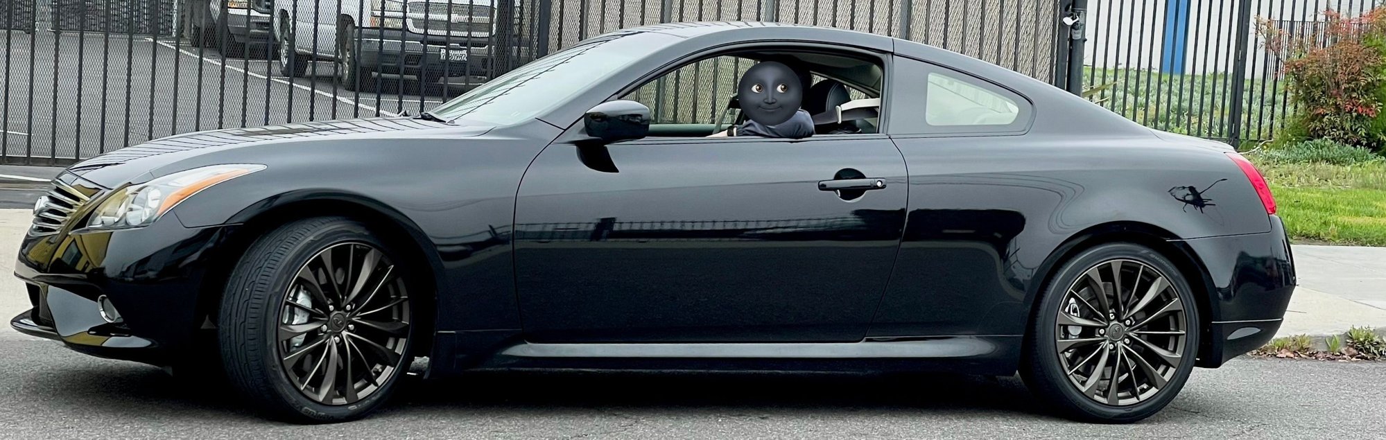

Also, after about three months of waiting I received the NT03+M in SBC. I had my usual shop do the tire mount and balance and asked them to throw on some TPMS that I bought used for a cheap price, though they didn’t have the tool to do the programming. Fortunately I was able to find another shop that took care of it free of charge.
Here are a couple of pictures. I removed the 25 mm spacers that I had on with the original wheels and installed 3 mm spacers up front for clearance. I think it looks pretty great, despite the car being a bit dirty and lack of tire shine.
As far as driving feel, it seems maybe a little more light on its feet although turning requires just a hair more effort. I also find the tire noise to be noticeably worse but not a big deal, I guess going from 225/245 front/rear to 255 all around could have contributed to this.
Overall I’m really happy with how the car sits and drives. I installed about 2/3s of a grounding kit as the factory grounds look a little worse for wear. No obvious improvement in anything but its peace of mind.
The other day I purchased an Injen throttle controller (from a fellow forum member) to see how throttle response might be improved, as this has always been somewhat lacking. Beyond this I don’t expect I’ll be doing much else with the car but driving and staring at it.

Stance looks fantastic in those pics. Nice meaty tires without being too fat. It's a good look.
When you say "installed LED turn signals", you mean the bulbs, right? How did you avoid the heat and the hyper-flashing? Or is that no longer an issue with today's turn signal LED's?
