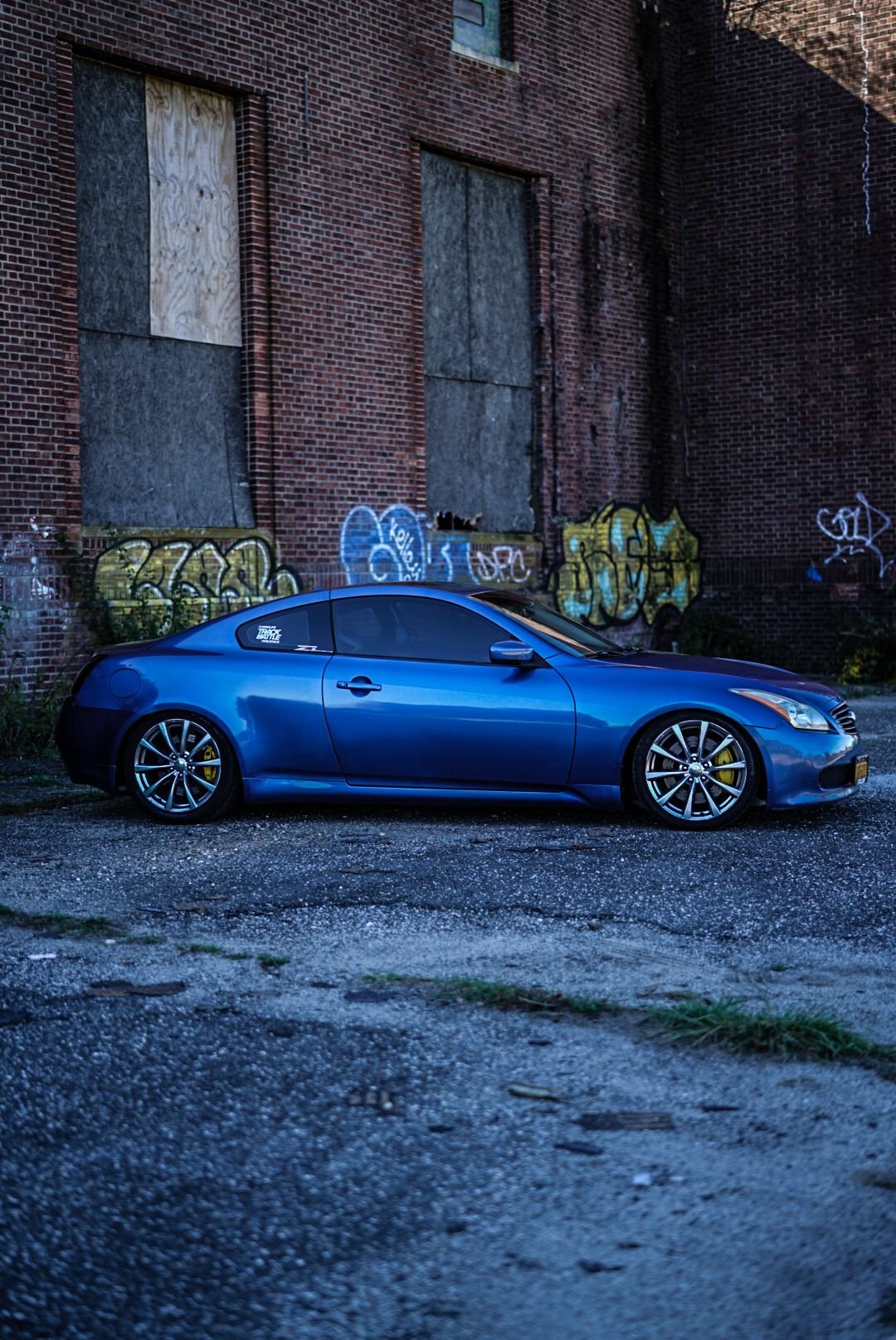

Hey Everyone, surprised it took me so long to actually make a build thread but I figured its never too late to start. My social media is Code_Blue_VQ if anyone is interested in taking a gander on IG. Anyway, Ill give a little background on the car, how I ended up with it, and whats been done and where we go from here and in the future. In the end I hope the car will take on the final form of daily/track car and be the best an NA build can go, unrealistic perhaps but a healthy balance for me of both will suffice.
History: I ended up with my golden nugget back in December of 2018. I originally whipped around in my Mk1 Audi TT that had some tasteful engine mods and a massive FMIC . Unfortunately the timing belt broke right before the scheduled maintenance and bent the valves and that was the end of that. I immediately looked for something else and ended up with a 04 G35 coupe which was nice while I had it but was close to 200k miles. I was a little worried about how long a VQ could last (didnt know any better) and I had no idea how the maintenance history was prior. So I decided to sell it and look for something new(ish). I found my G at a salvage auction and decided to take a gamble on it. It was in the lovely B21 paint code, it was an 08 and had 46k miles on the clock and at the time was less than 1500, crashed in the front and the back but was repaired (not to my liking but everything was straight & besides salvage ) So I pulled the trigger and boy has it been a journey!
Good Ole MK1 TT and next to a friend, oh those smiley front ends :-D
At the time I lived in the Bronx (next to yankee stadium) so for 3 yrs she endured awful nyc traffic and mindlessness. She's been on long hauls to Maine & Ohio, quick runs up the Catskills, out west to Philly and out east to the Hamptons. I moved to the deep end of Long Island in the summer of 21 (avoiding the fomo of the real estate boom) and I have to say since then, the G has enjoyed her own parking spot and garage and also more space for more spirited and competitive driving. In the 5 years of ownership Ive managed to put on 30K miles where the clock currently sits just shy past 76k miles. The car has had meticulous care in terms of maintenance and hopefully I can continue to do so.
Mods: In terms of mods the car has had some things done over the years but there is more to do. Below they are listed in a chronological order but, I will leave out cosmetic mods for now lets focus on performance!

The All Important Dyno Sheet...
As of Now 2/2/23: The car was tuned on UPREV back in 2020 by RT Tuning with a whopping 324whp and 261wtq I was very happy with this. The car drives well and is currently in an evolutionary process. The original 5sp Auto had issues with the valve body and eventually the torque converter decided to exit stage right. I am currently in the middle of a trans swap from Auto to Manual its just been very cold to actually finish everything. When I am done I will do a write up and post it with a full cost breakdown. Yes I know people would say I should sell and buy a manual, however with the current prices of used G's in the market, some in horrid condition & asking way too much, I went with this route instead. Time consuming and tedious but will be satisfying when done. I will retune on Ecutek when done and install the rest of the parts once some life events complete for myself. I have plans to redo the interior especially the ailing dash, deleting the sun/moon roof, replacing and coating the underside of all rusty bits and some other bits and bobs. The gallery gaskets will be done when I decide to do the cams. I know some will say that I should have just bought a manual 370Z but again it was not an option given the current used car market trends in the north east. I will continue to post updates as they happen and if I am able to, will try and make a video on the trans swap.
Please feel free to ask away and I will try to answer as best I can. Thanks for taking the time to give it a read. I know there are way more interesting builds up here but, I appreciate it nonetheless.
The current iteration of the G
I would look twice at that. And then maybe again, and a fourth time.
And then I'd get your attention to talk to you about your car, and that would have been a long conversation for sure. A 6MT conversion is hard-core dedication to this project.
I've got a friend up in Canada with an '08 G37S 5AT, same color, low miles, babied like a new born. IIRC, the '08 5AT had the same rear gear ratio as the 6MT.
