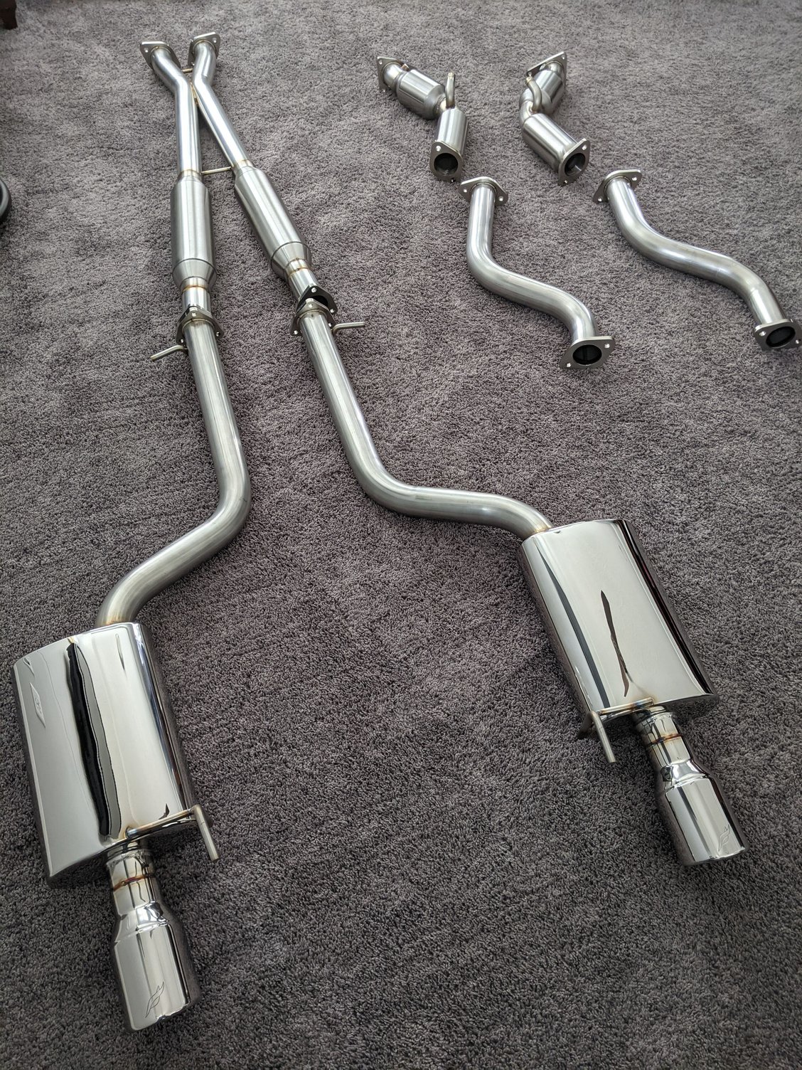

The exhaust I ordered in December came in today. It looks amazing and well worth the wait. It is Fast Intentions resonated high flow cats with 2/12 exhaust with 18" resonators. I had them weld in extra bungs for wide band O2 sensors for later down the road when I go forced induction. I hope to spend the day in the garage on Saturday installing this.

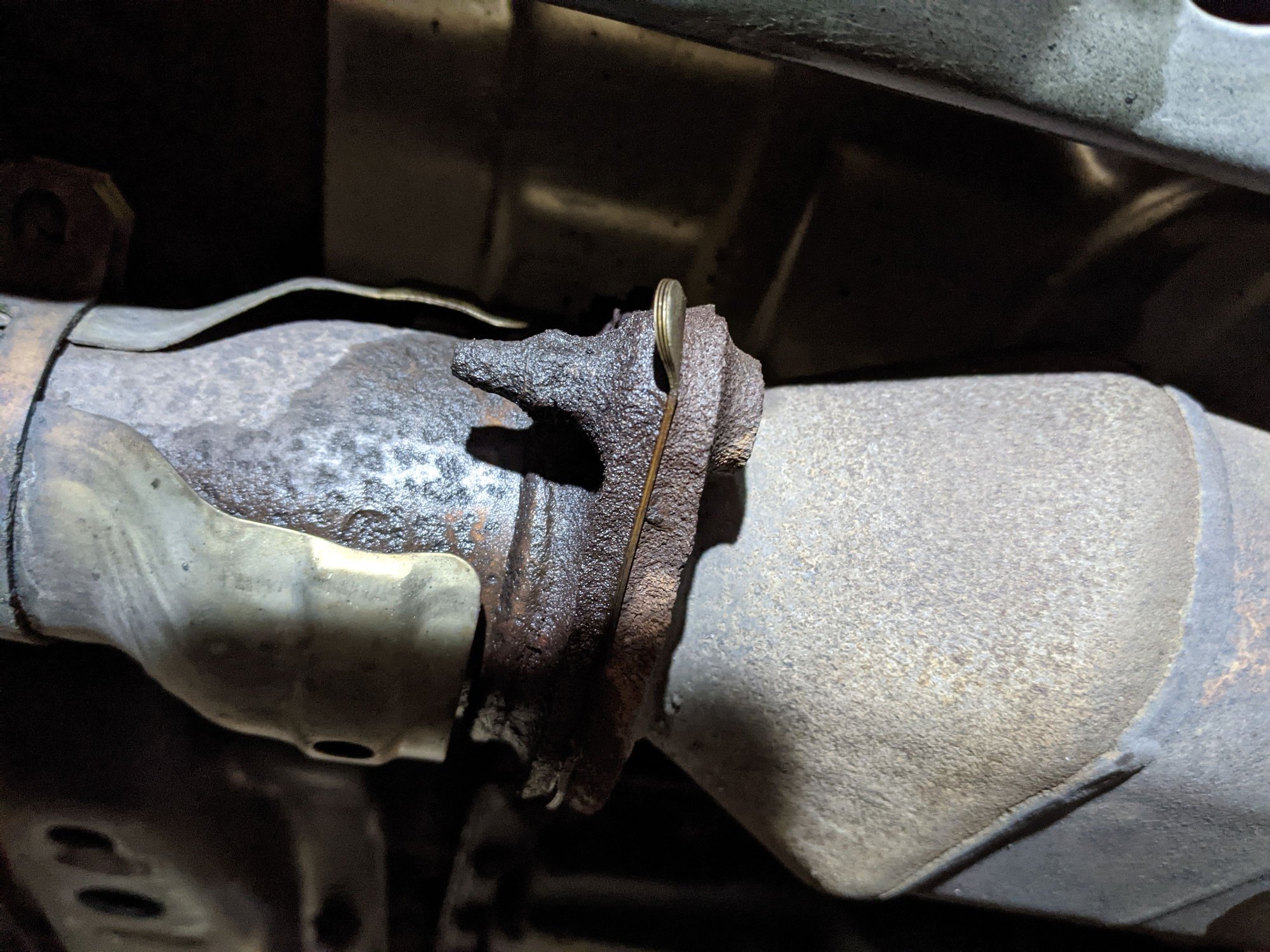

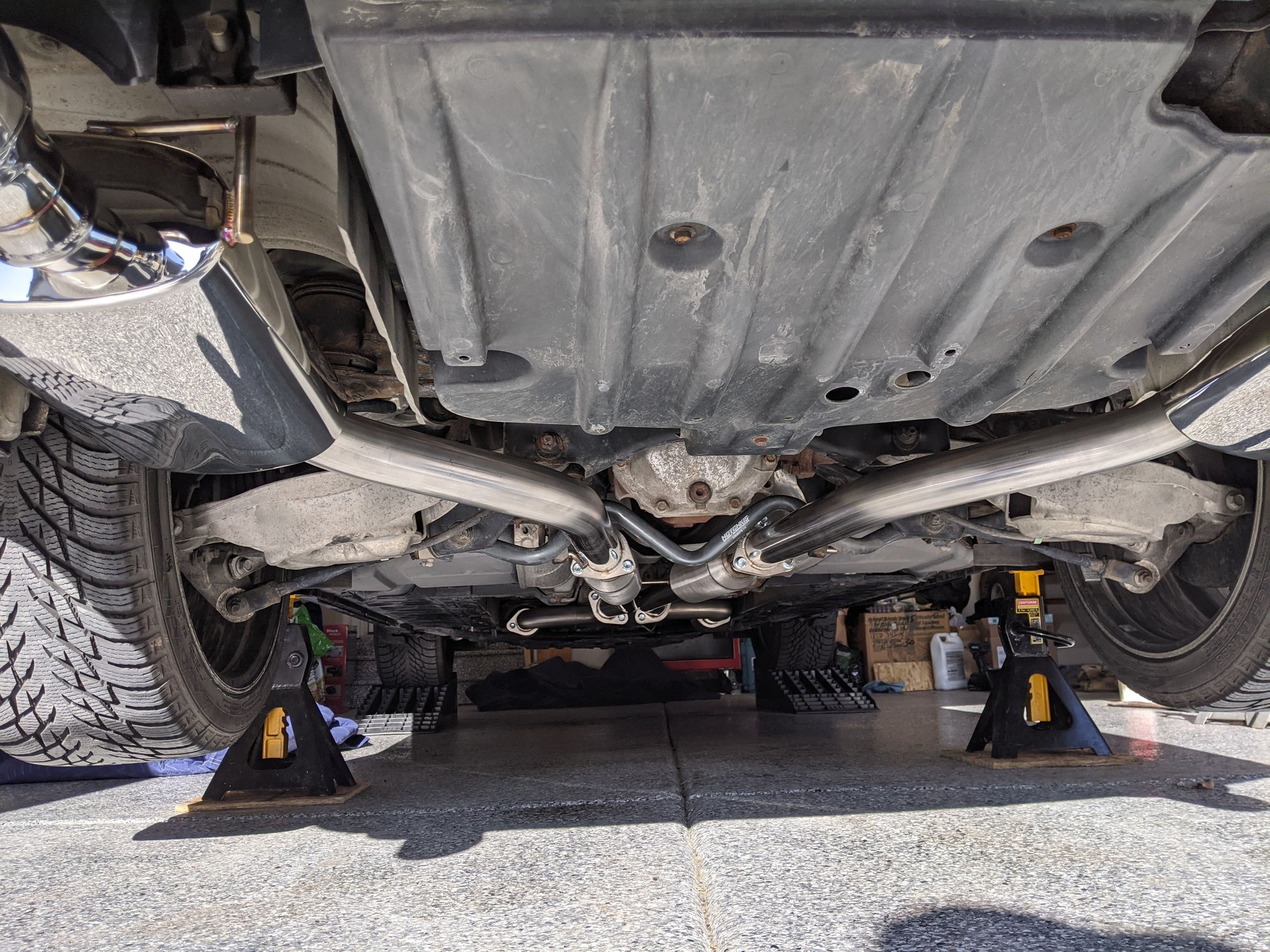

So swapped the exhaust out this weekend. Took a bit longer than I expected as the stock hardware had seen better days.
Can't tell the nut from the stud or flange
The exhaust sounds much deeper now. Not intrusive when cruising, you can hear it when under load and everyone can hear it when you foot it. Engine really seems to like it from 3500-7500.
