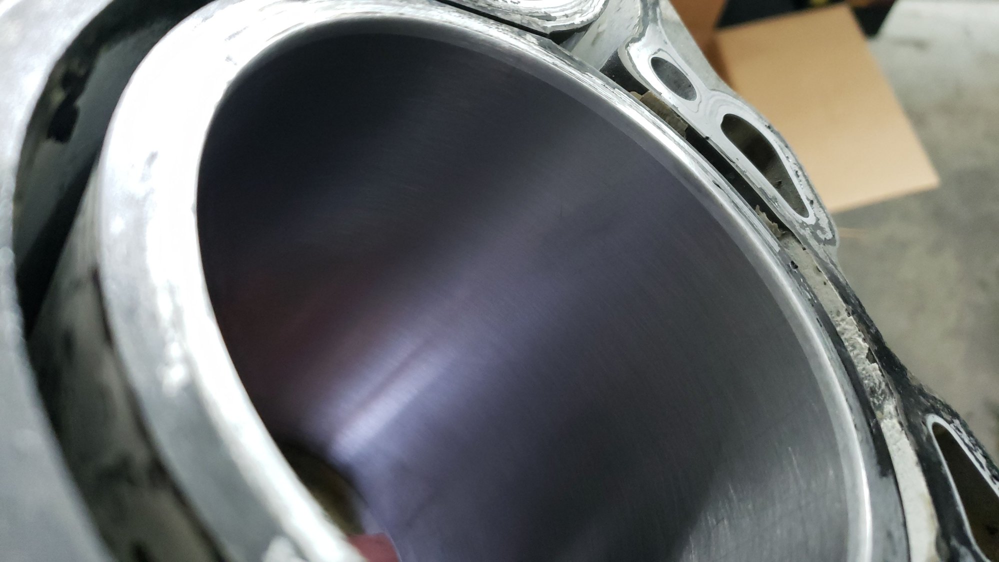

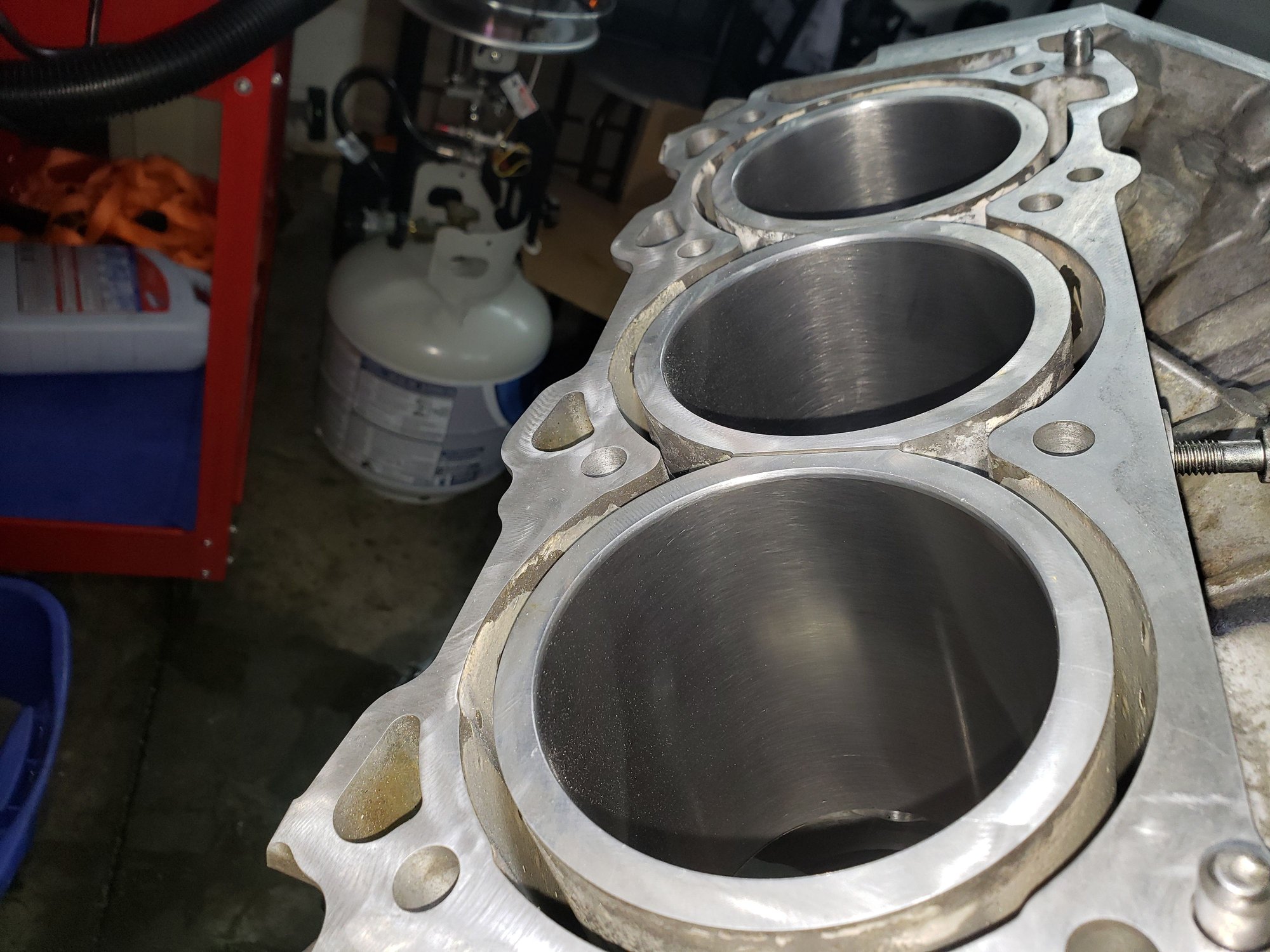

I am doing 100% of the work by myself and hope to finish in the spring. I currently have the subframe, engine and transmission out of the car. Block has been cleaned and honed and I'm getting ready to start on the short block.

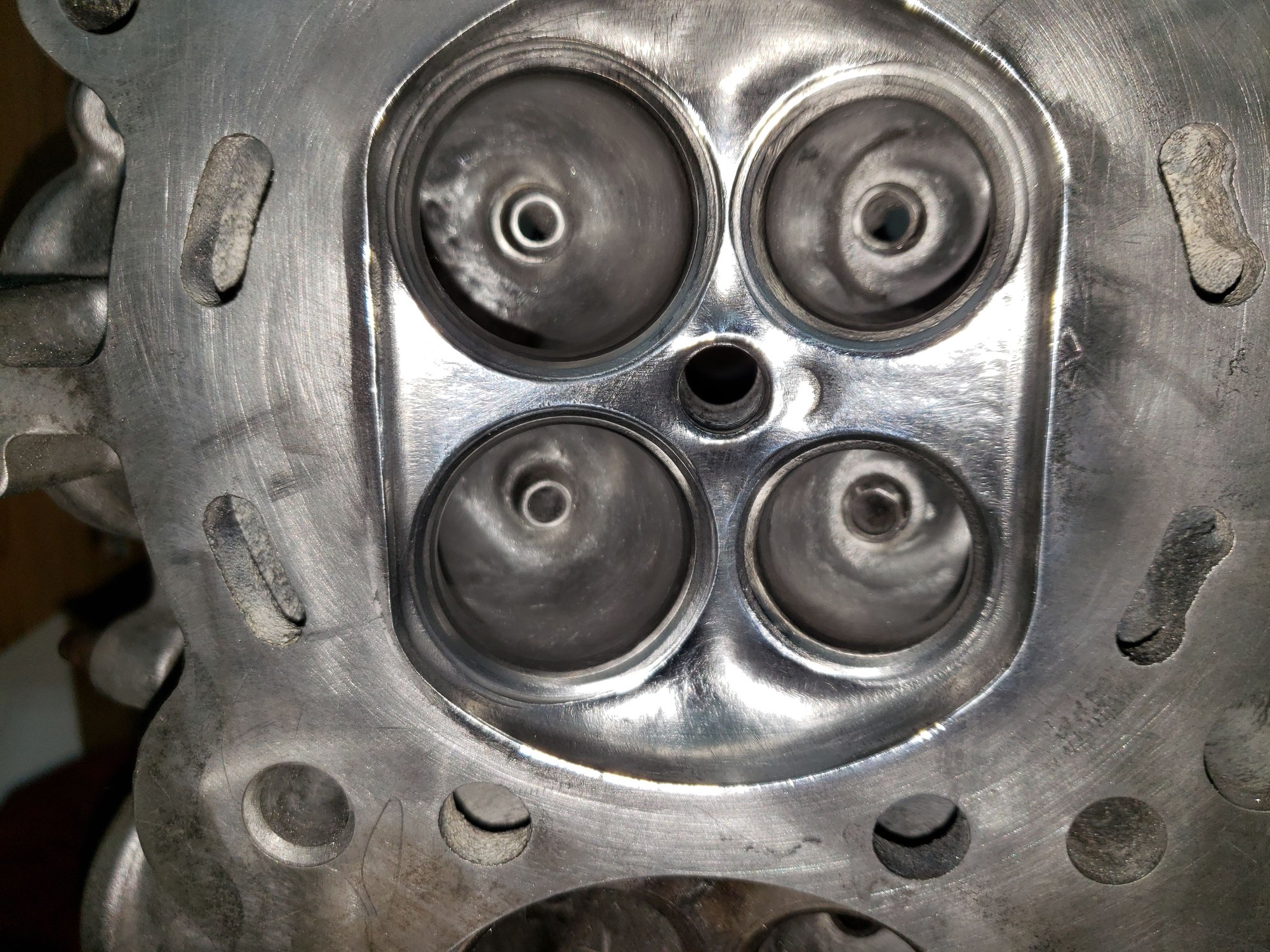

- Heads/Intake fully ported/polished

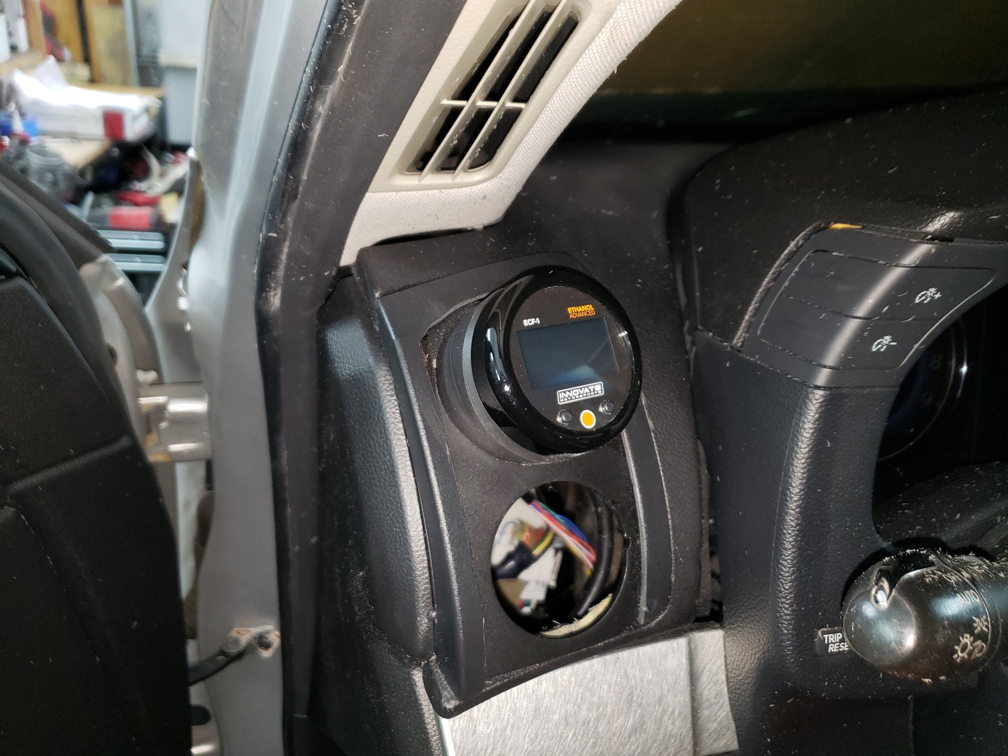

- 2 Innovate gauges installed in the driver side vent

Not bad for 180k miles

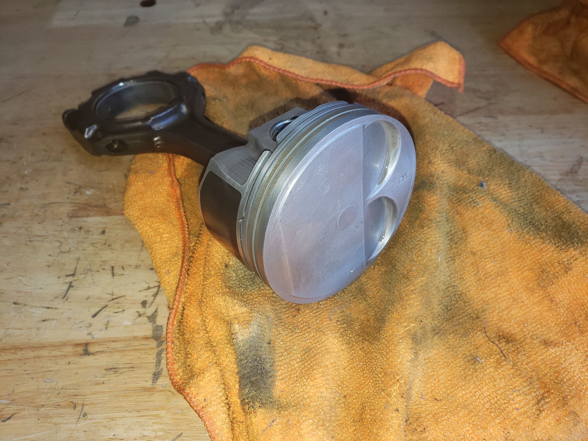

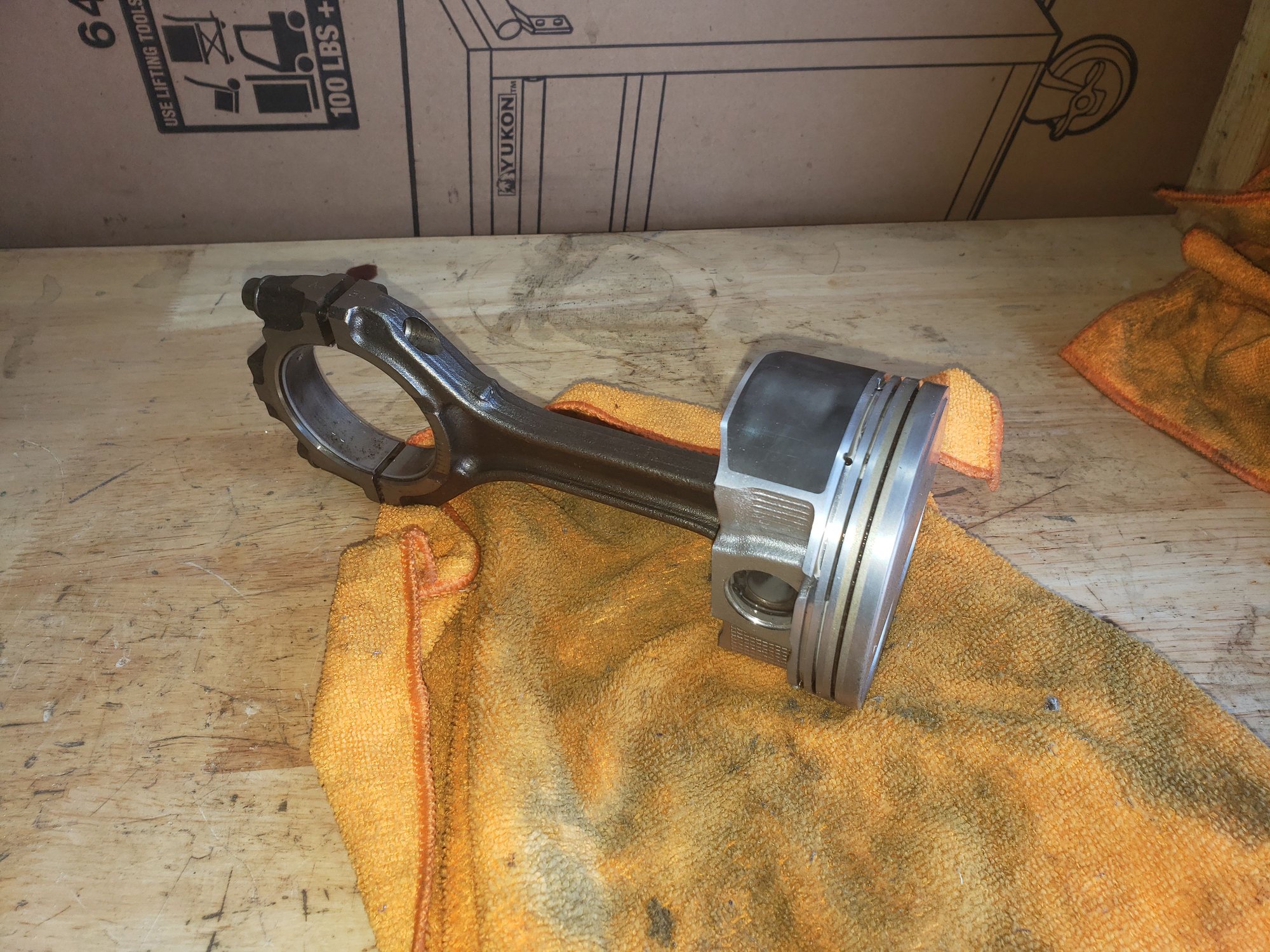

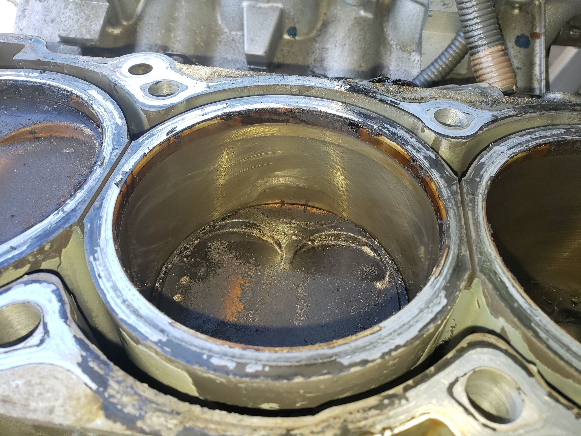

I cleaned one of these crusty pistons up, just to see.... Looks pretty good to me for 180k...lol
Thats what Im saying!
