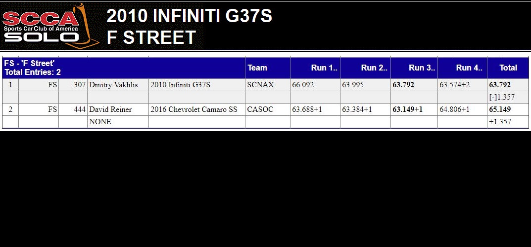

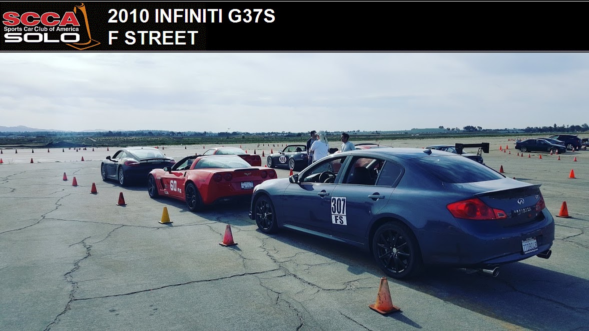

After missing a few rounds due to either being sick or away on vacation, I was finally back in action last weekend during Round 4 of SCCA SoCal regional championship. The field was much smaller than usual (100 cars instead of 150+), but I still had another car to compete in the class with me, which was a 2016 Camaro SS. I realistically know that at the moment I am not the pace setter, since this is just my second event, so if I were to win anything, this would be the best opportunity I would get all year. And that's exactly what I have done. My first class win.
