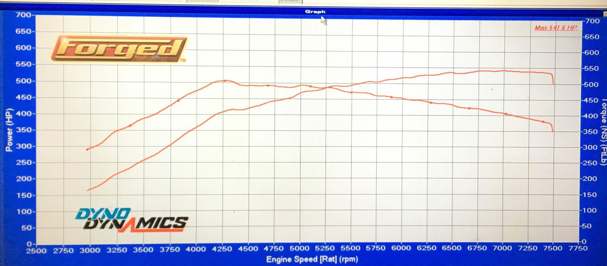

^ That's a whole lot of torque for 480whp! Have you monitored your fuel pressure up top? I can't imagine that you are running out of pump..
I think a general rule of thumb is keeping under 500wtq will help the longevity of the stock block. But, as always, every motor is different!

I'll have them check the fuel pressure since it has the mini fp gauge with the CJ return system. I would be baffled if it was a fueling issue with the 340 pump and S1 return system. Even more so since I have the 350Z pump module. I am just hoping he is mixing the torque and hp. There aren't any cars between the two forums that are making more torque than power. If it is the case that it is really running that much torque I may have to back off to waste gate pressure. I'll try to get a chart, but he is on vacation until Monday.

Come to think of it, I think I remember my tuner saying he tunes timing on a wave where it backs down timing as boost builds so that you don't get a lot of advanced timing as the engine is loaded on boost. I wonder if the timing at the top end is being kept low, hence the comparably low HP for the given torque. I will have to ask monday. Does anyone have an example of their timing table?

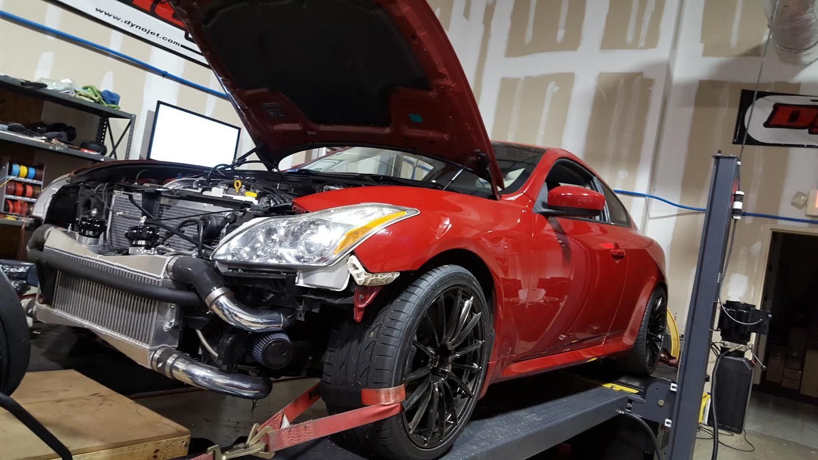

Finally got some pictures and wrapped up. I am headed to pick it up tomorrow! 513 WHP and 444 WTQ. About in line with where I expected it to be.

What octane were you running and what was the shop temperature
93 Octane here in Georgia. The high for the day was 61, so probably somewhere in the 50s. I asked my tuner to keep timing very conservative. Should have been low humidity as well.

Congrats! Looks like you did get a conservative tune and it should still be loads of fun! In for videos!
