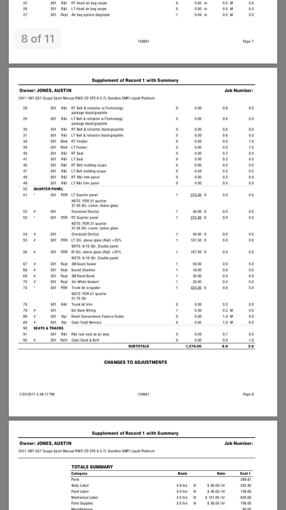

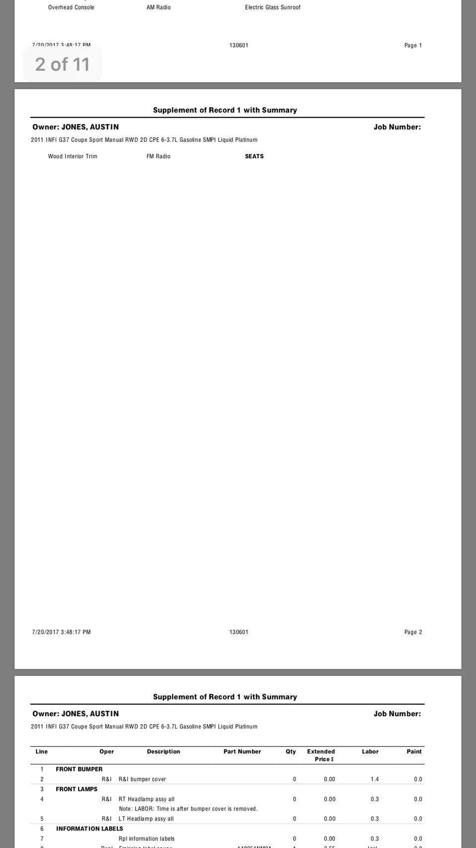

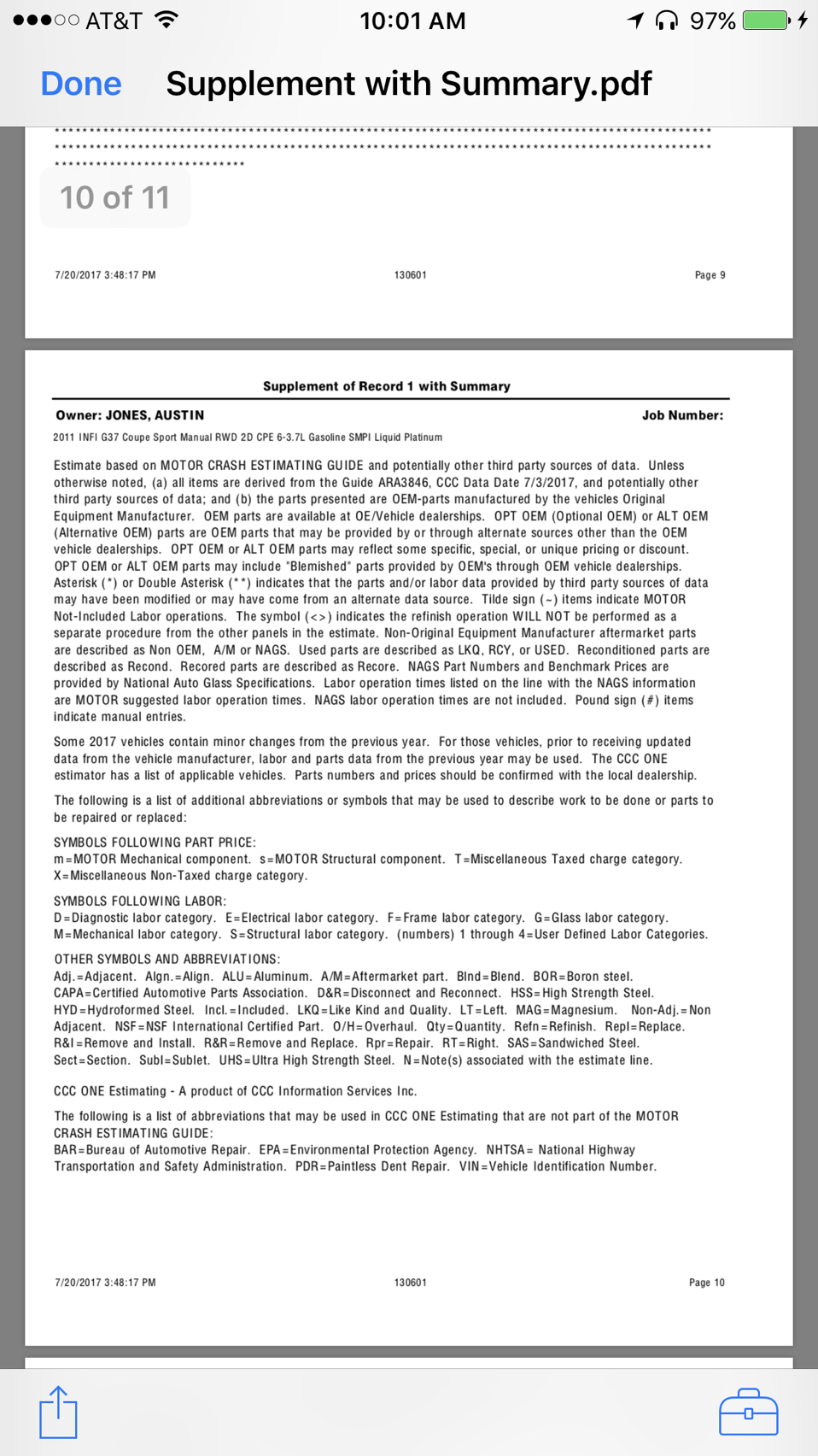

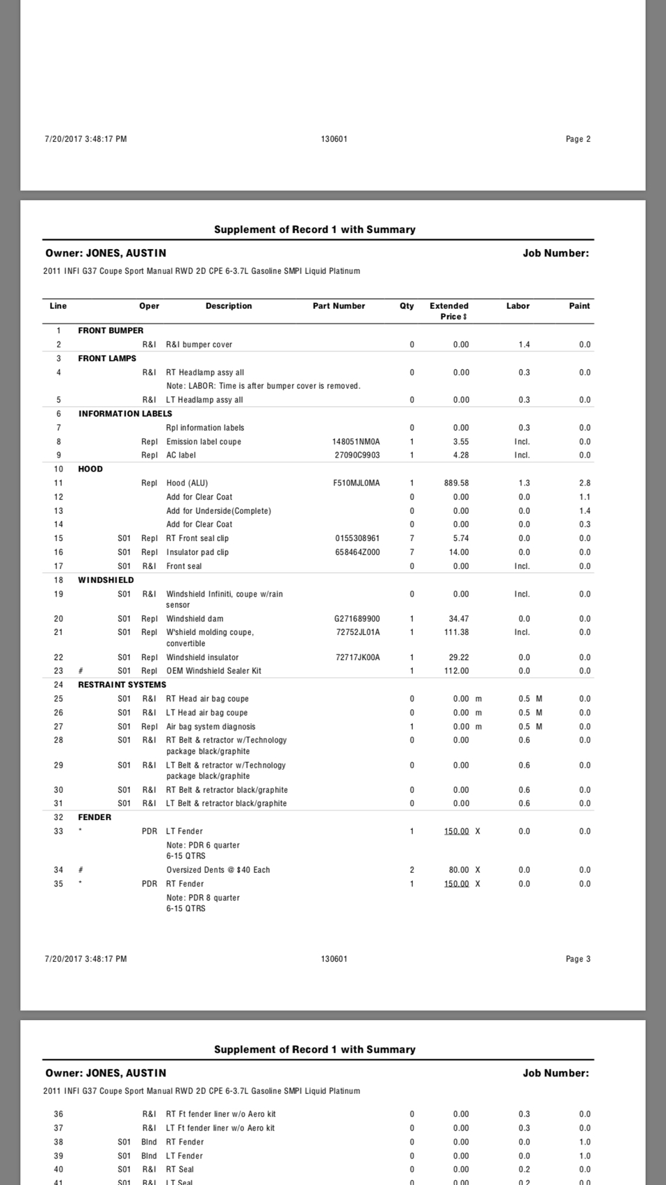

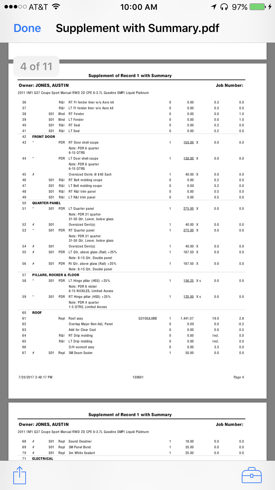

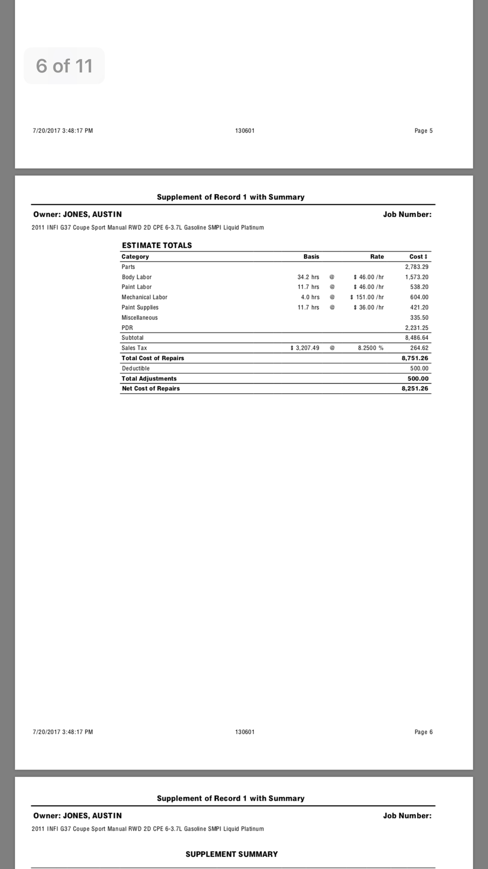

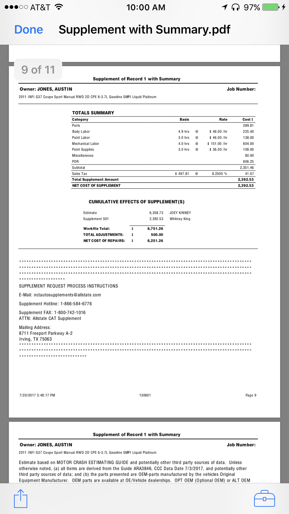

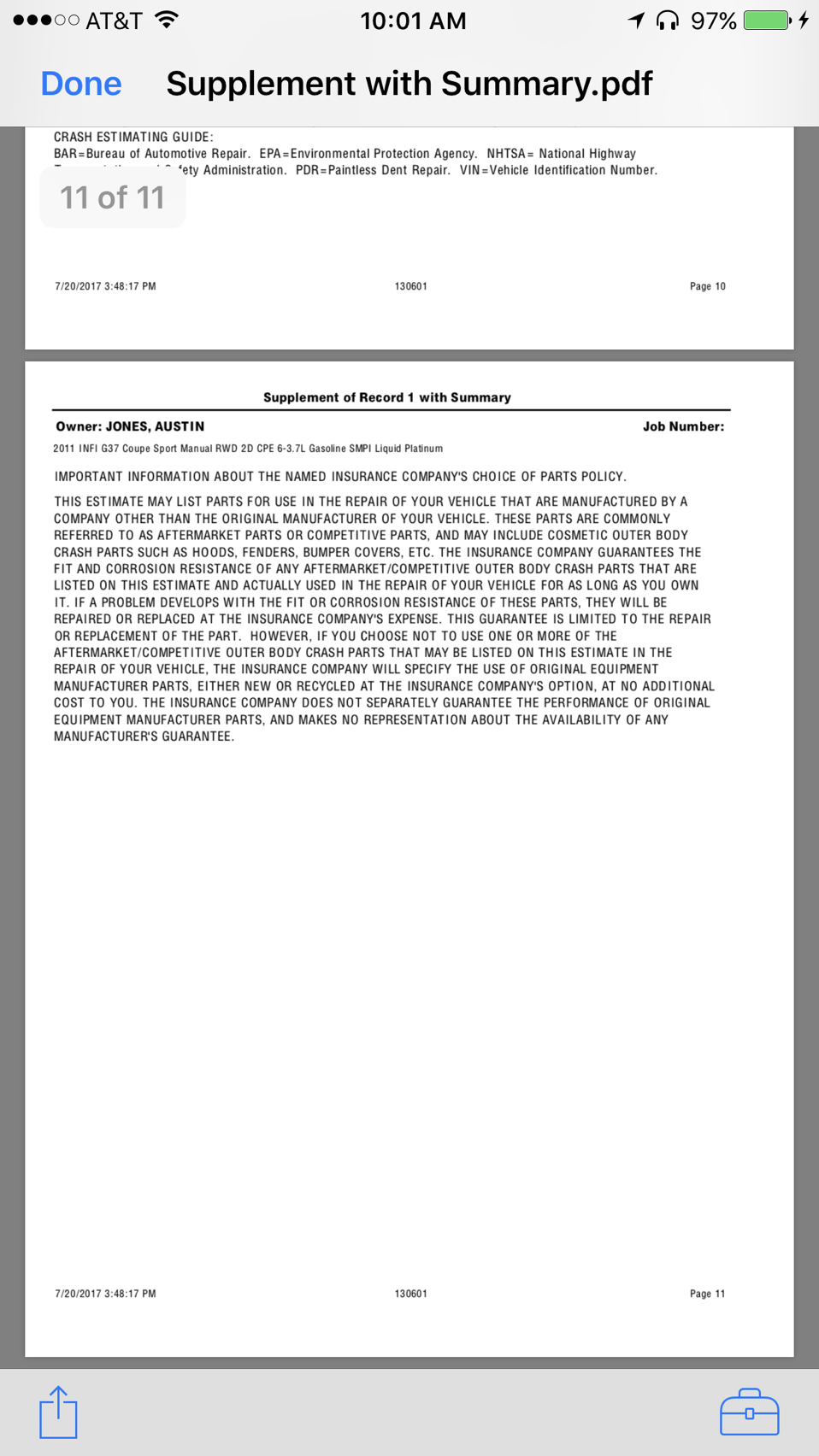

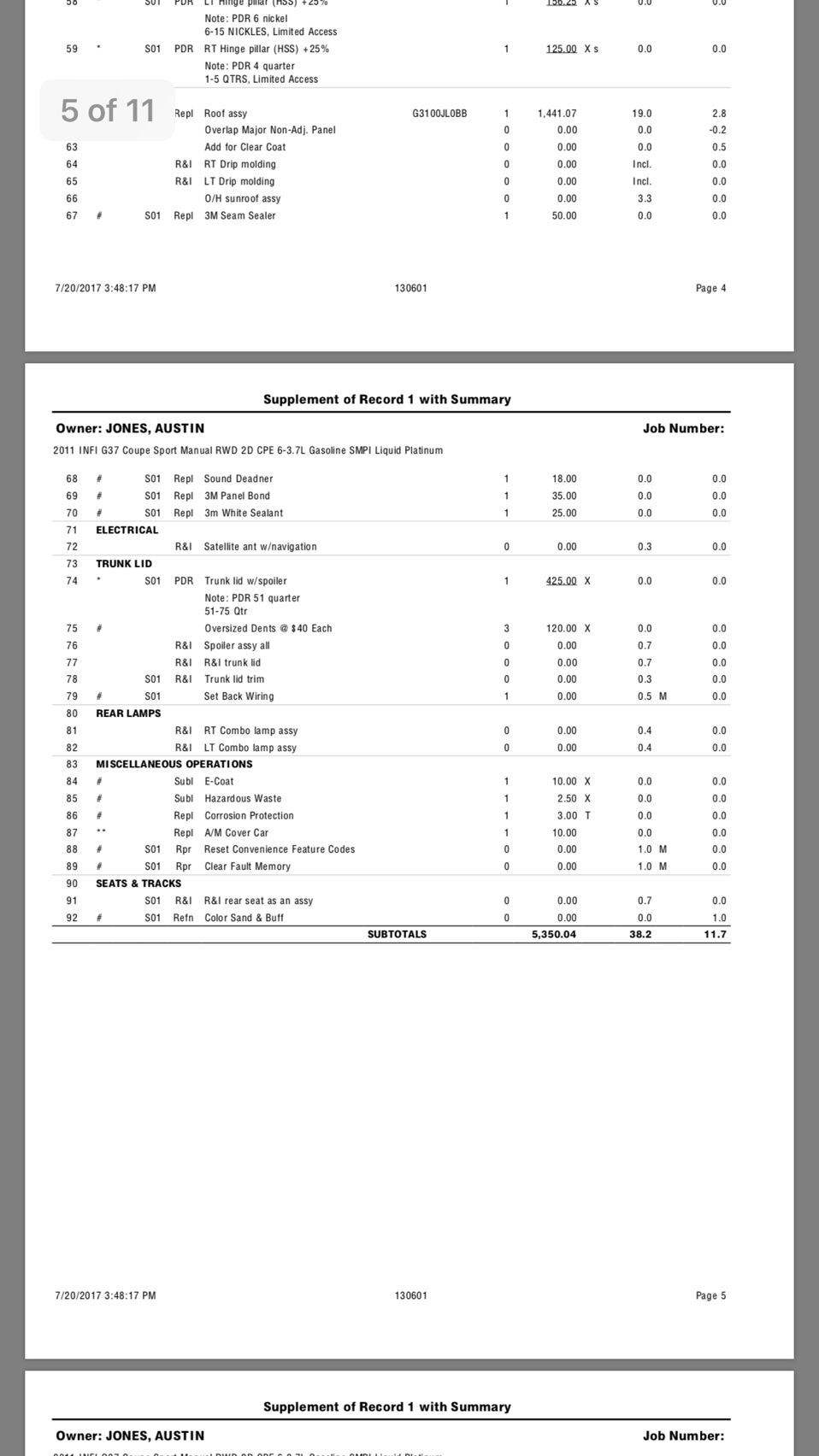

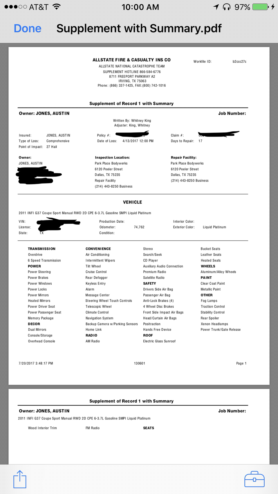

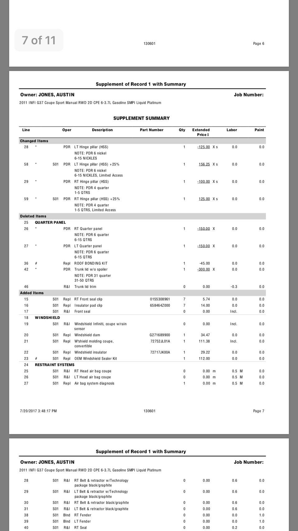

Finally getting my hail damage repaired. Attached is the paperwork from my insurance. Kinda surprised they didn't just total the car
Attached Thumbnails Jonesmeister's Build-photo519.jpg   Jonesmeister's Build-photo662.jpg   Jonesmeister's Build-photo915.jpg   Jonesmeister's Build-photo660.jpg   Jonesmeister's Build-photo765.jpg
Jonesmeister's Build-photo120.jpg   Jonesmeister's Build-photo899.jpg   Jonesmeister's Build-photo287.jpg   Jonesmeister's Build-photo302.jpg   Jonesmeister's Build-photo428.jpg

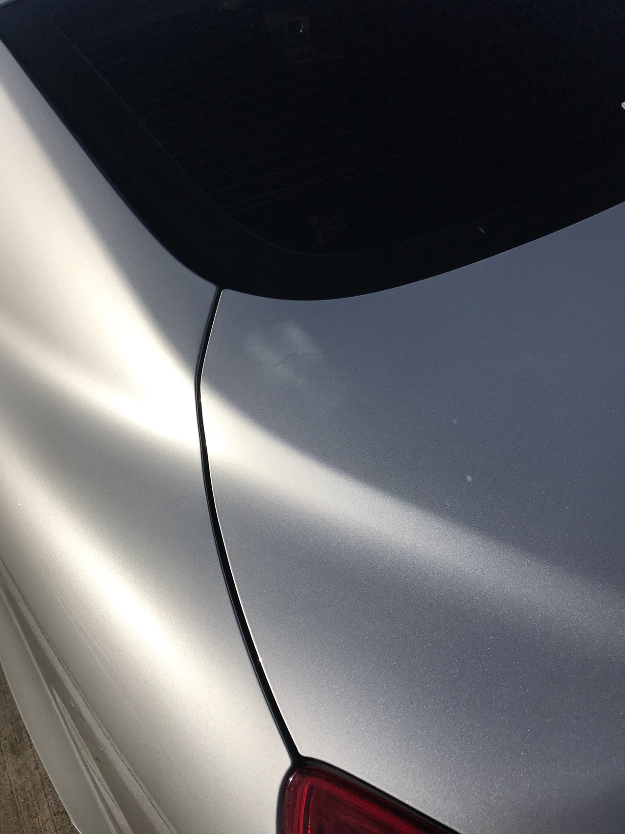

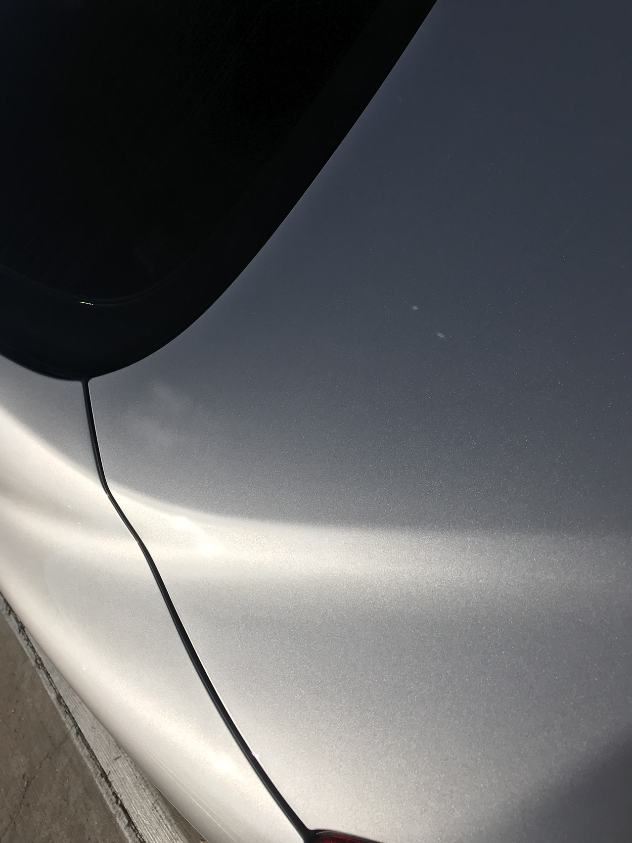

What confuses me, when they replaced the roof, trunk, and hood, they did not blend the paint to the rest of the body. For example, they replaced the roof, but did not blend the paint into the pillars, I know because I still have some chips that were there before.
