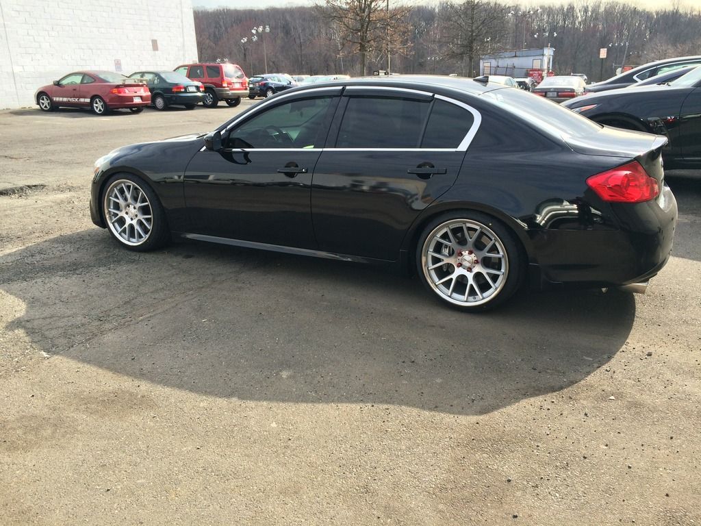

Another view of the car on the Tein Street Flex
Front Fenders: 25.75"
Rear Fenders: 26.25"

Now that's more like it
Nice job adjusting the drop, the slightly raked look is very good IMO.
BTW what wheel specs on your Vossens and what tires/sizes are you planning to run?

Thanks blnewt. I was recently thinking about lower the rear some more but my exhaust doesn't have much clearance from the ground. The wheel and tire specs are as follows:
Vossen CV2
20x9 +20
20x10.5 +45
Sumitomo HTR Z III
245/35/20
275/35/20

Nice, you won't need any spacers w/ that setup, although you might need to flat-roll the front fender edge, luckily that's simple and inexpensive.
