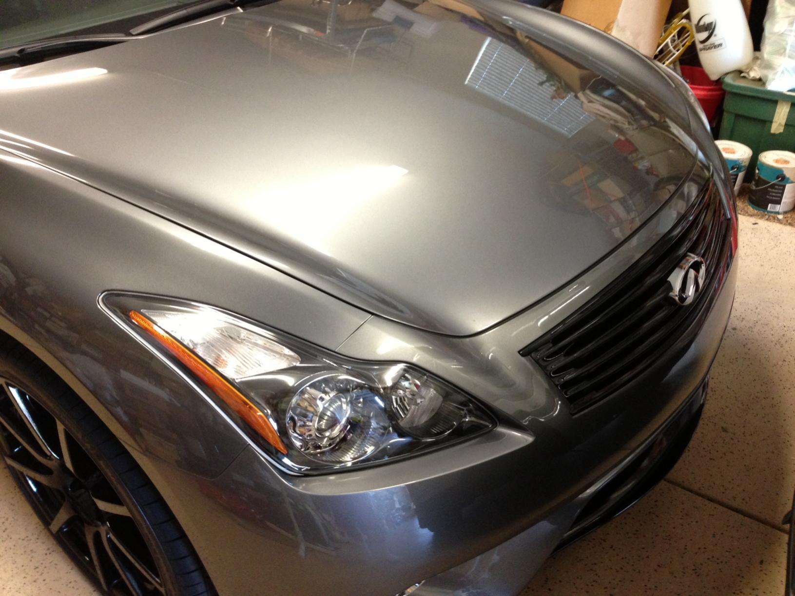

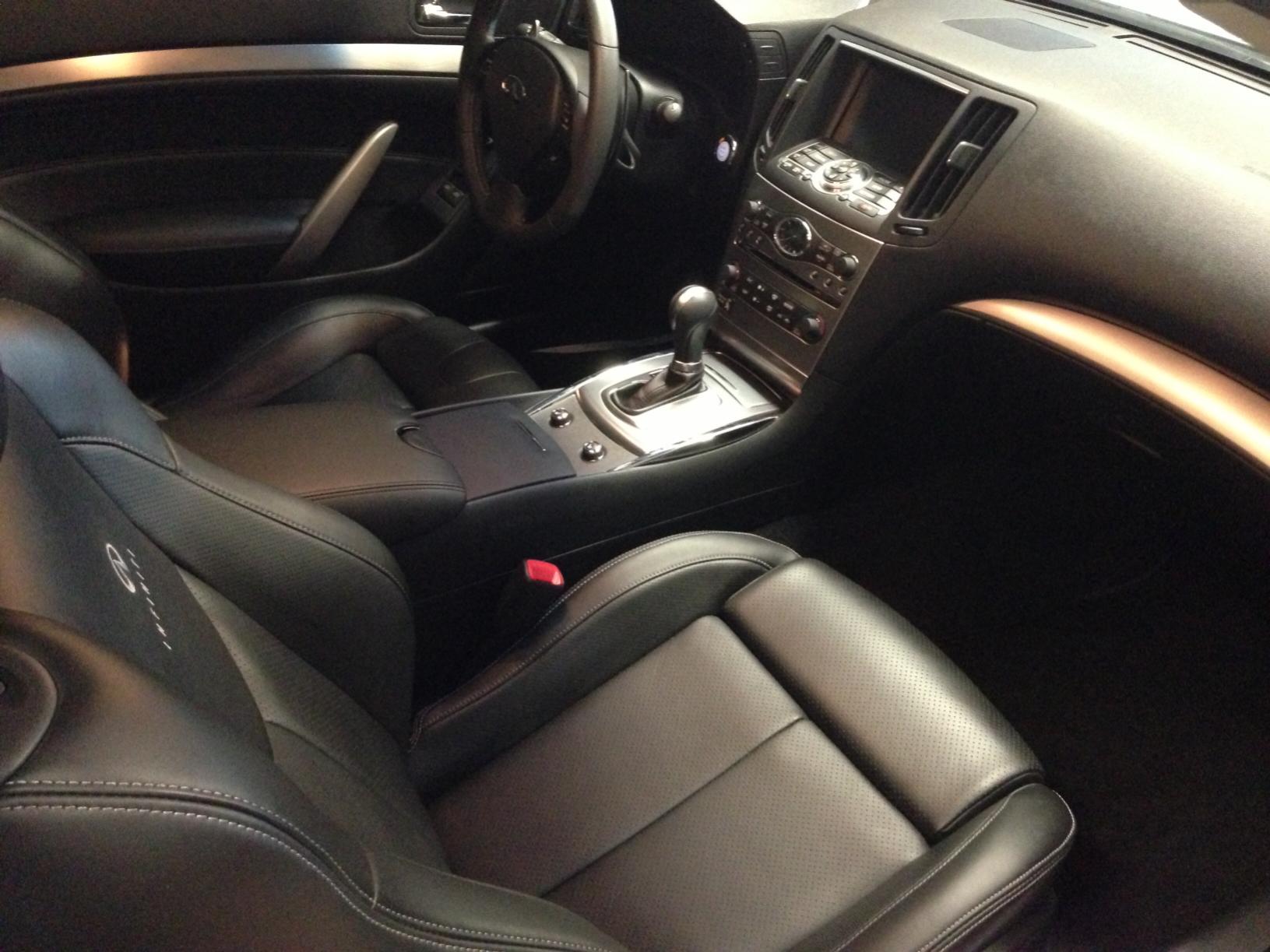

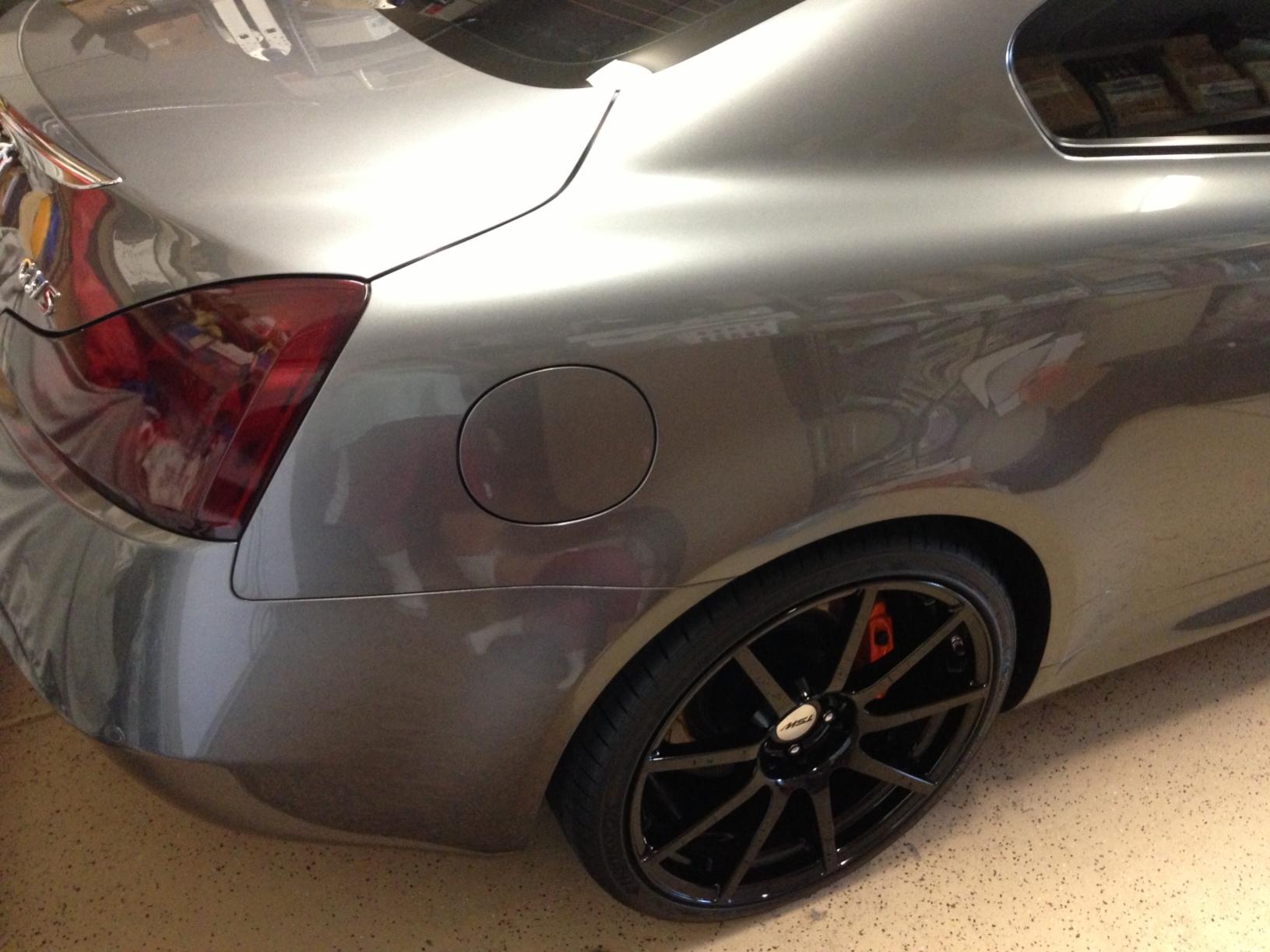

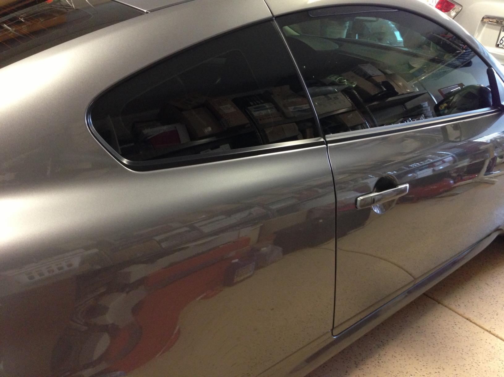

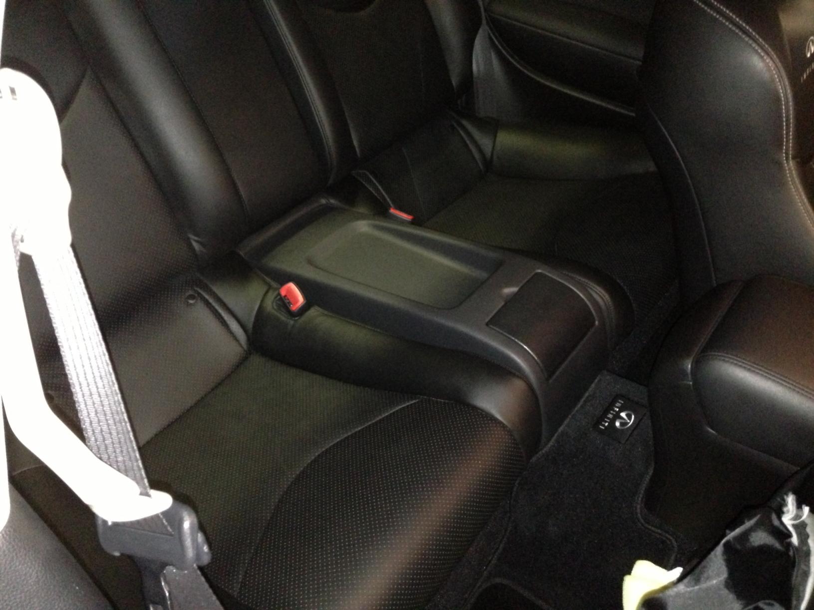

ok....so all the parts are finally here except my FI CBE. Next week or so I will be doing Swift springs and Whiteline sways and also having my brakes flushed and replacing with Motul RBF 600. I know I might need a camber kit once I add the springs, but I want to wait until the shop does the install and only buy what I need....hopefully rears at the most.
In the meantime I did a complete head to toe detail. This is one of my specialties and I pride myself in having the cleanest G around.
This included full clay bar using Pinnacle’s Ultra Poly Clay, and full polish with Menzerna SF 4500 - SuperFinish PO85RD. I used a Flex FLEX XC 3401 Orbital Polisher over the whole car except where the clear bra is. Those areas I did by hand, but they did get clayed, and polished just like the rest of the car. Then I used Wolfgang Deep Gloss Paint Sealant 3.0 and let it sit for a couple of hours. This product takes a full 12 hours to cure fully and the car cannot get wet while curing. I have been using the Menzerna and Wolfgang prducts for years and they really work well and my paint stays sealed for 6 moths and always feels like butter. I do wax once a month (sometimes more!)using either Wolfgang Füzion Estate Wax or Pinnacle Signature Series II Carnauba Paste Wax. I usually only do the Wolfgang wax every couple of months as that stuff was pricey....it is a great wax and has the Wolfgang paint sealer built into it. The Pinnacle is a rocking product as well. All of the products are non staining for rubber, and VOC friendly. So after the paint sealant cured over night, I did two coats of the Pinnacle Signature Series II Carnauba Paste Wax. This is a pure carnauba and can "stack" - Apply multiple coats for added depth. Waxes that have cleaners or polishes in them cannot stack.
The metal flake is really popping and the paint feels so smooth. Sweet.
The inside got a full detail as well with a nice carpet clean, leather scrub, and a protective wipe using Pinnacle products on the inside. Needless to say...the car looks and smells better than new.
I still have some additional sealing to do on the rims (already have two coats of wheel wax on them) and I also did a quick wipe on the engine.
If I do say so myself...she looks sweet.
If anyone has any questions on how to fix swirls, holograms, oxidation, etc...hit me up. Been doing this type of work for years and can give some tips on my techniques as well as recommend some good products.
Next update I will have pictures of Sophia on her new springs and stance.
