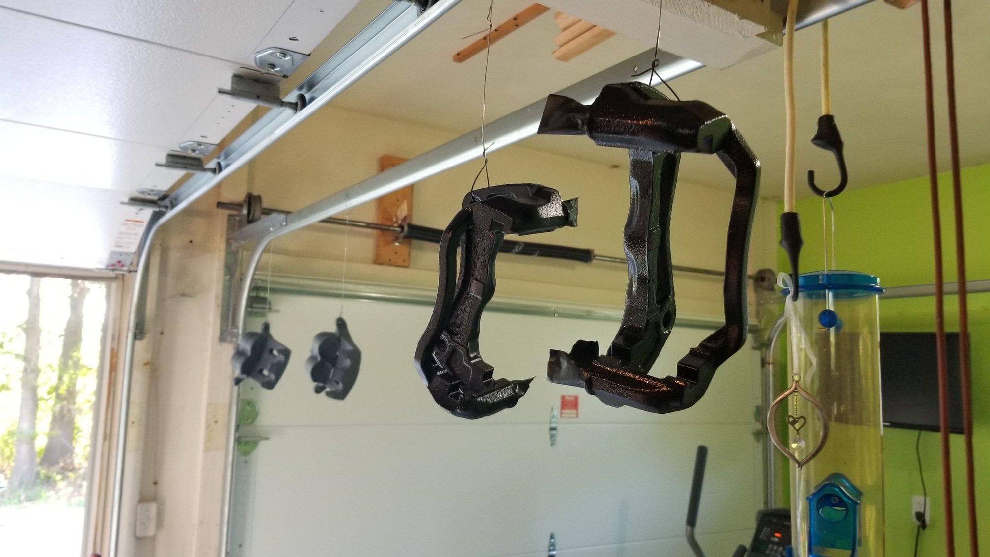

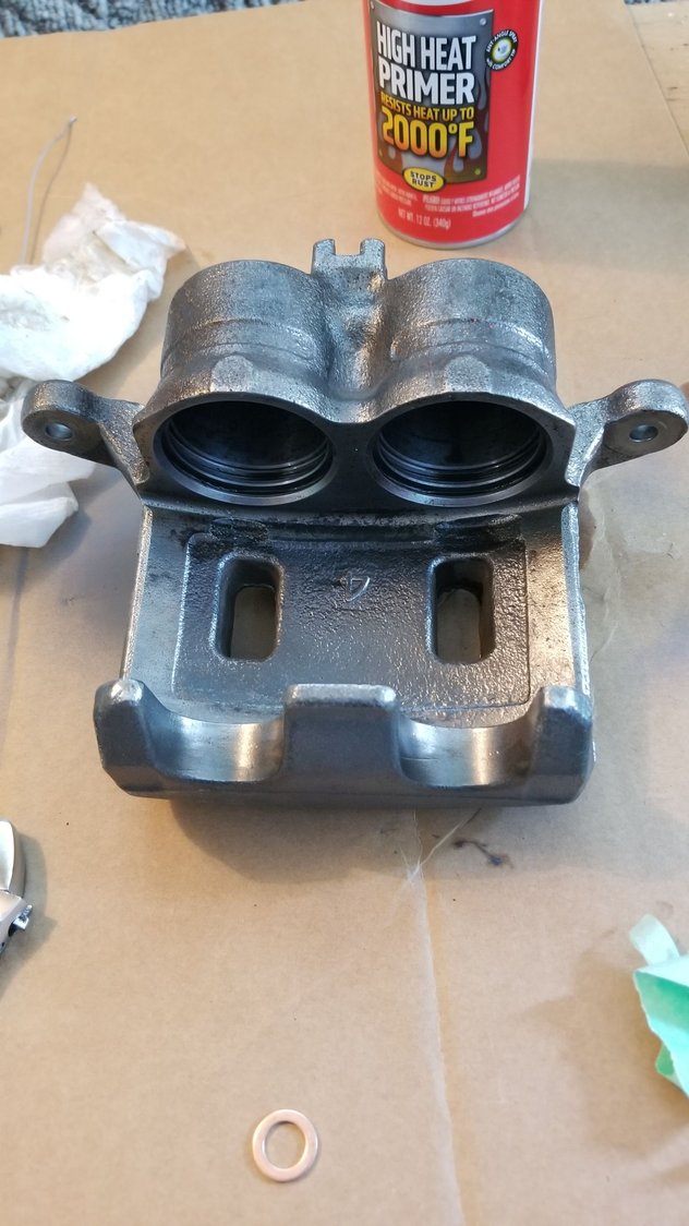

Ready to start painting...
Primed....
First coat of black...

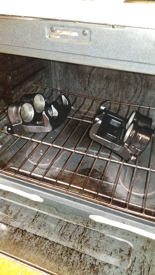

Fresh from the oven. I was hoping that if I left them in an extra hour, they might come out as Brembos.
