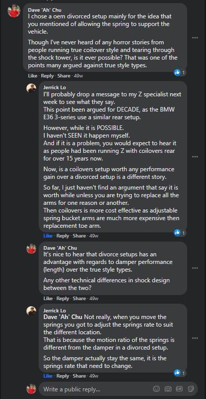

I'm doing some research for coilovers for a G37X sedan. Most of the aftermarket coilovers use a divorced setup in the rear with the spring and an adjustable perch with the damper separate like the stock setup. Some brands offer a true coilover in the rear which allows you to replace the lower control arm to one without a spring bucket to reduce some unsprung weight.
Is there a real benefit to either way over the other?

A lot of people say that the true setup should be fine. Like...they say the shock towers can handle the spring AND the shock....but..idk if they can. I think you may stand a chance of breaking a shock tower *maybe*.
I know the true coilover is easier to adjust also.
But...if it were me, I'd keep the spring where its supposed to be (divorced setup). Unless I had a *really* good reason for wanting to take a chance of ruining my car by breaking a shock tower.
I know some race teams convert 370Z's to true coilover. But...I don't think that's a comparable situation and I honestly can't see the advantage for a street car.

here is a bit more information i was able to get.
Jerrick Lo works at MeisterR.

Good info from the both of you. That makes me lean a bit more to the OEM setup......
