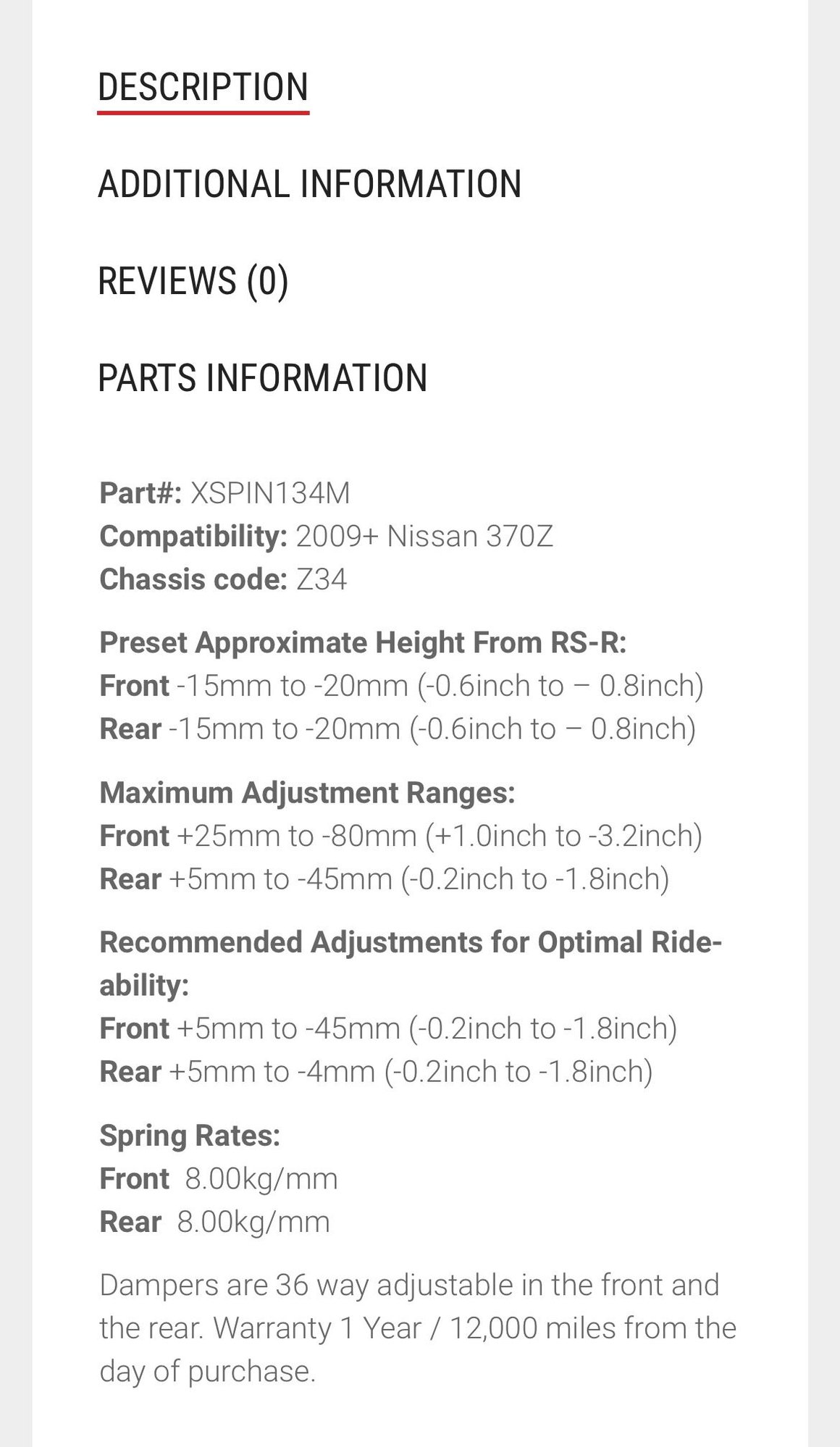

Sorry you had to learn the hard way man. In my research for coilovers I began to assume any coilover with the same part number for both the 370z and G37 will likely have “droopy bum syndrome”.
Most mainstream companies developed their coilovers for the 370z and just sell them for the G since they physically fit without a whole lot of extra, if any, R&D.
Rs-r Sports-I coilovers and Tanabe Comfort Rs are two that I’ve come across that do. Tanabe has separate part numbers and lowering specs for both the 370 and G37.
Rs-r goes even further and has different applications for the 370, G37 sedans, and g37 coupes.
While this doesn’t help now, hopefully it will for others that comb through threads for hours trying to make the best decision possible.

^WOW the RSR spring rates are soft!
