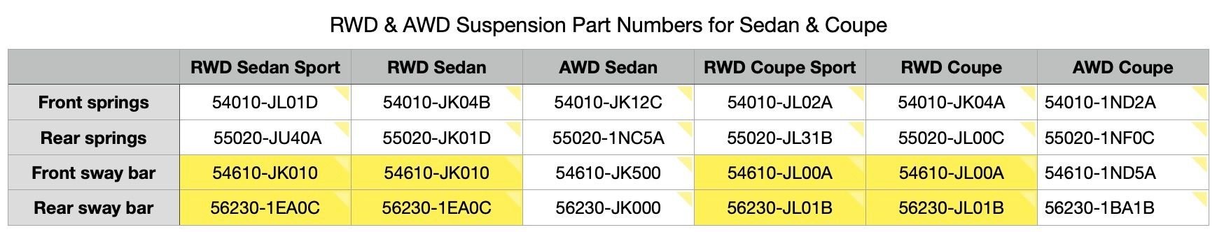

After saying the sport and non-sport G37's have different front springs, I wanted to double check and also look into sway bars.
After spending time *painfully* looking up 24 parts, here is what I found out:
• RWD Sedan: Sport and non-sport use the same front and rear away bars
• RWD Coupe: Sport and non-sport use the same front and rear away bars
• AWD:Coupe & Sedan use unique front and rear sway bars
Springs:
• Each variation have unique springs - nothing is shared between models
As mentioned, if you have AWD, any RWD front or rear sway bar would be thicker.
(assuming it physically fits, I know the rear does, not sure about the front sway bar)
If you have a RWD sport or non-sport model, and want a bigger sway bar, you will need to look at the aftermarket.
I hope this is helpful

Excellent research, Sonic! That's definitely good, miscellaneous info.
So the RWD sway bars are the same Sport/non-Sport, but the springs are different. Springs and shocks will certainly differentiate a RWD Journey from a RWD Sport Package (and 6MT).
I was 99.9% sure about the sway bars, but my comment on the springs was an assumption, not a fact.
Hmm. My OEM Sport Springs have been in the attic now forever. Maybe I should see about selling them?
Thanks, Rochester.
I did start to look into the shocks as well, but the number of combinations was getting too big for the time I had.
In a nutshell, every combination (sport, journey, AWD, RWD, coupe & sedan) seem to have unique part numbers.
I think the factory sport springs could be an affordable upgrade for non-sport models. Someone needs to try this!
