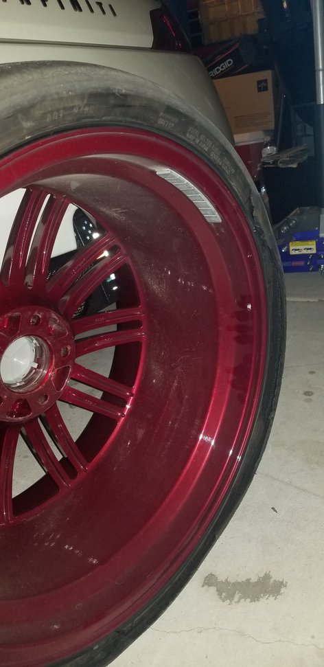

Need help trying to figure out my G blowing up tires like it's a joke. Normal driving and had no problems before. I run Falken FK510.
One day my rear passenger tire blew out on me. The area was the inside of tire full separation from sidewall. Cool no biggie, bought new tires, got it mounted and balanced. Also the next day took it to get aligned. 20 miles later driving down the interstate the same side blew the same way as the previous one.
After putting the spare tire and driving back those 20 miles to my house, i noticed the spare losing pressure and the inside warmer the the left side. I stopped multiple times to cool it down since i couldnt afford the spare to blow too. Idk if that is of importance but just throwing it out there just in case.
I am taking to alignment shop again this weekend to make sure.
Does anyone have any ideas why the same side keeps blowing? Thanks in advance.
The pics attached was the first tire, i forgot to take a pic of the new one that blew a few days ago but pretty much looks the same.

Alignment. Accident. Something not right. Need to visually inspect. We can only guess from here.

From the pictures it looks like something is rubbing. The sidewall looks like it got so hot that it melted and caught on something.
