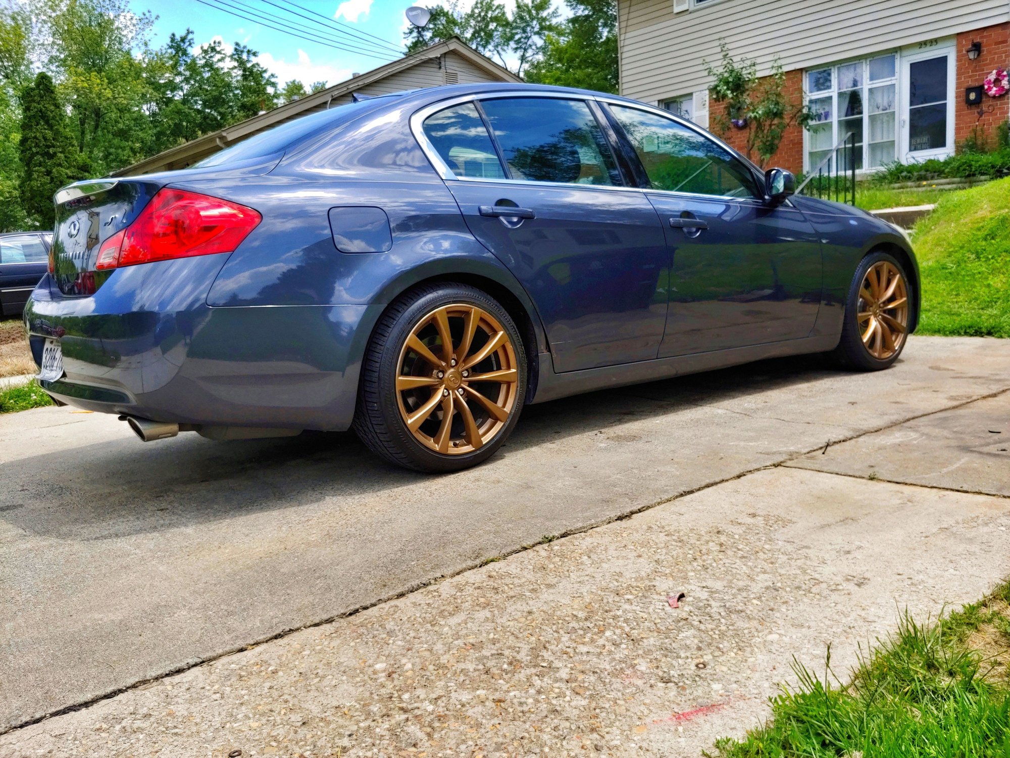

OldG2NewG's Avatar
OldG2NewG
Joined: Mar 2019
Posts: 311
Likes: 76
Swifts and kyb is your best bet if your looking to keep a bit of comfort. I currently run the setup and it's very close to stock comfort wise.
Here's a couple pics of the ride height
