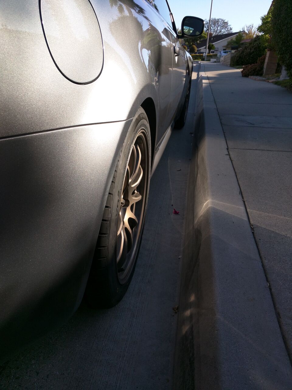

If you have the Akebonos, I would check brake clearance before you commit. Other than that, it'll be fine. At stock ride height, it'll look fine, but will tuck quite a bit if lowered.
This is an 18x9.5 +38 with a 265/40R18 on my coupe, which is conservatively lowered.

I believe the PF01 fits as I've seen them on Gs. Check for Akebono clearance just to be sure.
