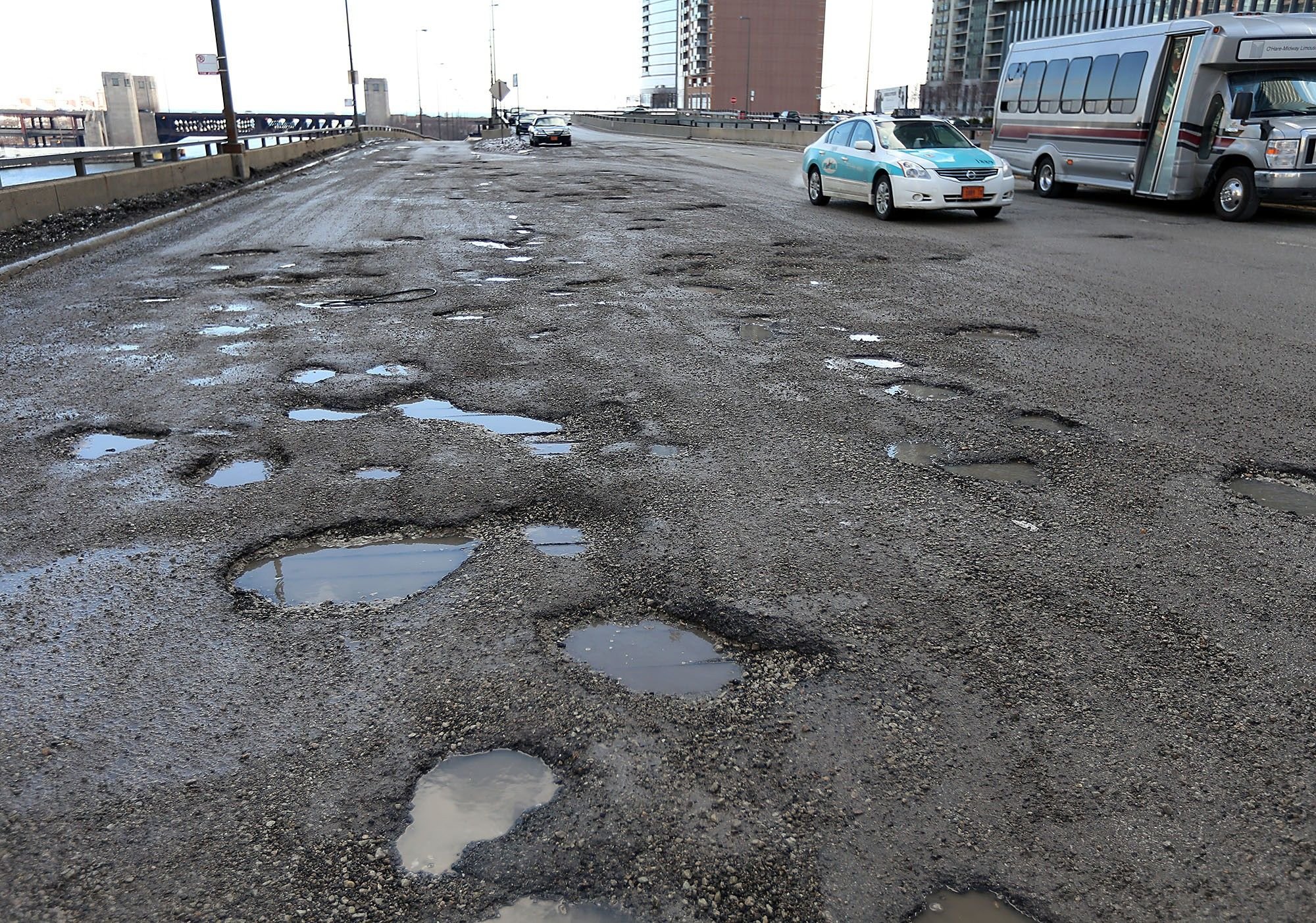

The roads here are incredibly crummy. Potholes, cracks, patches- it's horrible. Any kind of real performance tire, or low-profile tires, tends to rattle your teeth loose on these roads.
Actual Chicago road - Wacker Drive, downtown
