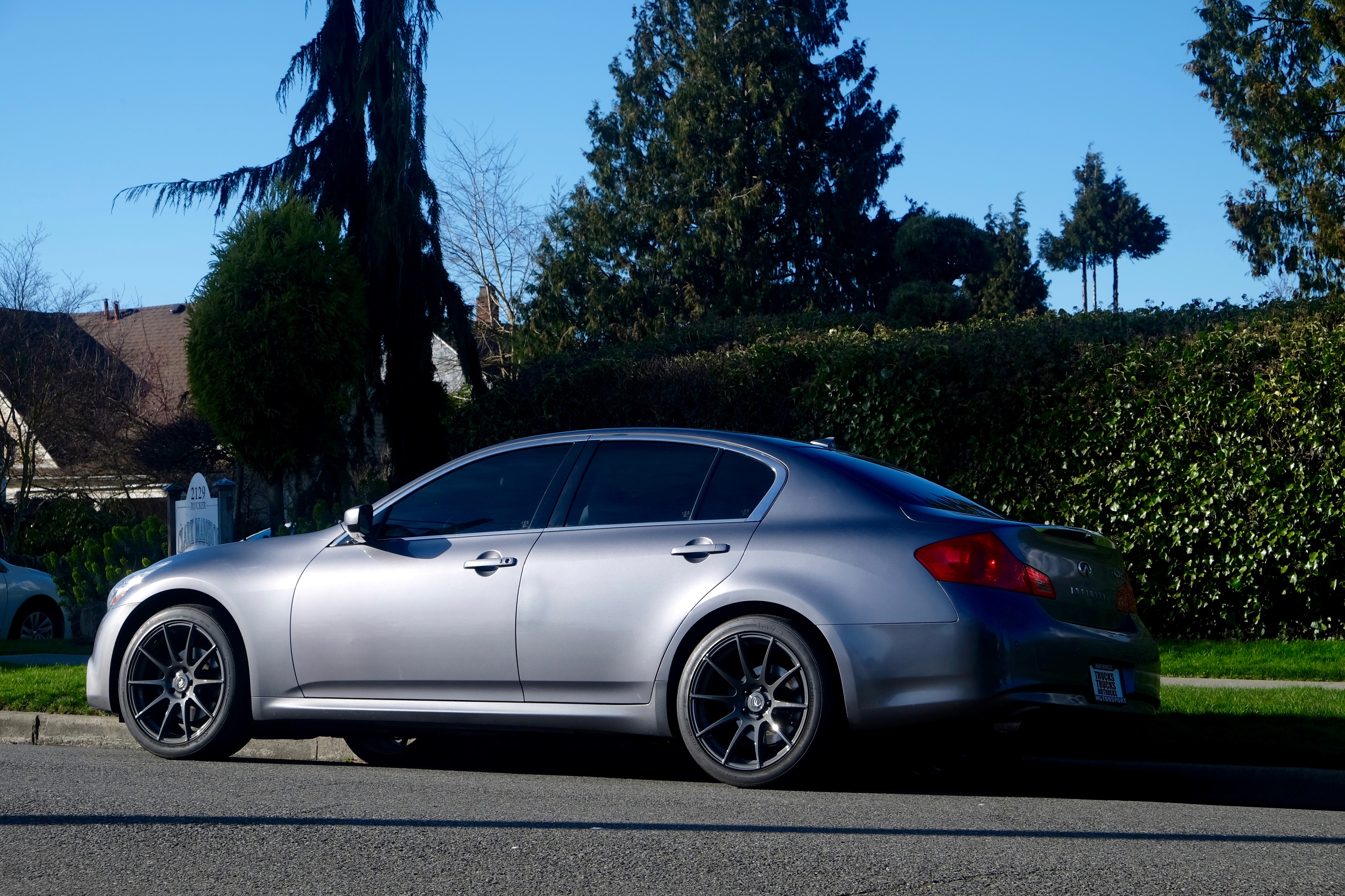

If you're planning on lowering enough to completely get rid of the wheel gap, I'd suggest something a little wider. 8.5 +35 will be slightly on the tucked side when lowered. I have zero wheel gap and I'm running 19x9.5 +35 all around on 245/40/19 tires. I think what I have is what you're looking for. It's flush but not sticking out or rubbing. (I actually have a little extra room to add maybe a 5mm spacer) I've got a bunch more pictures on my Instagram.

Thanks for chiming in. Yes, your setup is what I'm looking for based on the pic.

When you lower your car, the wheels will tuck into the fenders naturally. I believe the car in the pictures is on stock height, so that's why it sticks out. You can see how in my picture, the wheels are not sticking out, and my wheels have 5mm less offset.

Here's a couple shots of my 18x9.5 +38s on 245 width tires, your 10" +40s will be about 4mm further out than mine and for a 10" width you'd want to run a 255/40/19 minimum width, so your tire edge will be an additional 5mm out (which won't be a problem as it will tuck.

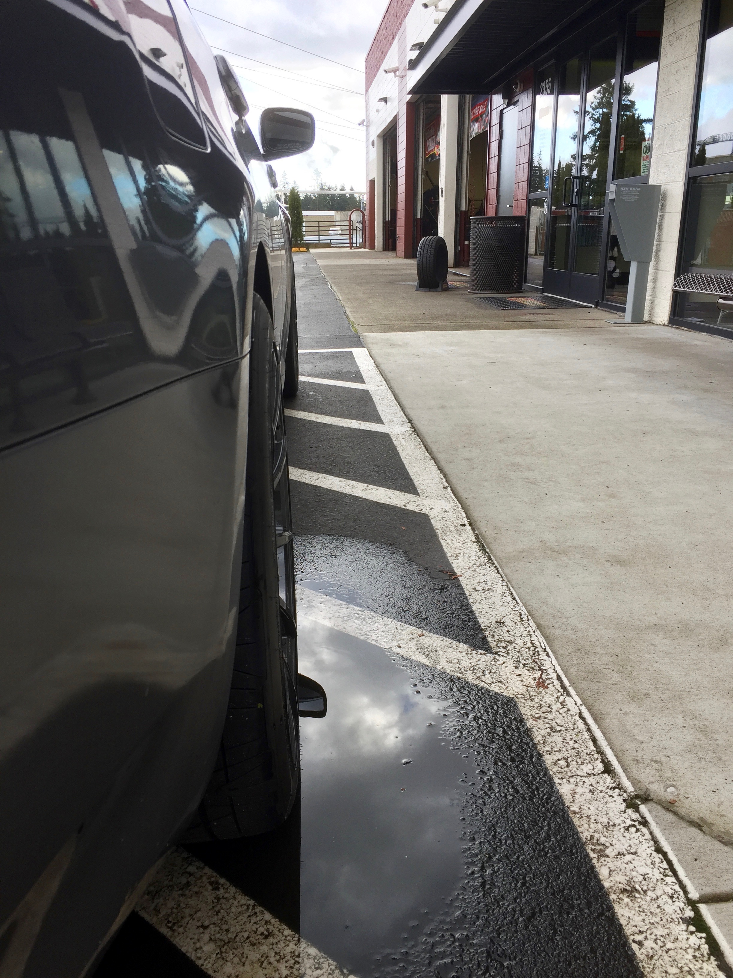

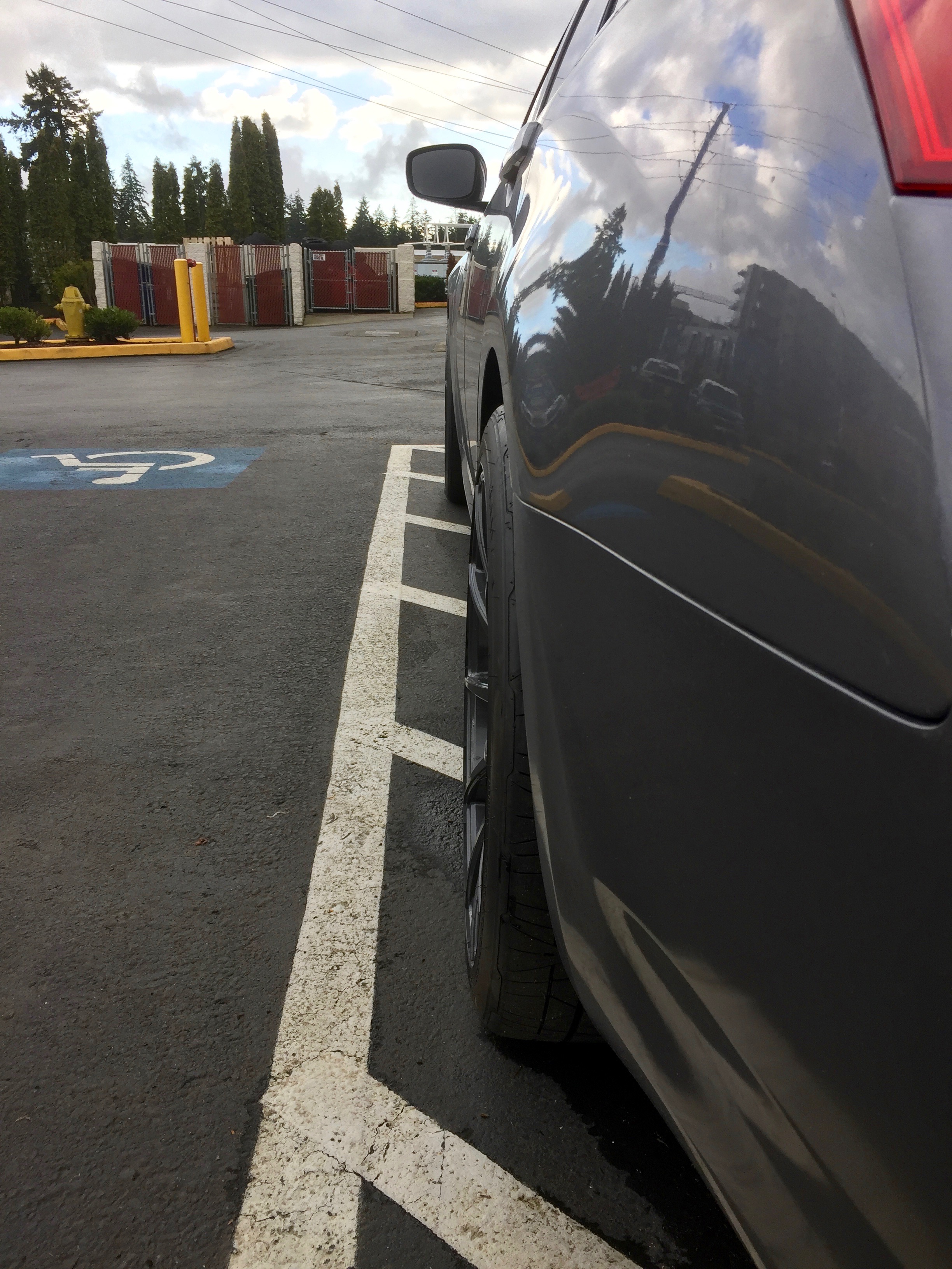

I own a G37X model Sedan. My Stance XR1 coilover's w/ r/camber kit finally arrive this week. Once the parts are installed does the input of this thread suggest I have a chance of gaining some noticeable tuck of my wheels/tires? That would be a welcome.
My wheels/tires are f/19x9 +35 245/40 r/19x10 +41 275/35 - Thank you.

Once you lower the car your wheels will tuck in naturally from the drop. It should be a better fit once you get it lowered.
