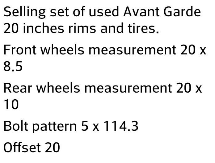

Found this deal on eBay. Think it's a pretty good deal? Tread is about 75%. Would these specs fit a 2010 g37s coupe?

Should fit. Depending on the center bore of the wheel you may need hub ring adapters.

Looks like that 3rd wheel is pretty rashed-up, if you don't mind getting that one cleaned up it sounds like a decent deal. A 10+20 is pretty aggressive if you plan to run tires wider than 255s, hard to tell what's on there, did he list the tire sizes anywhere?

The third one would definitely need some repair. It does have some pretty good rash in it. They have 245 up front and 275 in the rear. I've looked on here at the "fat tires" section and I couldn't find anyone running that amount of offset with those tire sizes. The deals not that great if I have to get different tires and fix the rash.

it's not that great

Thank you all for the input. I've decided to pass on it. Think I'll just wait a little longer and buy new. That way I know they'll fit.
